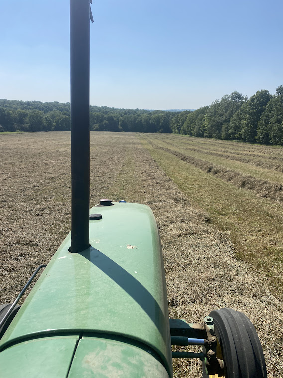

Knocked down another field of first. This is our first time doing this field. Received it last fall and brush hogged it. Sprayed most of it this spring for weeds and it got so late we were just going to brush hog it but a friend needs some feed and is taking it. The layout of the field is nice and once we can put some money into it will make a very nice field minus the woodchuck holes. The spray made a big difference, where I ran out there was a lot more crap specifically goldenrod. And since we were talking horsenettle. There was a sea of it in sections. Some of the worst I have seen in a long time. I'm hoping to do a fall spray to knock the weeds back some more. Going to take a few years but this field has potential for hay for sale. In the meantime the plan is baleage.
Irritated I only took one photo.

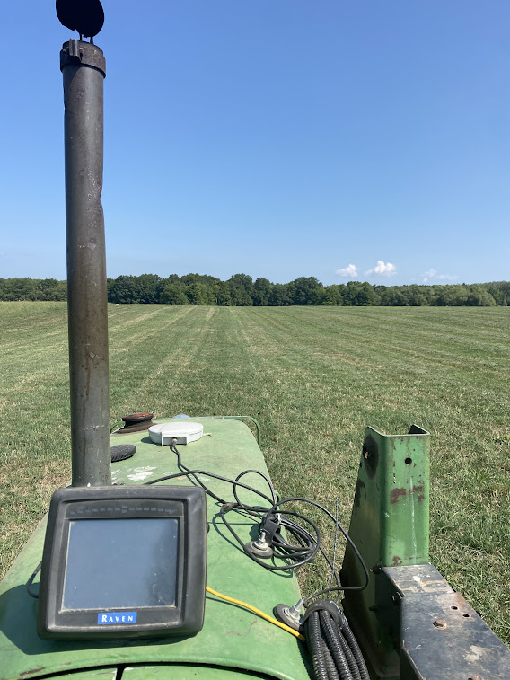

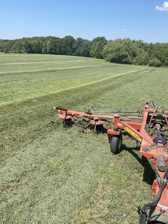

And doing another run of 2nd. 25 acres down and hopefully get 300 small square bales. Pathetic. Also short on drivers and should be doing all 50 acres but so much raking and tedding with the baling is a lot of ground for wife and I. Keep hoping they take the rain out of Sunday and we would lay the rest down. But I should not be thinking like that either. We are DRY. May and June we could not work and fields were saturated. Over 11 inches of rain. July to today we have only received 2.66 in basically 2 separate rain events. Luckily I fertilized during both of them but still limited growth.
Poor picture taking. Before tedding I raked every 6 windrows toward the center. At least then it looked like I was doing something.

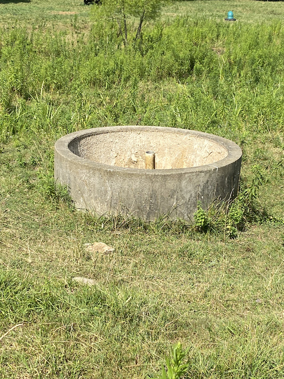

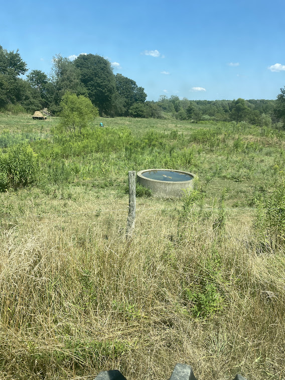

Usually you can watch it fill. Think it took a week to fill. At least shows there is still moisture deep. down.
