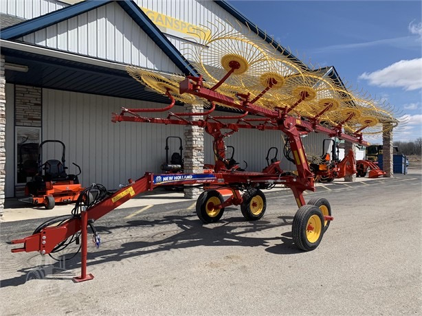

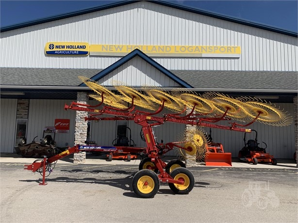

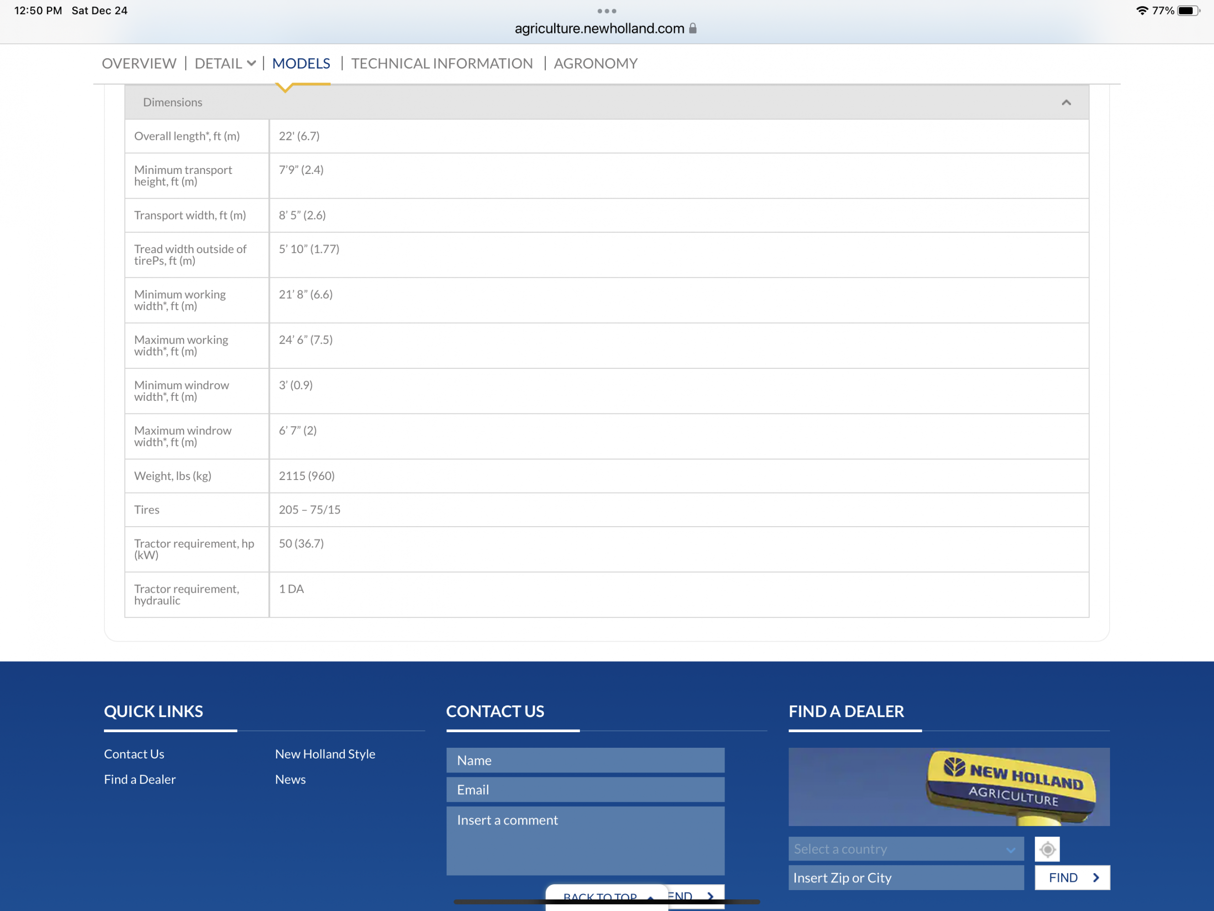

Yes, changing the windrow width on that rake does change the raking width. There is a pair of hydraulic cylinders just behind the lift arm that changes the wing angle to narrow or widen the windrow, and they move the other end of the wing in the opposite direction due to how the wings pivot on the lift arm, and you do this with the rake moving if it has the hydraulics on it (the one below does, I can see them.) The raking width can change by several feet, and depending on your mower and swath widths, it may be no big deal or you may miss hay or catch part of your previously-raked windrow.
I've run the 10-wheel version of that rake (1022) with the regular single-wheel axles and no kicker wheel. It was a pretty solid rake, much nicer than the Kuhn wheel rake that was used prior. It worked well raking in front of a round baler with a wide pickup. I did not like to use it to rake in front of a small square baler as it would plug up in a decent stand of hay when the windrow was set narrow enough for the baler's pickup and it was being used in the normal fashion to pull two swaths into one windrow. You can lock either one of the wings up so you can just use the other wing, although it requires you to dismount the tractor and flip a valve on the rake to disconnect the one wing from the hydraulic lift circuit.
I was going to opt for the 1225 Procart mostly for the double wheels and somewhat for the larger size. I have some bumpy and challenging fields and thought it might be more rugged or hold up longer.
I think you have the single axle version? Are your fields bumpy? Does your single axle seem like it’ll hold up well?
Thanks for chipping into the discussion!
/ Haying changes next year ? #22
Yes, the 1022 is the single-axle version. That size was selected as it will pick up exactly two swaths from a 10'-10 1/2' cutter which is what we use. The fields are somewhat bumpy, generally I can't go faster than about 5-6 MPH when cutting. This rake seems pretty solid, we've had it about 10 years if I remember correctly and all we've had to do is grease it. It certainly is a lot stouter than the Kuhn rake we had before, that bent and broke after one season and got traded in on the New Holland. The only really bad thing I can say about the rake is that it is not a great rake for making a windrow much narrower than about 5 1/2' wide in a thick stand of grass hay, it will plug up. I wouldn't recommend using this to rake in front of a narrow pickup 4' wide round baler or most small square balers but it does great in front of your typical wide pickup round baler.

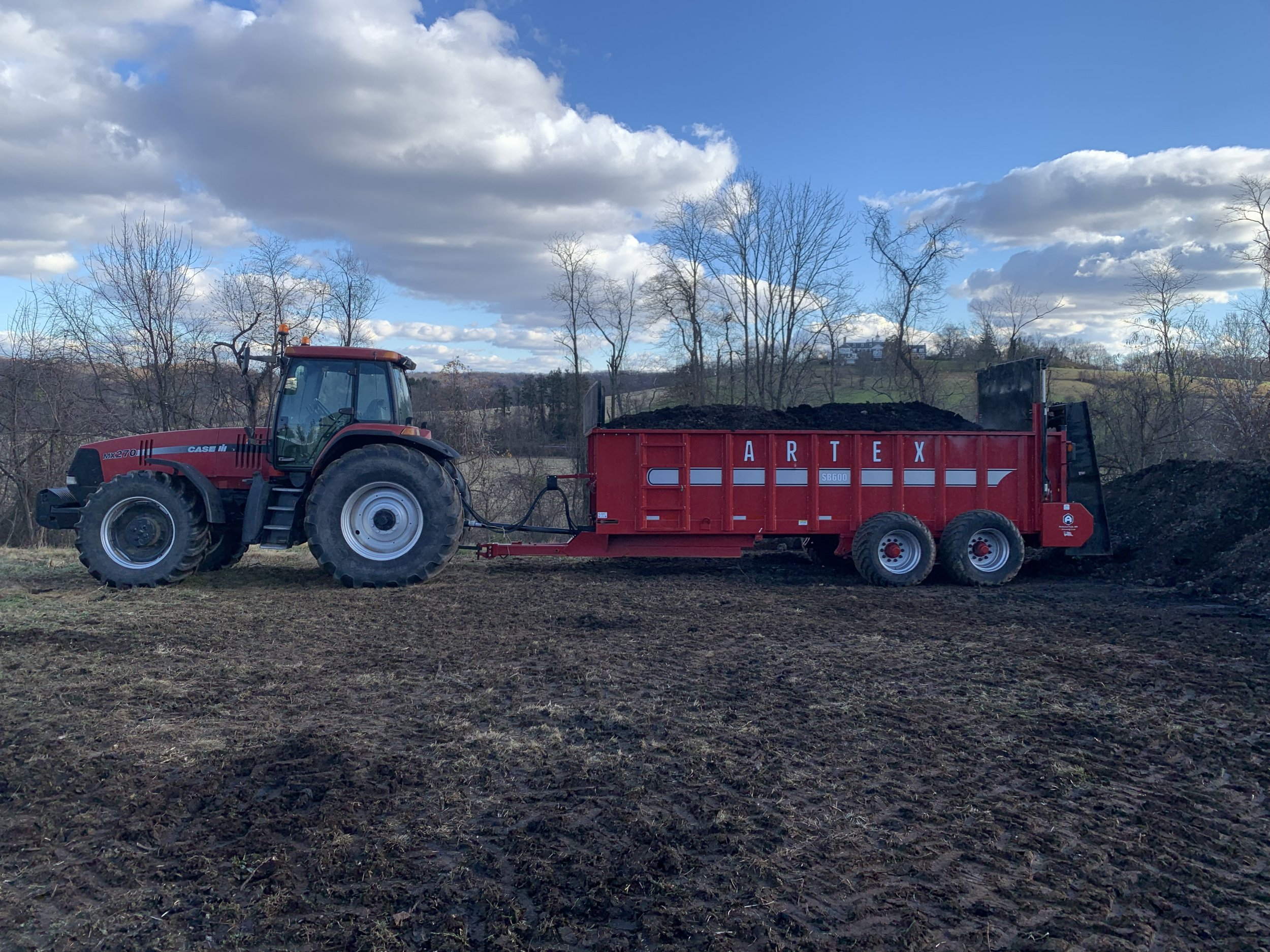

I am fortunate in that we have a huge concentration of mushroom farmers in my area. They give away spent mushroom compost. They even deliver it free. I only have to spread it. Makes a fantastic source of free fertilizer. I would not be farming if we didn’t have it.
I also apply lime fairly frequently, which surprisingly has remained pretty stable in price. We have a local Mennonite owned company that has not decided to price gouge just because they can.
Do you have any poultry houses in your area? That can be a reasonably priced alternative. I have been getting inundated with offers to spread this stuff too, but I think it’s got human waste in it. No way I’m doing that.
I always thought if I had no mushroom soil available, I would buy a large sturdy manure spreader like the one I used to own. Then drive it to your local livestock and horse farms with a truck or tractor pulling it, they load it with their manure, you take it back to your fields and spread it. They are usually would be more than happy to get rid of it.
