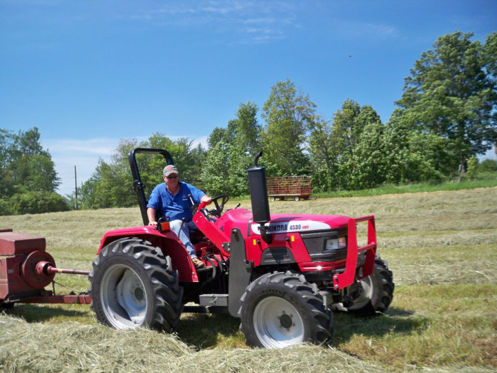

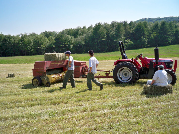

I run a NH 315 behind my 4530. No problems at all. THe 4530 is a bit heavier that the 4110.
attachment.php
attachment.php
Did over 500 bales last weekend.
