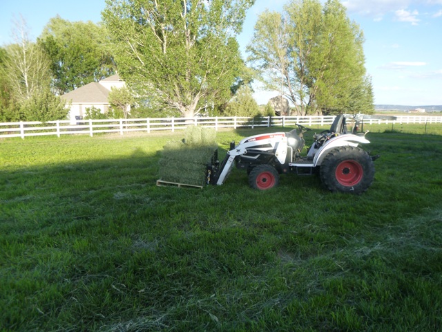

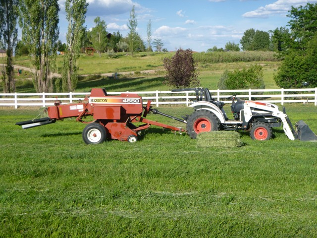

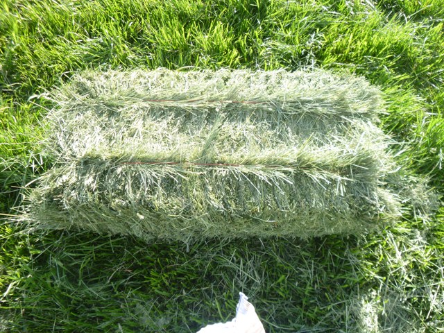

Well to all the naysayers I can only post this. Tractor handled the load fine. needed the full 540 RPM near max throttle. Rocking motion was not bad. used ow range, but probably could have used mid range as I did for clean up.
Equipment used to bale:
IH 1300 sickle mower - 9' bar
Rebuilt Ford 503 side delivery rake
Hesston 4550 baler - current model is MF 1835 I think.
