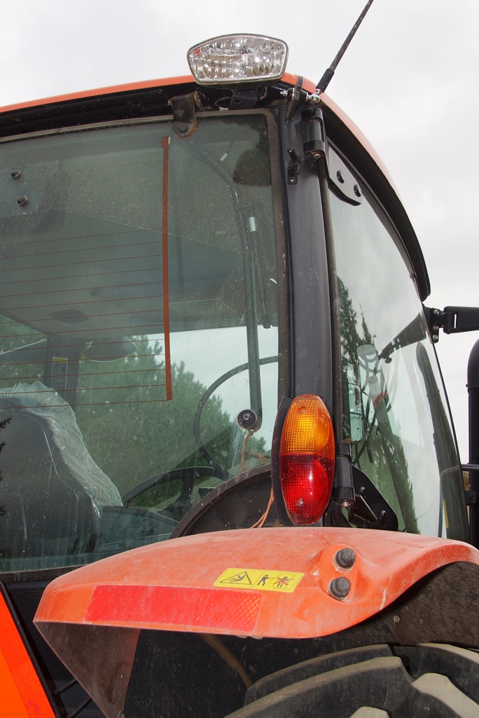

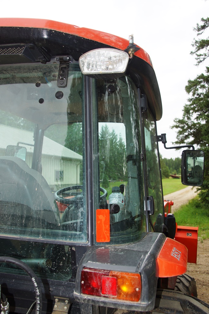

Here are pictures illustrating what I was talking about in my earlier post. The broken flasher on the L5740 sticks far outside the machine, the most vulnerable position possible at the cab corner. The working light is protected by the cab. There is a warning flasher on the fender. Same thing on the front - there is a warning light low on the front. The only possible reason for locating in such a vulnerable position is the top flashers are visible front and rear - until they are knocked off. The other picture shows my M135GX which has the flasher inside the cab side width for protection although this tractor is much less likely to be driven into the trees.
Legally the light does not need to be placed in the vulnerable position. The lighting standard states the light must be placed xx from the outside of the machine. Actually the fender lights meet the standard. The top light is not a requirement per SAE and ISO standards, but there is no rule about adding extra lights if one wants to.

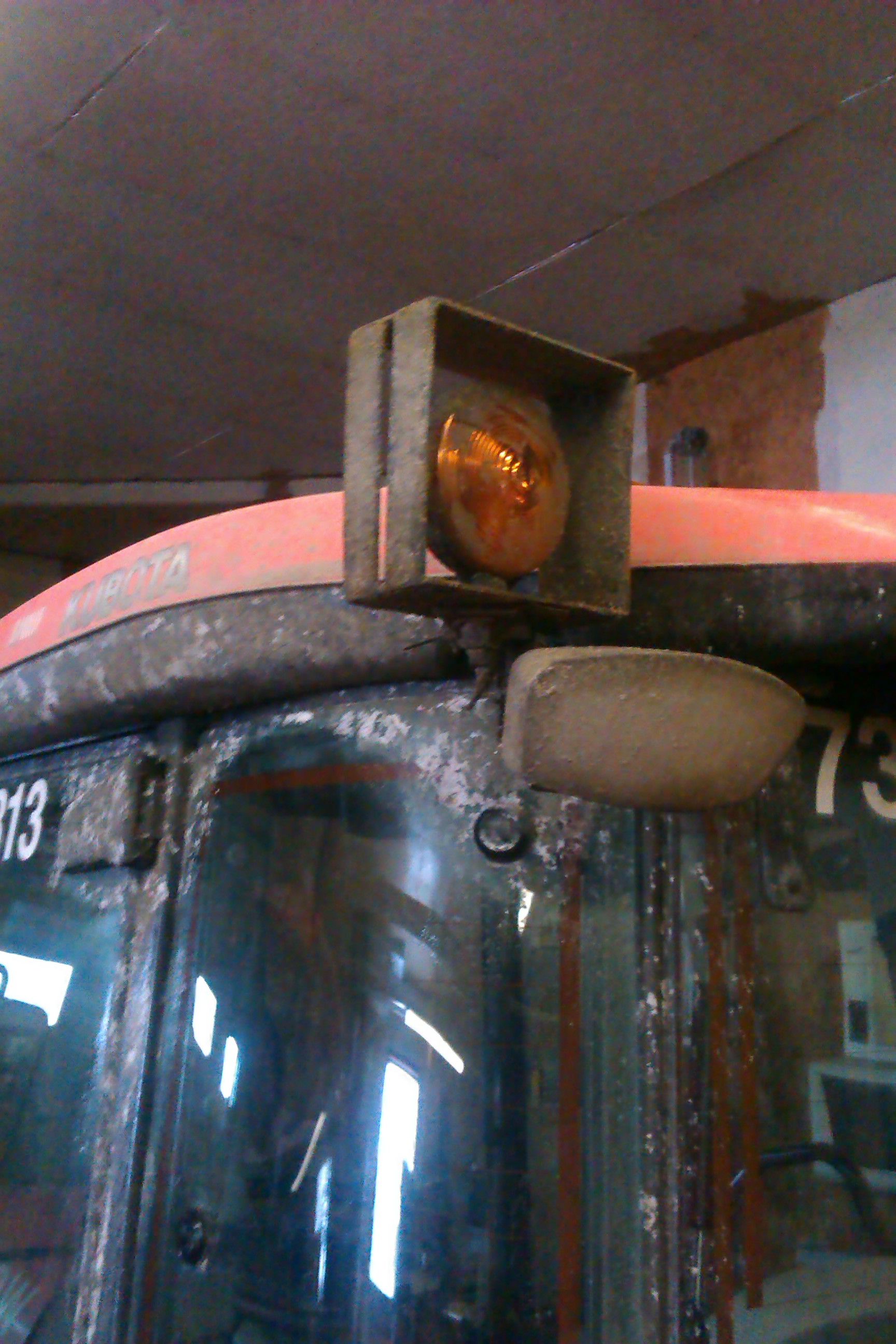

Here is a pic from a similar thread from earlier this year.
This looks very similar to what my technician described to me as what he intends to fabricate. I think I've seen guards like this on something else but I can't remember what it was.

I've seen several posts on making guards...might also find they are available through Kubota, so I'd suggest asking a local dealer first.
