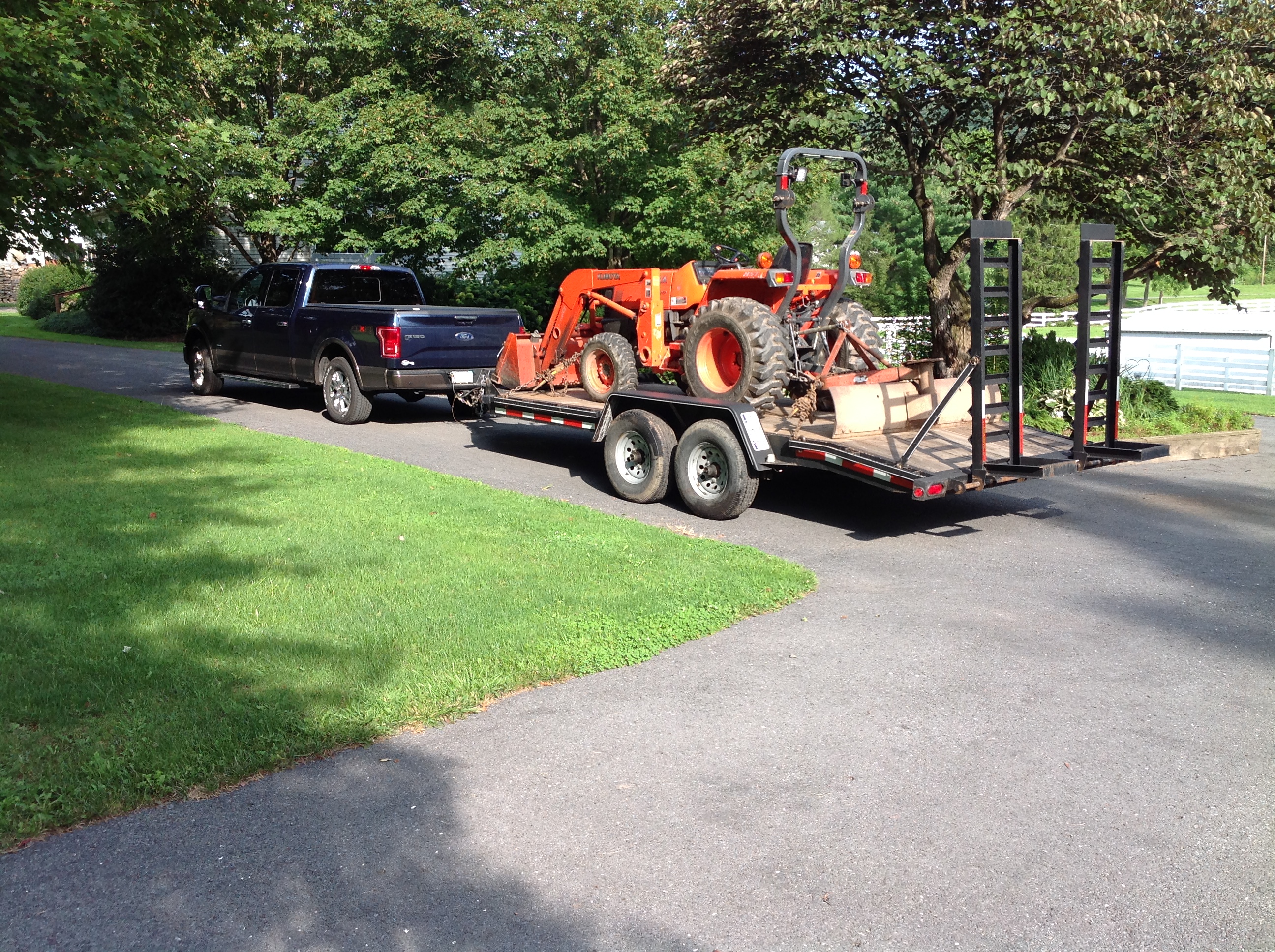

I just got a 2017 F150 3.5eb zsCrew w/6.5' bed. Very happy so far. Just hauled my tractor yesterday for the first time and I was impressed with the power, no problem with these PA hills. 10.5 mpg. No complaints.

My tractor weighs around 9500 pounds, (filled tires with hydraulic box scraper) plus 3500 lbs for a 20 footer flat bed trailer.. I couldn't imagine towing that with a 1/2 ton truck. I think they're fine for hauling a BX around though.
Totally agree, I think my tractor and trailer come in at around 7000 lbs, well under the truck's rated capacity.
