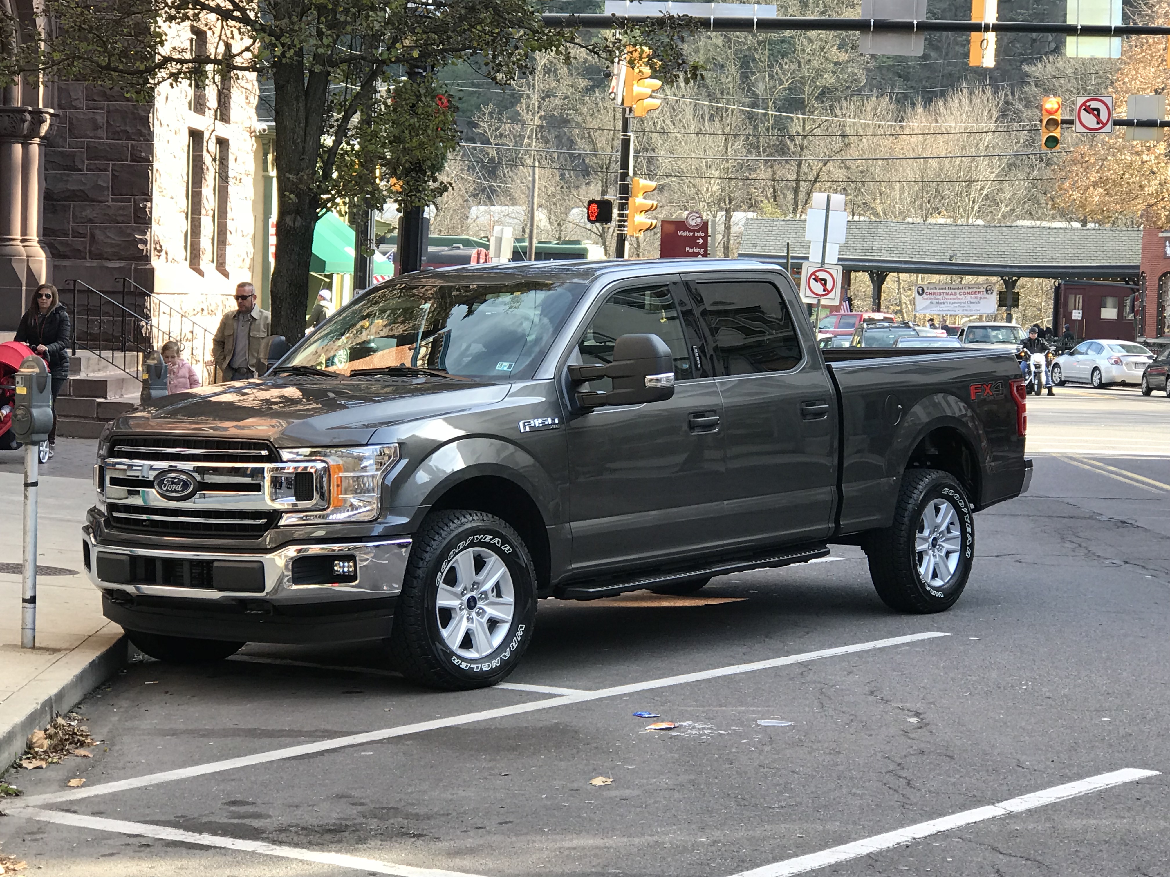

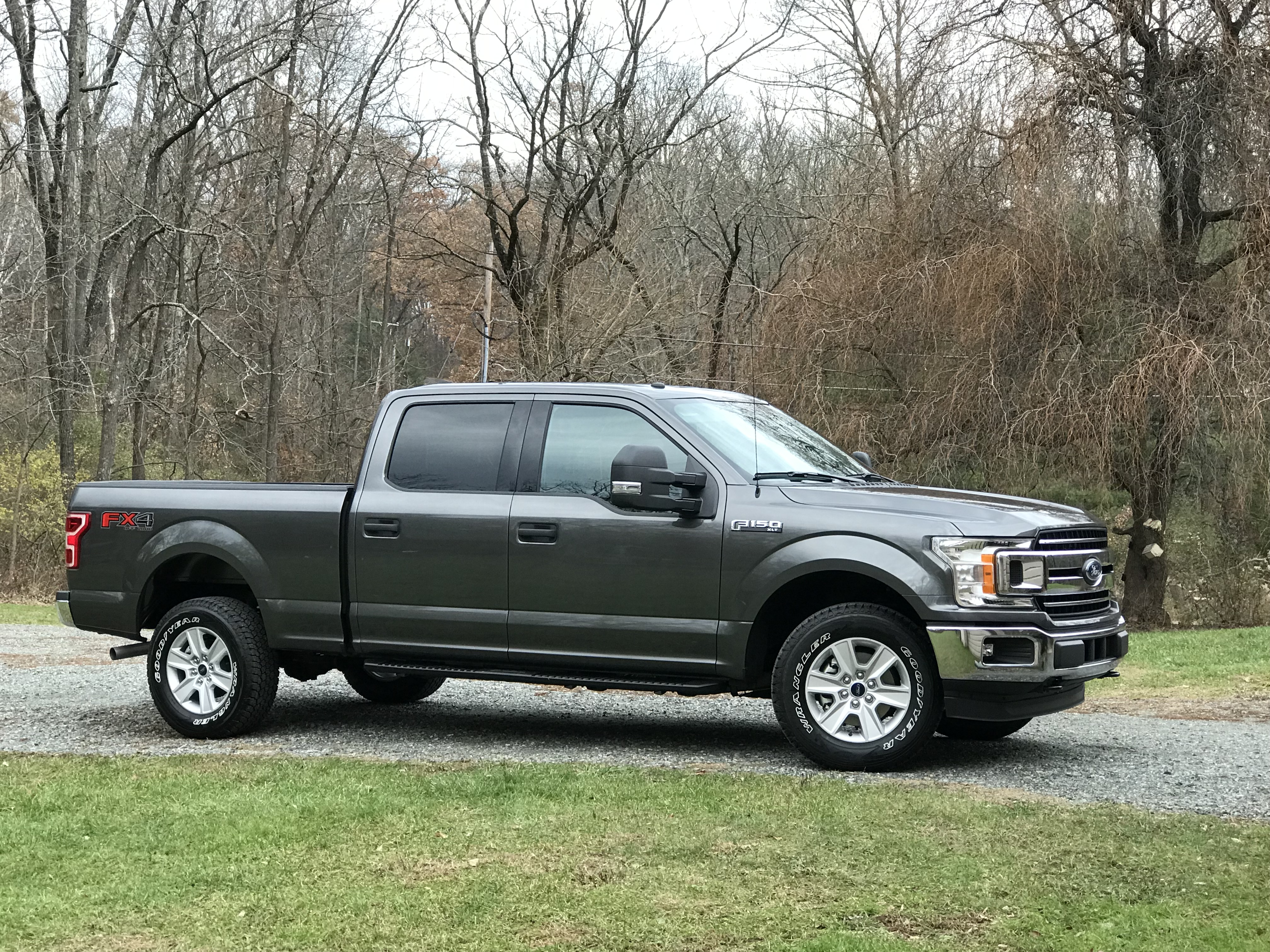

I brought the truck home today! 70 miles on it so far with a "lifetime" average of 20.1 mpg on the readout - 60% of that was highway with Cruise set to 70mph. Given that it has the 3.73 gears, elephant mirrors and isn't broken in, I'm very please with MPG empty.
And of course, the obligatory pictures!
How did you get 3.73 gears, I thought the lowest on the F150 was 3.55?
The only way to get the 3.73 gears on a 2018 with the 3.5 ecoboost is with the heavy duty payload package (HDPP).
HDPP gives you everything Max tow gives you plus:
-9.75" HD axle with 3.73 gear (HD is because the axle tube is thicker and oil capacity higher than the Max tow 9.75") Also rated higher at 4800 RGAWR
-Thicker frame stock (HDPP >10% thicker than Max tow which is > 10% thicker than non-Max tow)
-3+1 rear leaf spring pack instead of the normal 2+1
- thicker stronger front coils than any non-HDPP F150 (but same FGAWR as highest rated non-HDPP option)
- stronger wheels & LT instead of P tires
Few dealers stock them so for most it is a special order item.
