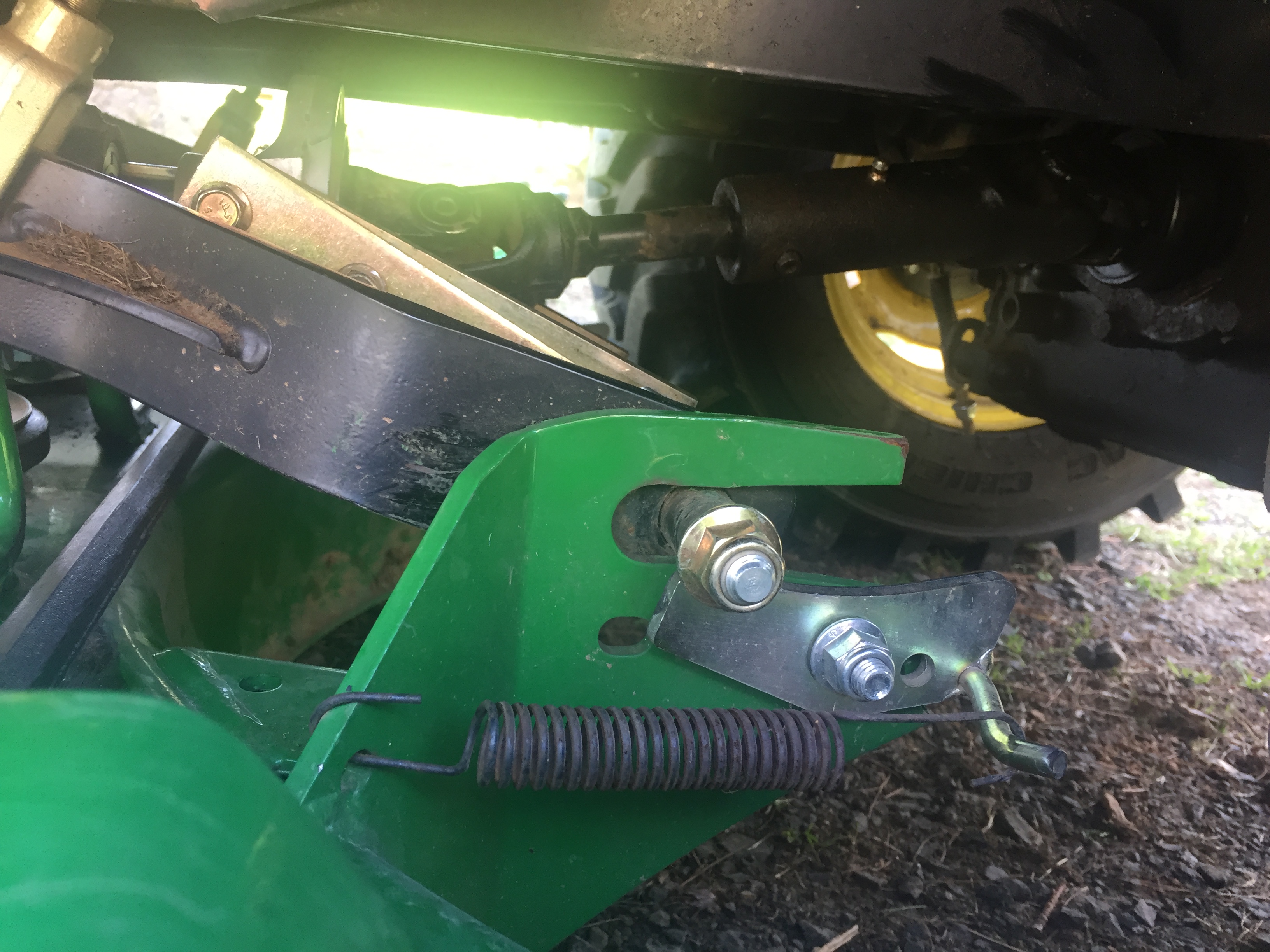

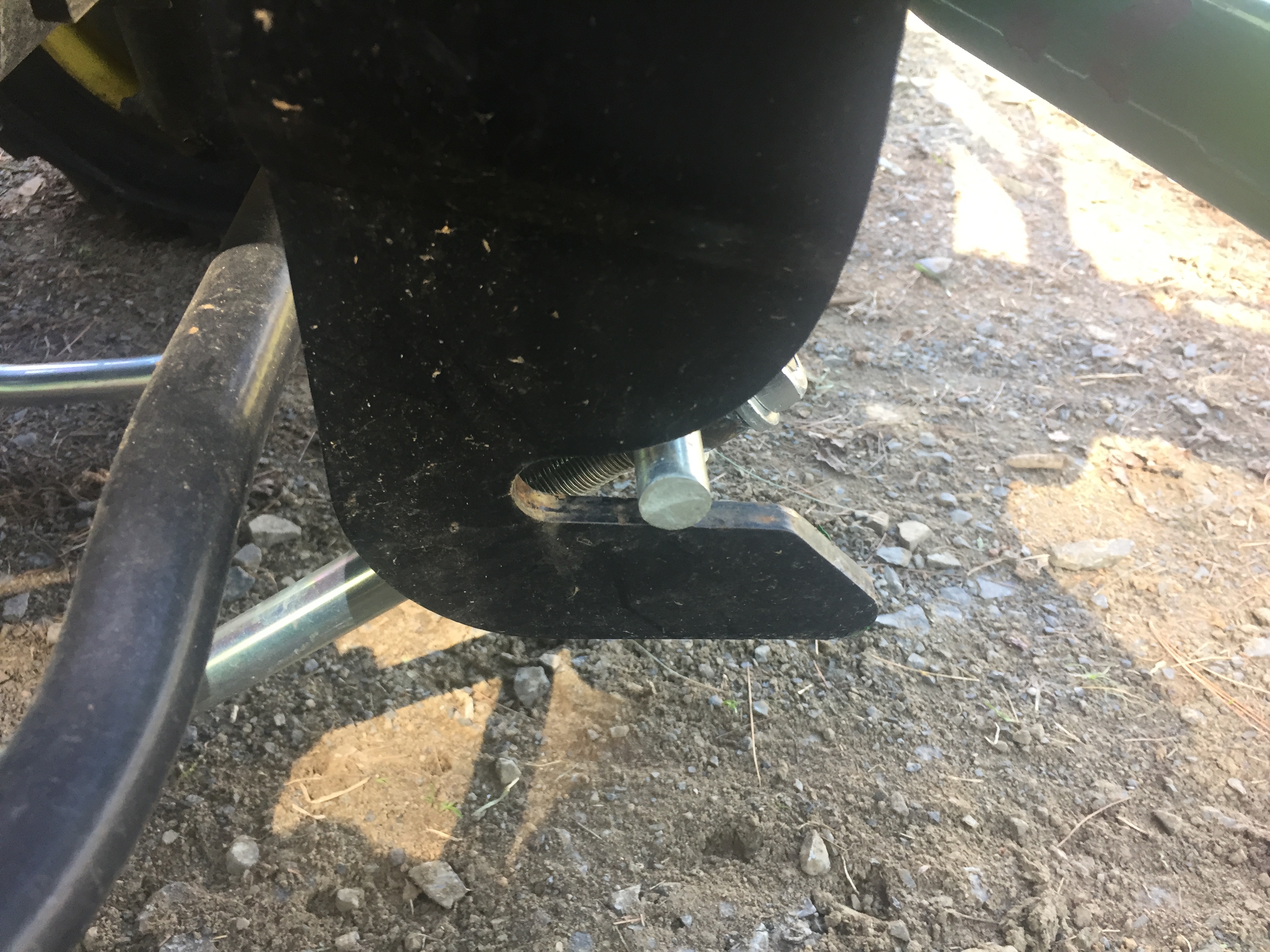

JD 1025R, HD60 mid mount mower.
Reading the manual (OMLVU26521 H2), I follow all the steps.
All works fine until it is time to lift the mower and set the height adjustment. Then it becomes clear that the rear lock tab is not seated against the rear lift arm rod. In fact, the rear lift arms are NOT fully engaged in the rear lock assembly. Of course, the front draft link pivot pin is not fully engaged in the front support hangers. Repeated attempts to get this task done have been unsuccessful, if not entertaining.
Does anyone have experience with this kind of problem?
I've been at this for four days, on and off. Tomorrow, Monday, I'll call the dealer and see what they have to say.

So, I ran out the nuts on the front draft link.
Try as I might, I cannot get the mower deck to seat in the fully locked position. IMG_0687.JPGIMG_0686.JPGIMG_0685.JPGIMG_0684.JPG

OK! Here's the answer:
In the front of the tractor are the front support hangers. Essentially, they are two slots that the front draft link pivot pin slides into. When the pin is all the way in the two slots, the rear lift arms are all the way in the rear lock assembly.
In this case, the right-hand front support hanger was bent! The bend prevented the pivot pin from sliding all the way back. The local dealer's repair guy was able straighten the hanger out with really big crescent wrench.
Now the mower installs correctly under the tractor.
