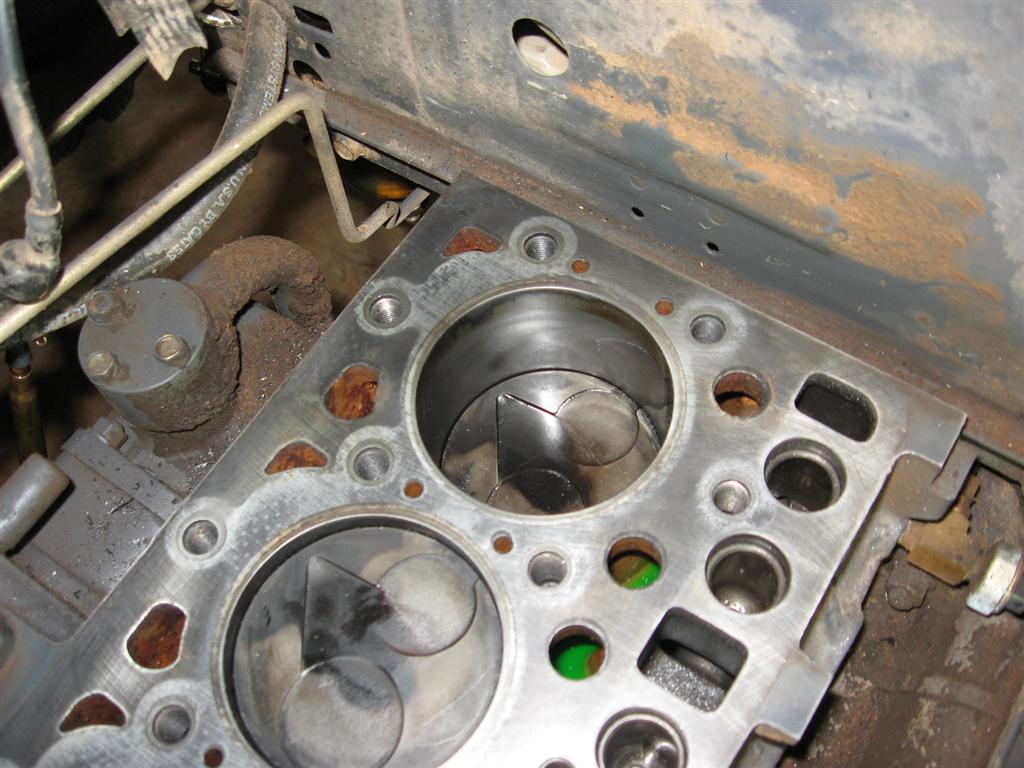

RobJ, I don't see reason there to cause a overheating issue.
That head doesn't look bad at all.
That's what I'am thinking I don't see where the head or the gasket would cause his high temp problems :confused: It all looks in very good shape.
   / Head Gasket Replacement on my Kubota #23
That head doesn't look bad at all. I wouldn't shave much if any at all, straight edge it, grind valves, check guides...etc and put her back together. I would remove the radiator while you have it torn down and get it rotted & repaired.
I'm with you on this one. This may have been the problem all along. Might as well check water pump condition while he's at it.

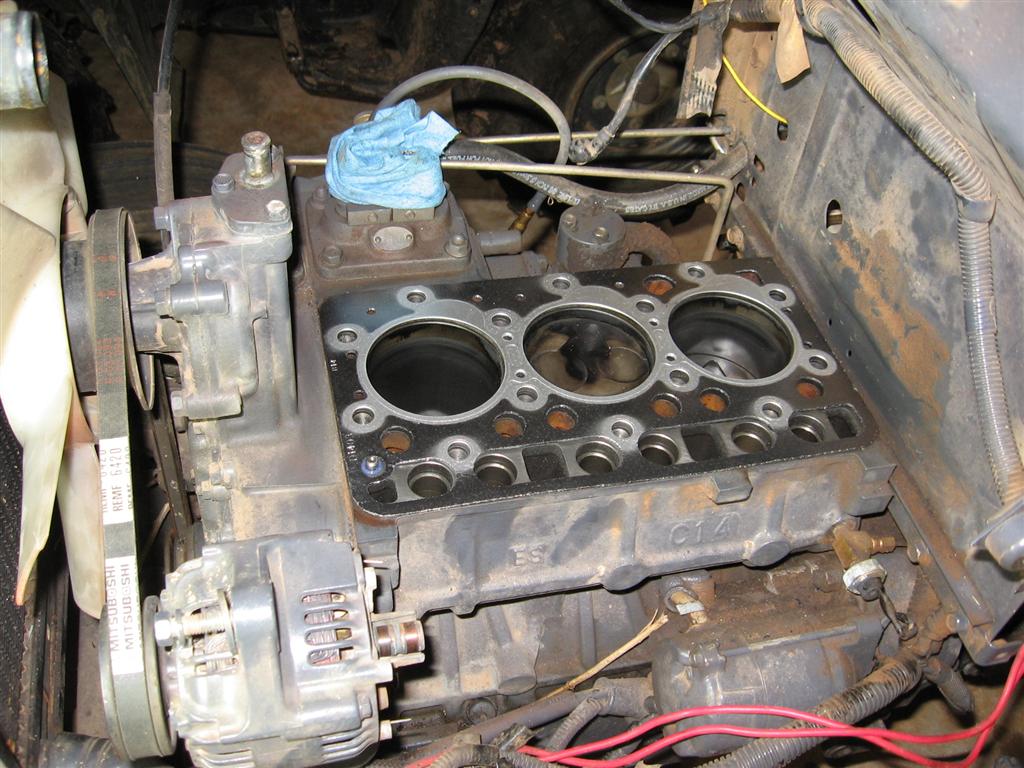

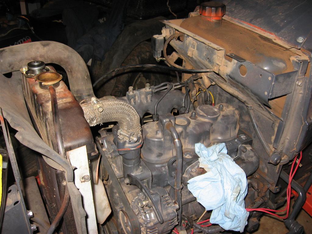

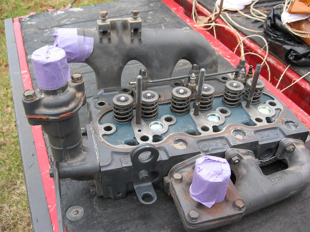

Well I'm still alive, patchwork blanket and all. I have no idea where that come from, I don't think it's homemade..I hope. Heck now yall have me scared. Not from my wife, she wants to toss it, but maybe Mom, Sis? I really don't know where it came from.
Ok funny what you remember...and in my case don't. The valves are actually just below the face of the head. Maybe 30-40 thousand. Not much. I picked up the head, and all looks well. The cost was only $70, I was happy, I was preparing for $150. I did find where some extra "stuff" in the gasket set goes. Little metal caps (reminds me of the male part of of a jacket snap...or a bed cover snap. They are heat insulators that go in first in the injector hole. This weekend I'll put the injectors and manufolds back on. I'm thinking about pulling one of the valve springs to just see the job. :D
As far as the overheating, man I have flushed the radiator to no end. But 2 nuts ad a hose and it's off. I'll probably run it as is and check it out. On mine it's really not that hard to pull it. Also remember the temp pick up is all the way in the back, farthest from the radiator, and next to the cylinder with the bad valve and gasket concern.
The water pump. It's this big piece that is about a foot long. $131 it also ain't cheap. In the summer I ran the return hose from the thermo out to the side of the engine. Getting plenty of flow. So I think I'm going to leave it for now. It's sort of a boger to pull no matter what.
So now I'm basically in wait mode until Christmas is over and I can get back up there.

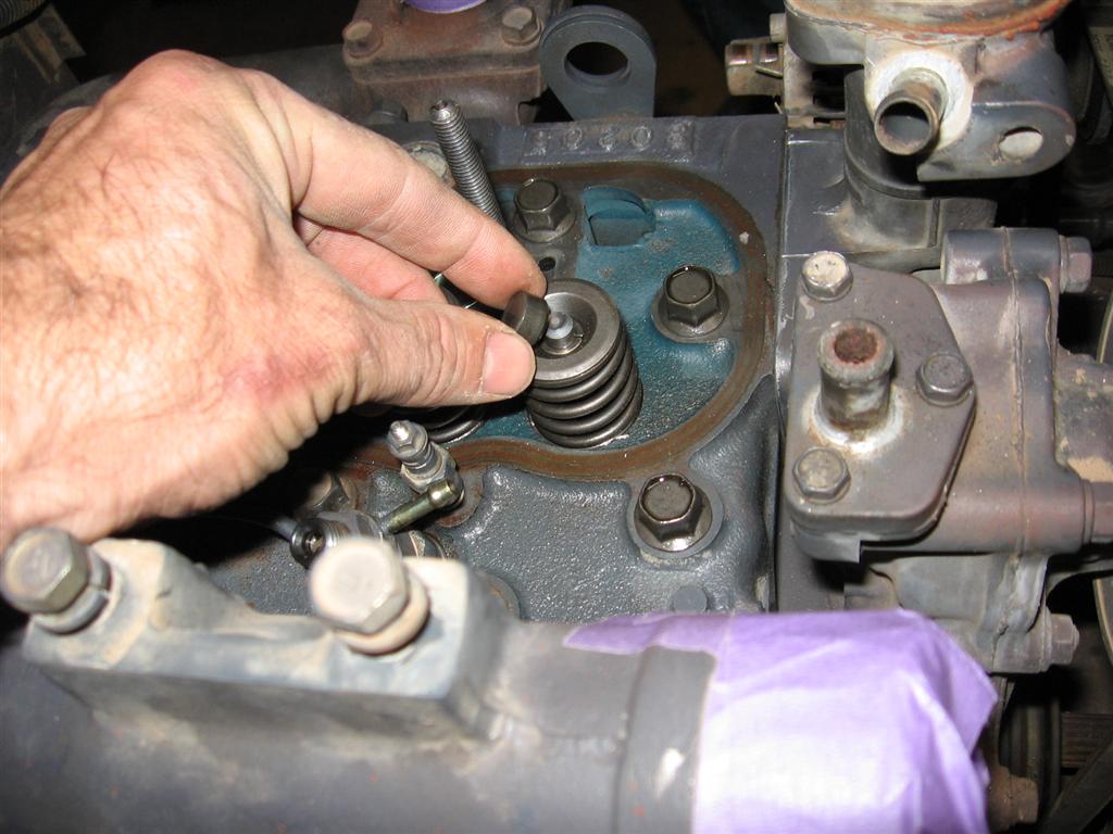

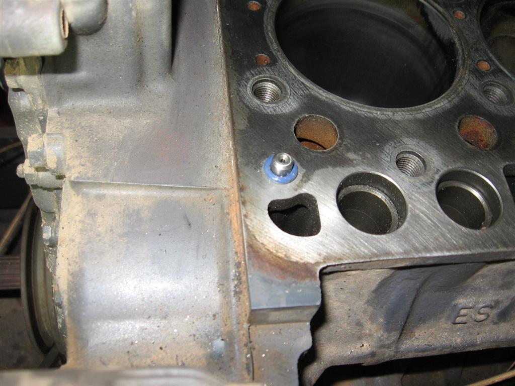

Interesting little o-ring on the head. OK but it's there and new!!
Also these caps on the valve stems...
