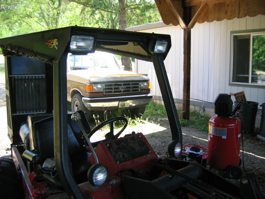

Today I mounted a Truck Star LED Utility light (part no 1492110) on one under side of my ROPS. I left the 55 watt Halogen on the other side. I have separate switches so I can run one or the other or both. The LED light is OK and good for close work, but to see far I turn on the halogen. I will probably leave it this way with LED on one side and halogen on the other. I bought a second LED light and may put that on the back. I got the light from Kaffenbarger Welding Co., Inc. It pulls about one amp.

My LED lights are much brighter than the 55W halogen I have used.
PT1850 LED Lights
Ken
Yes, I went cheap and low power. This certainly gives people options. Time will tell if this is enough light, but it seemed OK last night. I would definitely not give up the remaining 55w light on the front. Also even with all the lights on now I am not maxing out the electrical system of the PT.

I just installed the Autoilumination 4.5 inch, 18watt, round work light on one side of the PT422. It is so much better that the other LED light I have. What a difference. I highly recommend the light, however, I still have not heard back from them about the polarity. It's been over 24 hours. I tried calling their phone and I got a message to use the Internet. I think they just have a phone to say they have one.
Anyway, great light.

It's working fine. So the polarity issue is over, but it would have been nice to hear from the company. I took some pictures, but have no way of setting my camera. The first three pictures look the same to me. The first picture is the low power LED only, the second is the Autolumination only, the third is both and the fourth is a looking at the lights. You can see the difference here. Of course I have one type on one side and a different type on the other. The Autolumination light is on the left side of the picture.
I have a separate switch on each light. Probably not really needed now, but I like control.
I am tempted to get one of the Autolumination lights for an emergency light in the house. I could put it on my Dewalt battery or run it off of a car battery. Kinda expensive for a flash light though.
