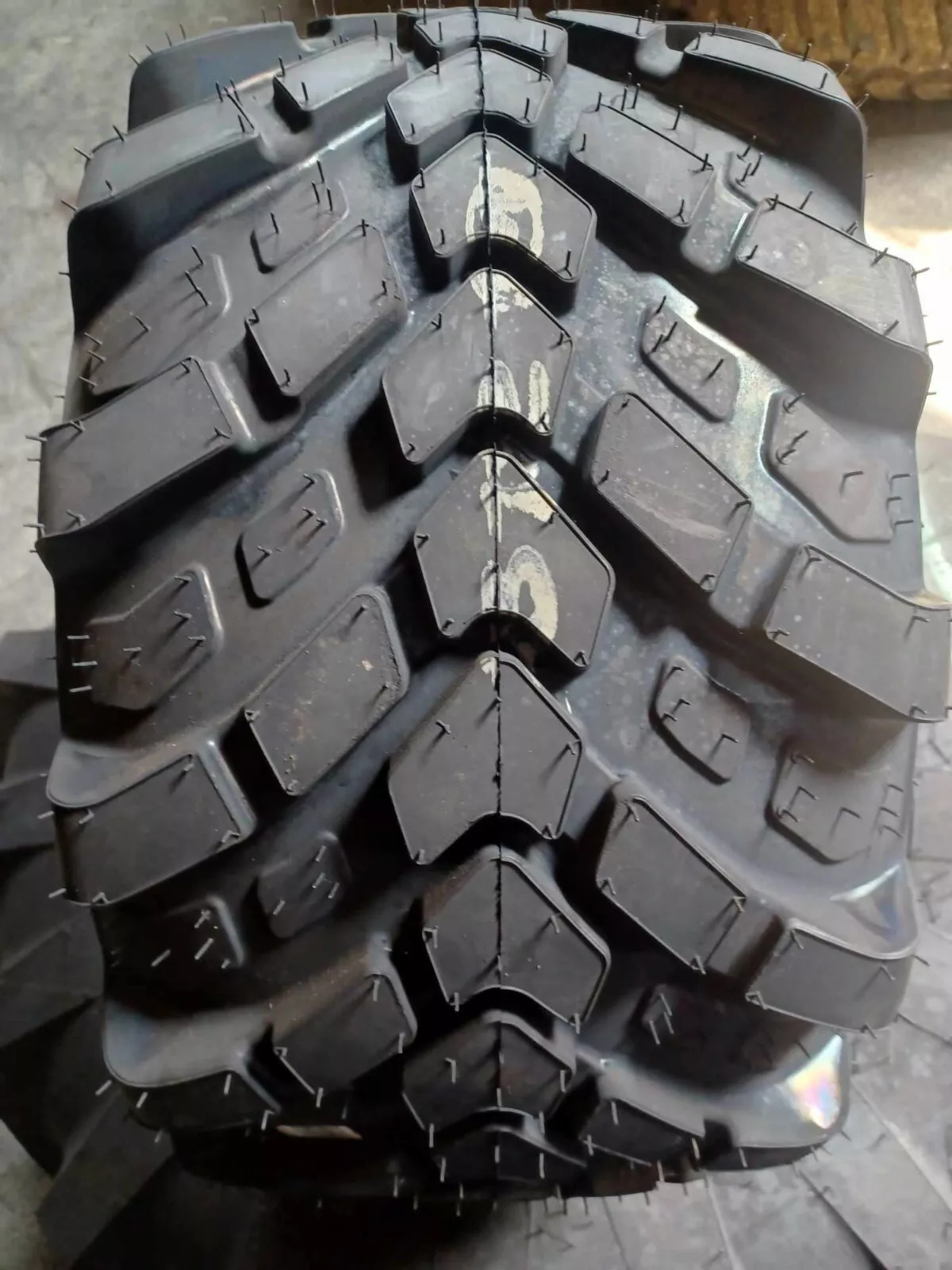

I ended up with Carlisle Tru-power lug tires. After lots of googling, I came to the conclusion that they should be the second most aggressive lug tire in my size. The reproduction Firestones are #1, but they would cost $1000 for a set with shipping from Miller Tire, where the Tru Powers were $480 from Amazon.
The TPs look a lot more aggressive than the Super Lugs that PT used to put on the PT425, with a very squared-off profile and heavier lugs, so I'm hoping they will work better than the rounded profile SL. Carlisle no longer sells the SL in this size, anyway.

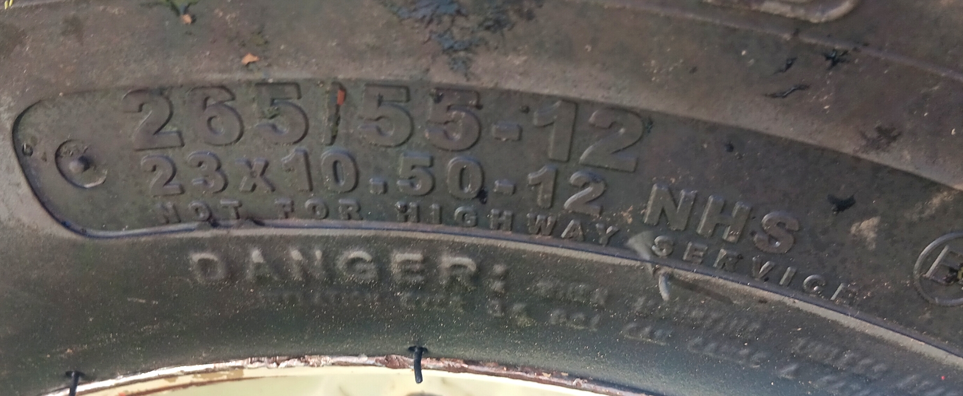

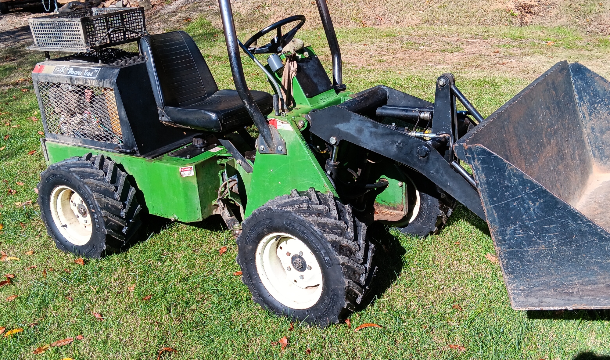

I found it interesting that the tires are also labeled with an automotive size. They ride noticeably stiffer than the All Trails, despite both being 4-ply.

Tire review after a few weeks: They do better out on the wooded hillsides than anything else I've tried. Think loose rocks on soft soil under a thick layer of dead leaves, going up slopes that challenge the wheel motors and sometimes win. They leave more visible tracks on the lawn than any other tires I've tried, likely because of the sharply squared-off shoulders, and they definitely tear up the ground in the woods.
They also ride like a freakin' buckboard. They are 4 ply, but they are stiffer than some 6 plies I've had, and the spacing of the lugs is wide enough that I sometimes feel each lug jolting me a little. I'm OK with the rough ride, because they have been getting me up to some really good dead firewood trees. When mowing season comes around again, I'll use another set of wheels with turf tires and a softer ride.
For those with larger budgets, I would bet that the Firestones would be even better at climbing my slopes, but for the money I like these. It will be interesting to see how they wear and how the traction changes as the corners and edges wear down.

Tire update: we had a couple inches of snow. Plowing snow straight ahead on the driveway, these tires did not slip on the asphalt when the pile of snow in front got pretty big. I'd say they did somewhat better than the All Trails, although it wasn't much of a test. They definitely have more traction in dirt, and they leave very visible tracks on soft or wet soil.
