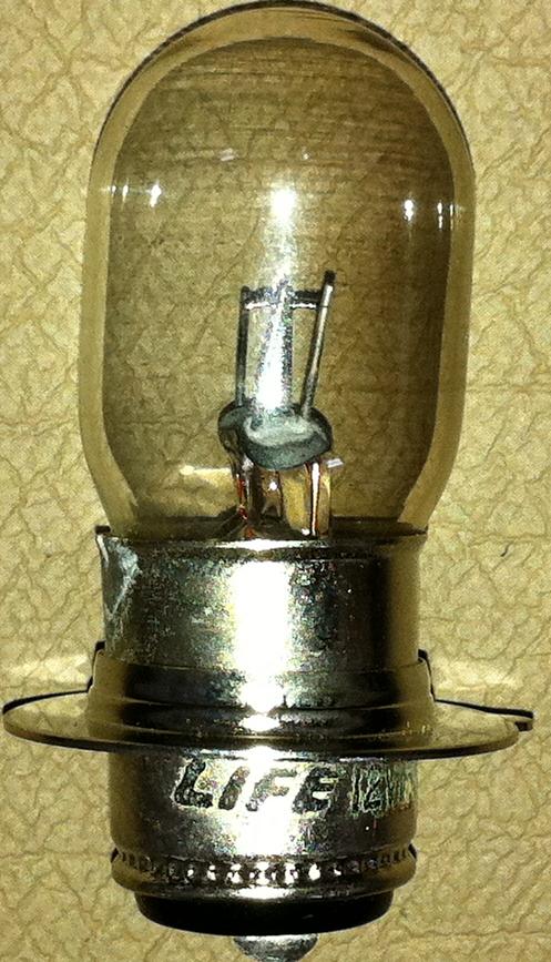

G'day all,
the 15 watt bulbs in our B2150 are next to useless and I have been looking for higher wattage bulbs.
In my internet travels I have found the bulb could best be described as a
T19, MPF or a P15d-25-1.
The standard incandescent bulbs seem to be available in 15W, 25W or 35W,
6V, 12V or 24V
35 watt halogen bulbs are available (Philips call these an M5). caution they may be detrimental to the plastic lense....
Motorcycle parts suppliers (in England) seem to be the best source of supply.
good luck !

This is very helpful info.. thanks for sharing it.
I have been trying to get my hnads on replacement bulbs elswhere than from the dealer, and this info will help me search for replacements somewhere else.
The Kubota Service manual and part sbooks are useless as far as any specific info.
They don't tell you the wattage of bulbs, nor the output of the dynamo.
