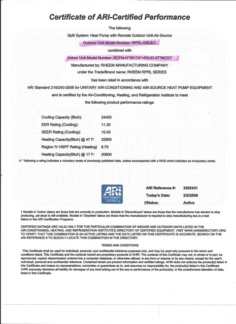

On a side note, if you do go for a "tax credit" system, make sure that the HVAC contractor supplies you with an AHRI rating "match up" of the system. I'd suggest you make a copy of your invoice for the work and attach it to the AHRI rating sheet for your tax records.
See, if you go with a 14 SEER outdoor unit and a non variable speed air handler, you may only be getting 14 SEER. However, if you go with a variable speed air handler, you may actually get a 15 SEER.
Technically, the AHRI rating ensures that the manufacturer isn't "cheating" on what they are telling you what you should get since the ratings are done by a third party.
Example of an "official" AHRI rating done with Rheem equipment...
