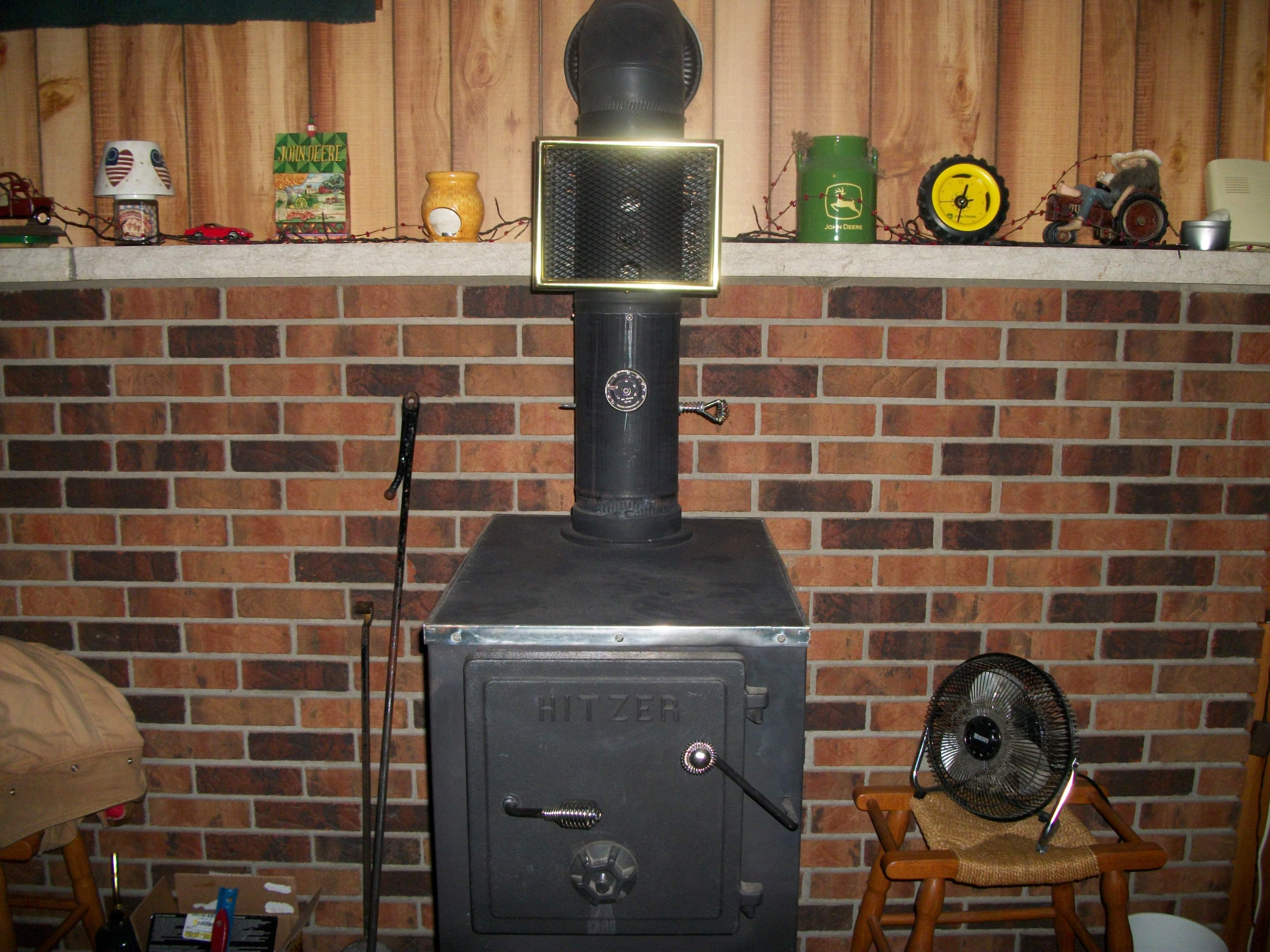

here is our heat reclaimer on the anthracite coal stove in basement. The brand is volgazang and cost 99.00, Ialso have one on my small wood stove in garage. They are thermostatic controled dont come on untill pipe gets to 350 degrees. So far they have done a goog job. Stove pipes are 6 in. 100_4440.jpg

here is our heat reclaimer on the anthracite coal stove in basement. The brand is volgazang and cost 99.00, Ialso have one on my small wood stove in garage. They are thermostatic controled dont come on untill pipe gets to 350 degrees. So far they have done a goog job. Stove pipes are 6 in.View attachment 301578

Vogelzang, got one of their stack thermostats on my stove... another great Michigan company.... down by Holland me thinks.....
