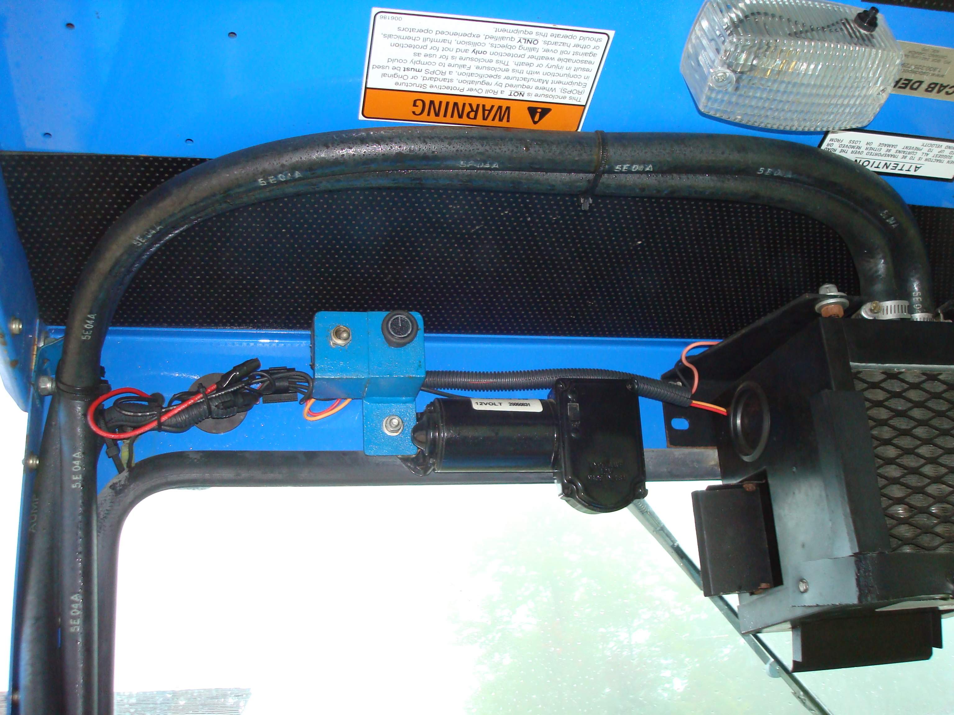

   / Heater Hoses in tractor Cab ????? #13
I ran my heater hoses inside the Sims cab I bought. They work fine and the heater will drive you out the cab.

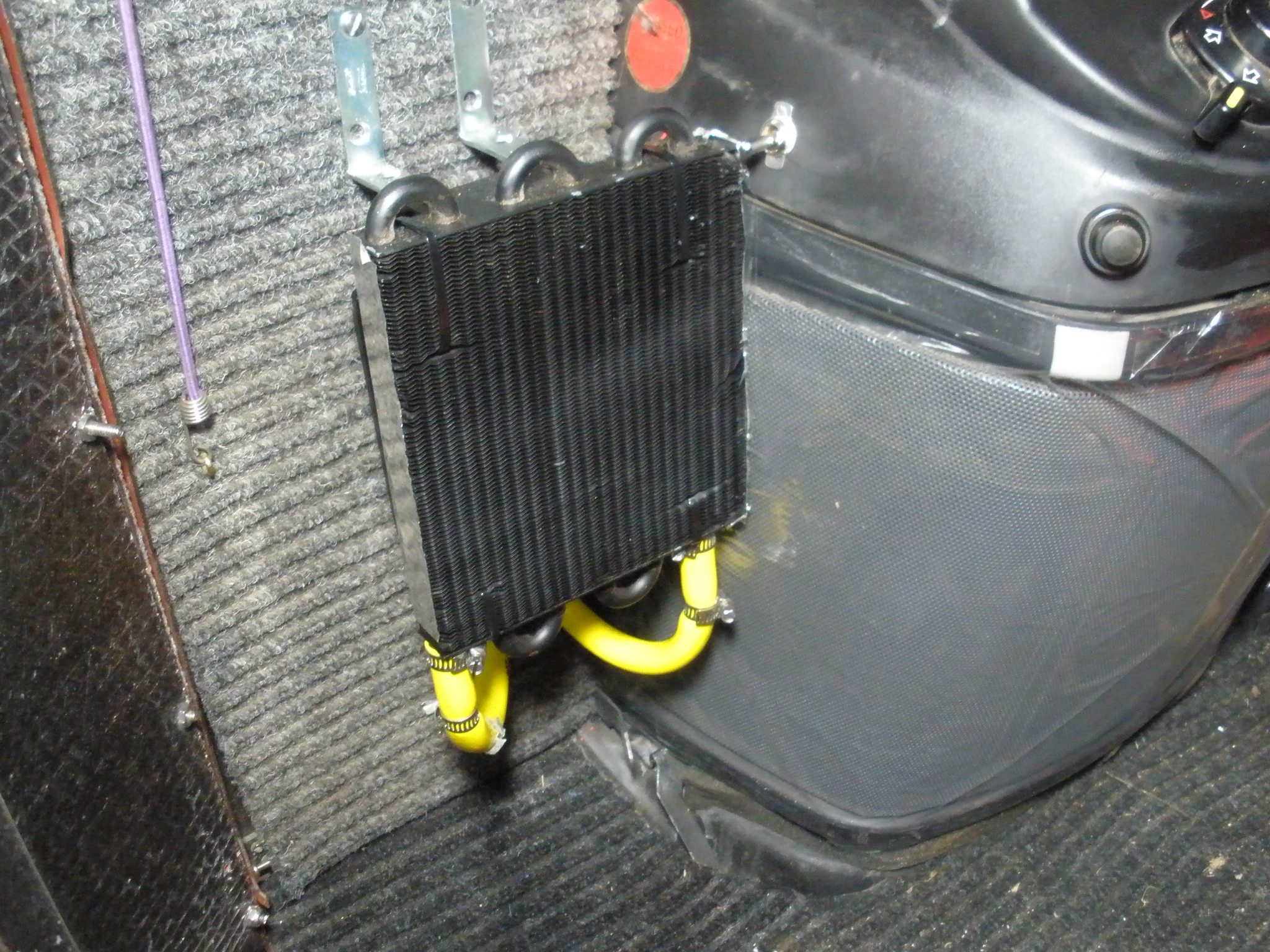

Where I worked years age, we made up 20 of these for Harley oil coolers. Used one for my heater in the cab w/ 4" fan behind it. It won't run you out of the cab but sure takes the chill off.heater coil.JPG

Tvman - can you send me a picture of where you tapped into the supply / return for the cab heater ? I checked out my tractor and found a pipe plug near the thermostat. I am assuming this would be after the pump. I could not find a return, I assume I would have to add a fitting in the lower radiator hose.
If anyone has an L 30 series tractor with a coolant heater, I would really like to see how you plumbed it. Thanks
