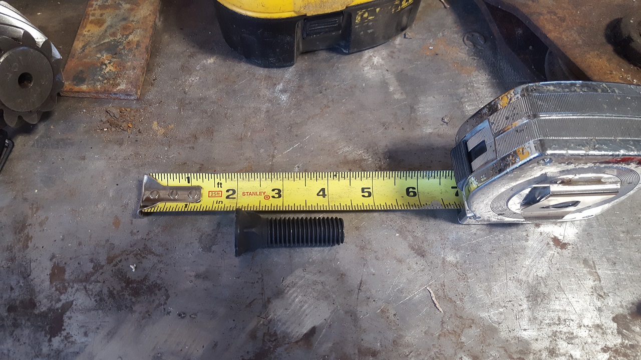

2 questions ovrsd, what does it cost you to heat your shop, and when you measure plow bolts do you measure overall length? I need to replace the bolts that fasten the mouldboard on my back blade.
As Rick stated, overall length of the bolt. Here's a 2 1/4" bolt.
