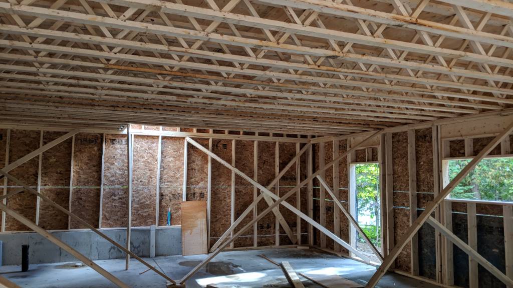

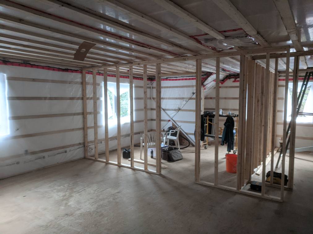

5030:. Is this a commercial solution or a DIY setup?. It sounds straight forward - hot water tank, pump, zone valves and thermostats. I expect you have an air tank to deal with expansion as well.
I have a garage with a second floor that I am turning into winterized living space. The attic, walls and stairwell are well insulated and sealed. Heatpump install is next week. Once the electrical and plumbing are completed I will insulate the garage ceiling (living space floor). It is 16" engineered joists so I can get about R45 or R50 in that cavity. The garage will be insulated but not be heated, except on occasion.
A question for you and others... Will a well insulated living space floor be enough to feel warm under foot or should I consider installing PEX in the joists for future "under' floor heating? The piping would have to run under the top cord of the joists (2x4). If so, what spacing should I use for the piping? IMG_20191127_160003.jpgIMG_20180922_101131.jpg

Run an in floor heating system on top of the floor.
A question for you and others... Will a well insulated living space floor be enough to feel warm under foot or should I consider installing PEX in the joists for future "under' floor heating? The piping would have to run under the top cord of the joists (2x4). If so, what spacing should I use for the piping?View attachment 632351View attachment 632352

I see that now you can buy pre-plumbed sections of pex-mat to install under flooring, between joists. Menards sells them, seen them in the store. I see they also sell a resistance mat, same application and I may install that under our existing bathroom tile floor as the tile is terribly cold in the winter as I keep the basement cool. No point in heating a storage space.

You can do them on the underside now as well.
And that means you can do it later if your floor is uncomfortable*. I think with that big (deep) floor joist cavity that you'll be able to insulate it enough for most situations. BUT if you already are making hot water in that building the added cost is not that much. How about stapling up the pex anyway before you insulate, that might be the best plan for a couple of hundred bucks you'll be radiant ready. I say this as I have a 4' cantelever area that's open to the weather that is noticeable after a long spell of very cold. It's not uncomfortably cold but noticeable for sure. It's about a 12" cavity that's filled with p-iso foam at about r-7 per inch, but like I said, completely out in the weather at the 2nd floor and the shady side of the building.
*short of having to pull the insulation, but that would not be a deal breaker for me.
edit; just saw your strapping in the pics. If it were me I'd install the pex at least.
