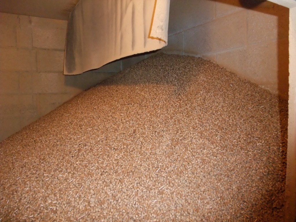

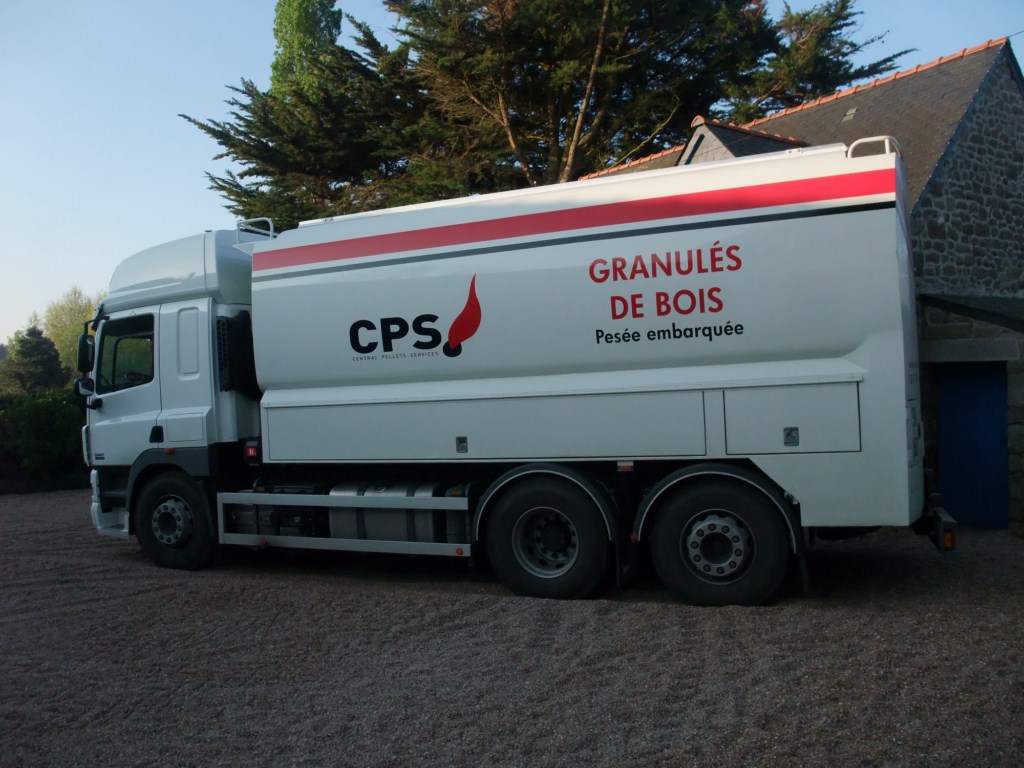

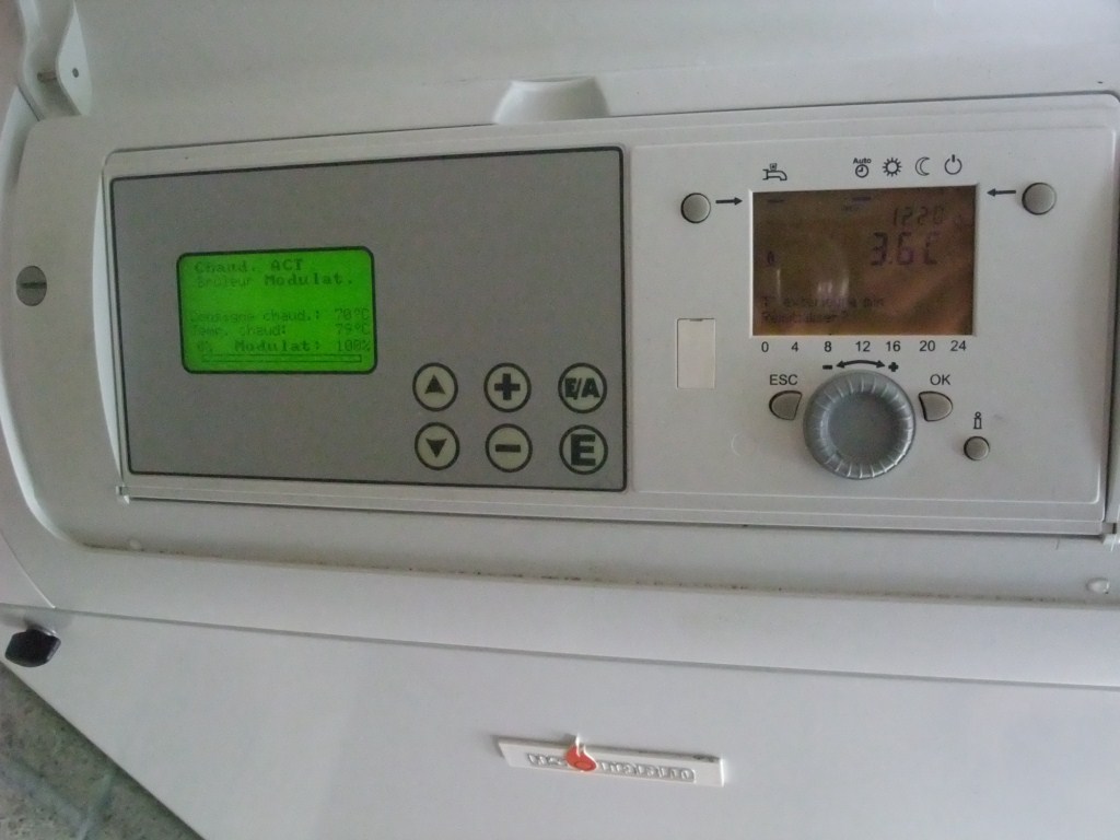

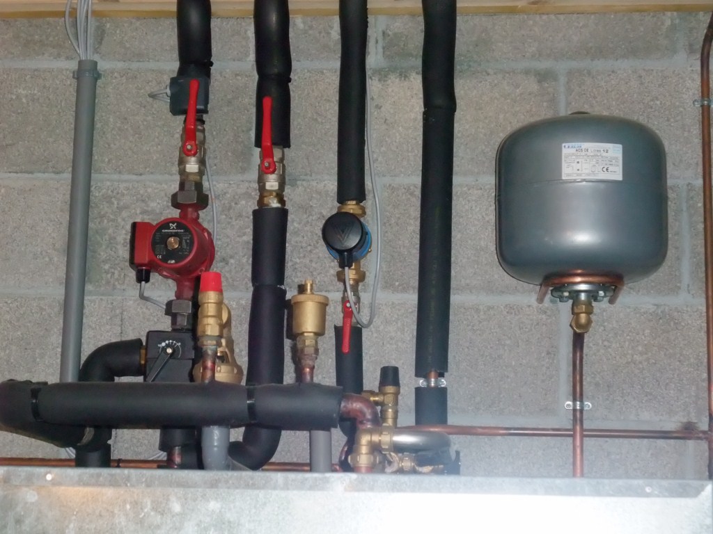

   / Heating with Pellet Stove???Wth? #30
Pellets provide a very clean way of heating a house. No logs to carry to the fire place, no smell of oil, very small amount of ashes (maker claims 95% efficiency and I empty the ash container once every fortnight). No limit to the size of furnace you install, very efficient hot water production. The figures vary from one country to another, but in Europe the cost is less than with oil, much less than propane and much, much less than electricity. Pellets can be bought in bulk (cheaper than bags) and blown into your silo.
