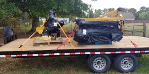

The ability to load/unload from the sides (particularly with pallet forks if so desired) may drive the size of the trailer more than the weight that needs to be carried.
The smallest (non-custom) trailers I've found with a deck over the wheels have all been rated for 7000 lbs or more.
I'd agree that 1500lbs to (possibly) 2000lbs would likely be the heaviest needed for a single implement..... though if you buy multiple at a time additional margin might be helpful (even if both implements aren't the heaviest possible).
However, the real limiting factor for a single implement might be the loader lifting capacity of your tractor (which may be lighter than the heaviest implement the tractor could handle on the 3pt) - or whatever other equipment you have to unload the trailer.
Of course the other aspect to consider is the largest footprint of any implement you're likely to buy (e.g. spike harrows and 3pt cultivators generally aren't that heavy for their size, but they can have quite the footprint).
For example the trailer in this picture was specifically bought for the need to haul this single order home, but with the expectation of also using it for long lengths of lumber or other material that takes a great amount of space, but isn't overly heavy/dense.

If (and that can be a rather large if) a dump trailer is needed .. there are models that are deckovers which also have hinged sides. Can be a nice combination though it tends to eat into the trailer's carrying capacity vs a straight deckover (most of which will have stake pockets).
Really depends on what's needed, in my case I was operating alone and so needed to be able to use the tractor for as much unloading as possible.
In hindsight a shorter trailer probably would have been more useful (perhaps 14ft to 16ft plus the dove tail instead of 20 ft with the dove tail), but I was thinking being able to load 3 rows of 6ft. implements on a trailer would/(will) come in handy if/when I get around to having a second property and have to shuttle tractor and implements between locations. Of course at that point two trailers would also be needed since loading/unloading implements could only be done where the tractor is located.
