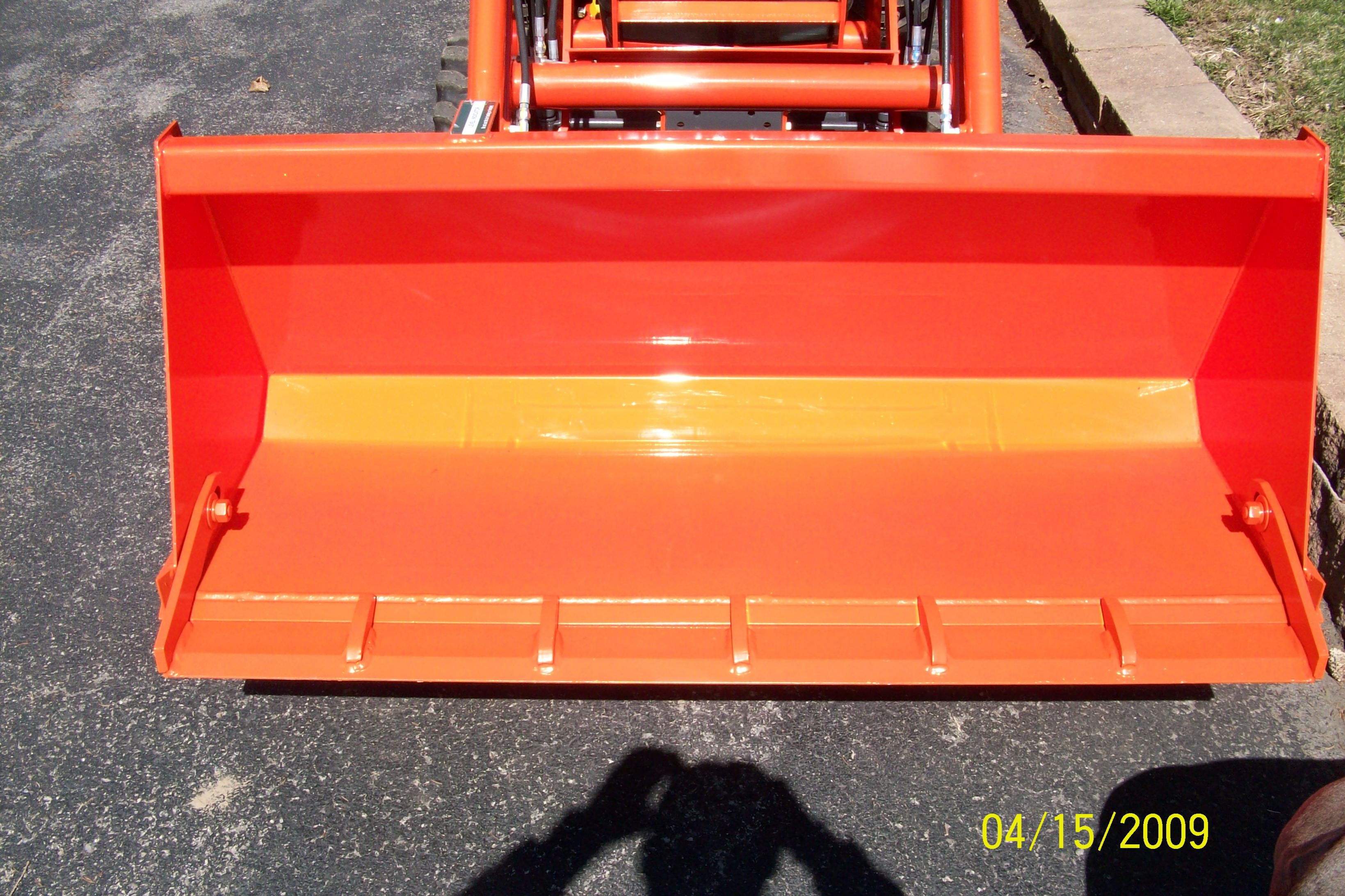

   / Heavy Duty Vs. Standard Bucket #18
I've ordered two of these heavy duty bolt on cutting edge's I believe from Messacks. One on a BX23 TLB and the photo is one on a B3200 TLB. Drill two holes, one on each side edge slips over existing bucket edge and tighten bolts.Real heavy duty and it works great.
