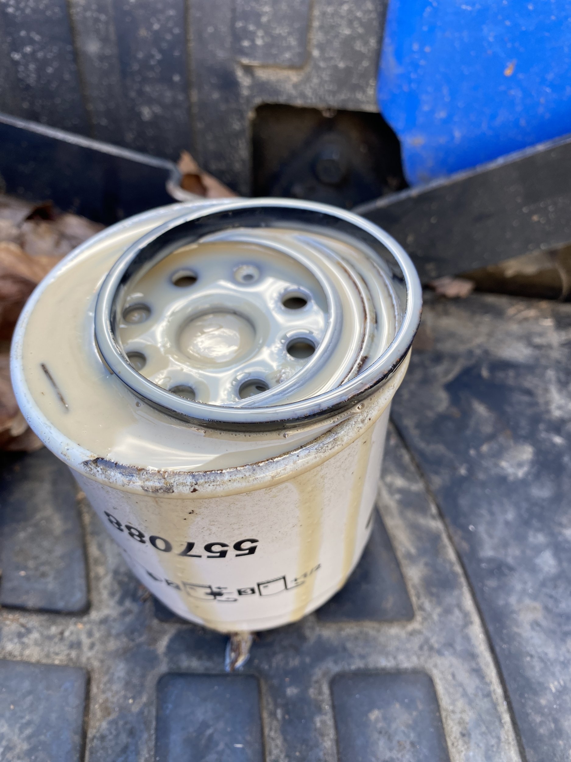

I had one hst filter gasket fail in -5 degree f weather. There was a TSB issued for filter replacement for States just north of me.
It is also possible that the gasket is doubled up causing the leak, but that is usually evident immediately upon use.
Even if the welding is not the leak issue, look real close at the whole thing. I see a cracked casing at one of the bolts.

Update for those following my adventure.. Unscrewed the filter, and the gasket appears to be in good shape, but it is not attached/seated into the filter itself (photo below).
Is this typical? Every filter I have ever taken off (cars, garden tractor), the filter is always well seated into the filter and never comes out.
I know, the oil is not supposed to look like that (first things first 😅)
LMK if you think this may be the culprit, or if it's common that the gasket comes off loose when removing an old filter.
I think to test whether the filter is in fact the issue, I'll get a new filter, install it, top off the oil and try to run the tractor a bit. If it holds up, I'll move ahead with draining and replacing the hydraulic oil. Advice welcome 🙏

My filters do not have a captive seal. It fits in a very shallow recess

Interesting post I came across... It looks like the filter I had on is the Wix 557088, but a few reports of blown gaskets are here, stating that the New Holland filters are built to withstand more pressure to prevent that from happening. Now to see if I can track down one of the more powerful filters...
Same here, I had been told to always look for the gasket to be left behind when changing a filter, but had never seen one in person in decades of changing oil... But the first time I changed my main hydraulic filter, the gasket was off the filter and stuck to the housing. Weird!
