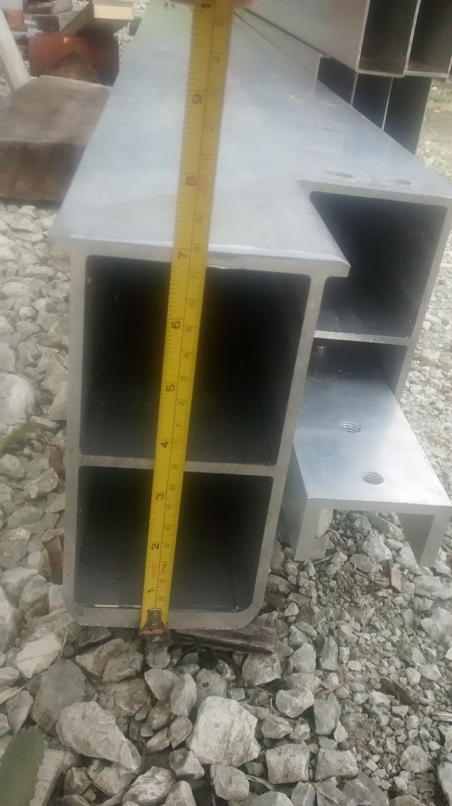

I'd love to get my hands on some of that stuff!
