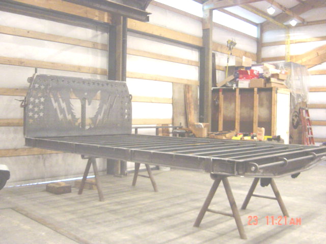

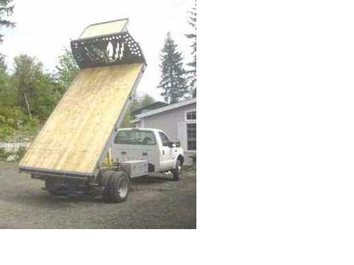

I had a 2004 F-550. I built a 14-feet flatbed dump. The dump unit was rated at 10-tons. But with an extra fuel tank I had to mount the dump unit closer to the rear axle. So it would only dump 5-tons. First trip to the gravel pit. Guy was loading the truck with a 988 CAT loader. I was watching the truck to see it squat. After a while I walked up to the operator, and ask how much weight he put on the truck. He didn't know. I went to the scale. 7 1/2-tons! Boy it's so nice to have a dump bed, but have to unload 2 1/2-tons with a shovel! :rolleyes:

Yeah SA, but you sure have a good dump angle on that bed by moving it back! If you can get it up, it's coming out, wet mud or otherwise!
