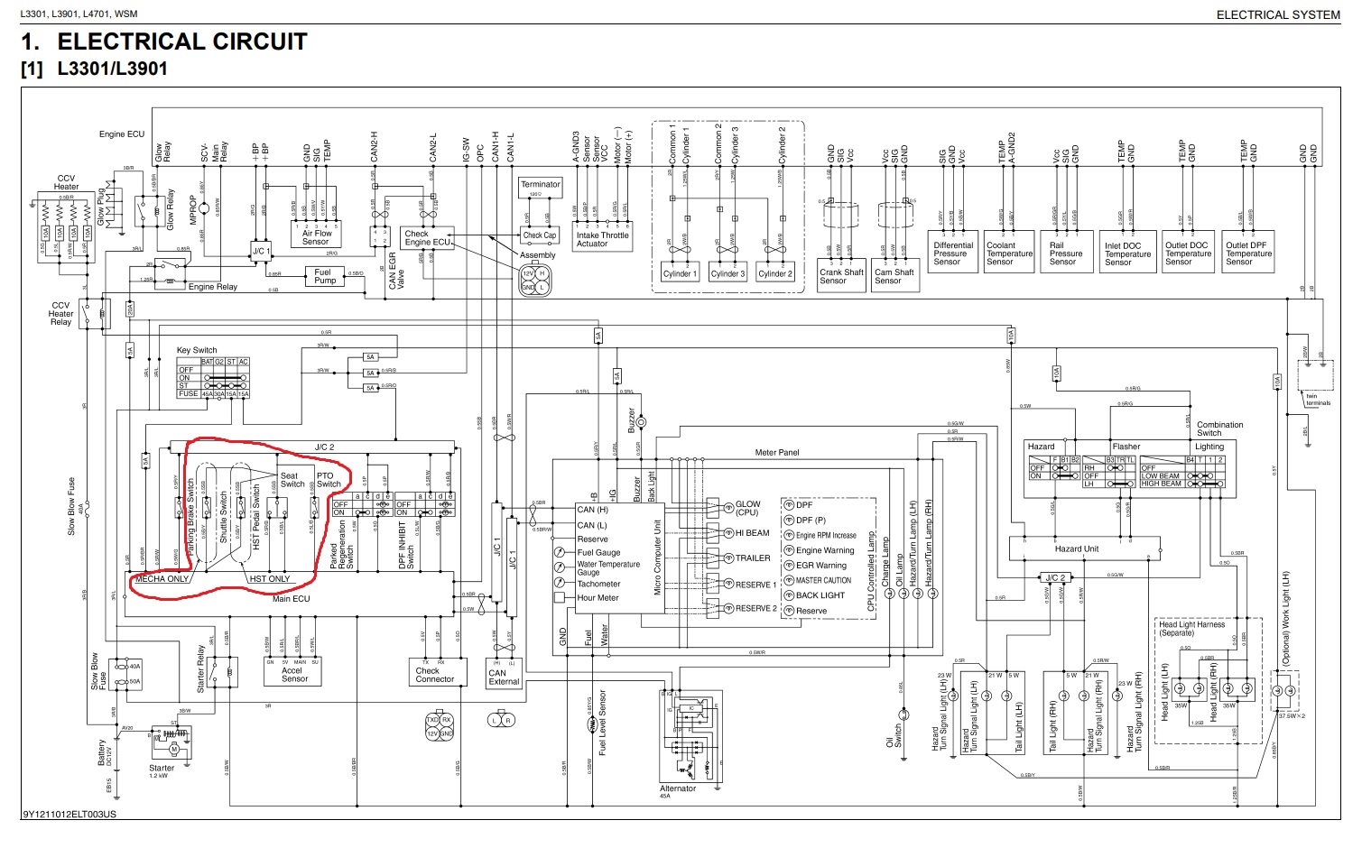

If this schematic is correct as you observed there is no safety switch for your clutch, however you do have a PTO, brake and seat switch. I would think any of these could be preventing you from starting.
Do you have power to your dash or headlights when you first turn the key?

Power everywhere else....all lights, including dash lights, glow plug light...etc..
So power is going through the ignition.....have to shoot it to see if it's leaving the switch in the start position to rule that out.
