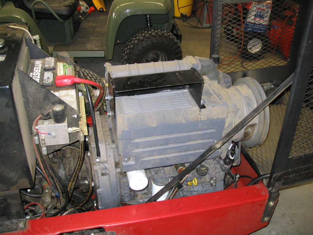

The stock air deflector outlet area is smaller than the inlet area. By building the deflector higher the outlet area size is increased to be equal to the inlet area.
