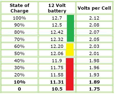

12.2 volts is only 60% charged:

Thank you very much for your patience and understanding . The last time I checked my voltage at the battery before attempting to start it, the battery read 13.73 volts . The starter is brand new and under warranty . When I tested the starter I
