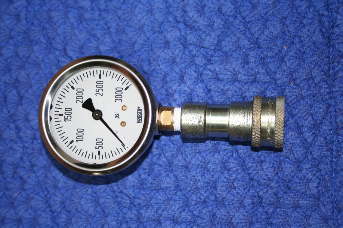

   / Hello to everyone bikeguy628 here Newbie in Tennessee #14
Foamy fluid could be caused by water in fluid which has been emulsified.
Suction leak will cause small air bubbles to appear, and mixed with the emulsified fluid, will cause problems.
I would recommend change all filters, use correct fluid. find suction leak if any.
Install a 3000 psi pressure gage in a tee in the FEL IN port to monitor and trouble shoot the hyd system.
