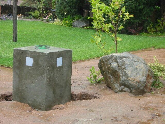

Here is what the Pole Base looks like this morning in the rain. The gray covers are Electrical Boxes. I plann on putting a spot light to display the flag, a street number on the street side and a flood light toward the house.

I like your choice of stone. We see some of that style out here. It has the "no mortar" look which ain't bad.
Check around amongst your acquaintances and business contacts to find if you have someone that cores concrete etc. If you don't then you're facing either having a professional service do it, formula is diameter times depth times dollar amount, cut some holes in some of your larger stones for holding vases. Or you can rent a wet drill and the sizes of bits you want.
What is interesting for me about coring is how the bits have to have different diamond content for the different hardness of stone or concrete. If you have a bit with a too coarse a cut rate then it won't do squat on a really hard surface. And if you use a too fine a cut rate on a soft stone it will fill up and not cut. It's comparable to using a rip blade to cut plywood or cutting studs with a plywood blade.
Let's pretend you use your stacked stone. But the boss lady would like to have a couple of plants on each side and maybe two to three on the front, just for grins you understand.
The stone doesn't like impact drilling. It isn't like granite who can take an impact drill and dance with it all day for fun and then wonder what's up for after dinner. So masonary bits with just water and a regular drill is the safest way to drill for pins in that kind of stone.
Pins? you ask. Let's pretend you have seven large stones drilled for vases or pots. You want them to protrude out from the rock wall and just stand there looking good, mostly because no one else in the neighborhood has such a thing, probably the best reason in the world to do something.
So very carefully you take the edge that's going against the concrete and you drill three--eighths or half inch holes into the side of your rock about two inches deep. You put rebar or all thread rods into the holes with about two or three inches sticking out. I like to use a hydraulic cement like quick rock, pour stone, etc as an adhesive to keep the pins in place.
When you've got your stone built up to where the boss lady would like to have a planter stone placed you use the protuding pins to mark the concrete. You drill matching holes and use hydraulic cement again to attach your planter stone to the wall.
It's a lot of extra work for just a little effect. But down the road when you walk out and see a nice clay pot sitting in the rock work with moss roses or some other gorgeous flowered plant dripping down looking absolutely gorgeous, well, it wasn't really that much work at all. And it is the only one on the block. /forums/images/graemlins/smile.gif
And it wouldn't take too much to take the principles I've laid out to disguise your light for the flag with the same kind of technique. A small halogen low voltage spot on three sides just coming out of nowhere would be a very special look.
