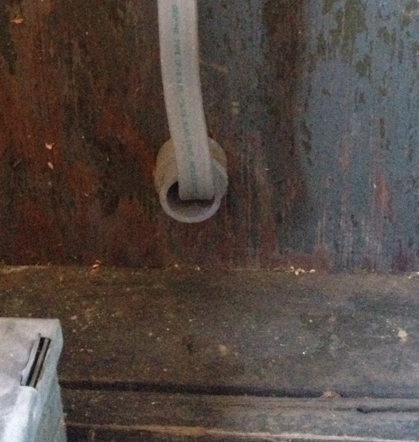

..protected the NMW cable supply at the bottom of the panel from mechanical damage.
supplyfeeder.JPG Heres the 10/3 feeder coming into the garage from the 30A breaker(s). It goes direct up to the panel (36 inches). Plastic conduit and fittings are easy. Thanks very much for that.
Only one wire per box connector. Not three cables through one connector as the top left .
2 cables:D. Probably ran out of clamps. But will fix that ASAP
