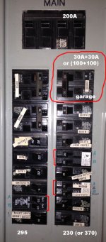

Yes that's what I meant. I'm quite happy that there are just 2 more steps to be compliant (but I'm not planning to change anything). My understanding that the (minor) steps needed to bring it up to code are:
-remove the 30A and insert a 100A double breaker in the main house 200A panel
-change #10 feeder wire to (the proper size) to the garage subpanel.
====== BUT BEFORE I COMMIT THIS TO MEMORY ============
If electricians are willing to give this a look, I'd like to clarify this issue of "200A service" and adding "100A breakers to supply the subpanel.
Here's a pic of my house panel currently, with totals at the bottom. Since passing the inspection, I've added the 30A garage '(230v double) and 3 smaller "doubles" over the years, and thought (each time) that I was "pushing it" and someday I'll reorganize and take the doubles out. I had good excuses though! For example I wanted a dedicated circuit for the sump pump in case the basement flooded. I wanted the refrigerator and the freezer on a low-usage circuit (separated from dishwasher). And I added a central vacuum, which was 12A itself.
Someone said that I wouldn't have to upgrade the 200A service to add a 100A subpanel. If this is still 'true' then I am preparing myself to be amazed. Here's a pic of my house panel, just to make sure we are talking about the same thing. Really appreciate you guys giving me your time.

   / Help adding 230v outlet at subpanel in the garage #39
Well, for one, the 30 amp breaker for the garage is only 30 amps, not 30+30.
Your main 200 amp breaker is 200 per leg. So to really be accurate you could add up each individual draw off each leg and theoretically they should be close to balanced... but it doesn't matter anyway because you can total more than you main.
Each circuit needs to have wire size appropriate for it's respective breaker, but not all circuits are going to be pulling full load all of the time. But if you have enough of the circuits pulling enough load that they total 200 or more then the main trips. (Highly unlikely)
You could have 100 20 amp breakers (2000 total) but each circuit is only pulling 1 amp, then you are really only at 50% capacity.
   / Help adding 230v outlet at subpanel in the garage #40
By code you could have a 200A service feeding a 200A panel, then a 100A breaker feeding a 100A sub feeding a 100A sub ad infinitum
