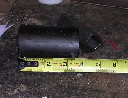

I cut off 3 and 5/8 inches of the shaft and cover to use
the KK cutter on my BX-22. This is the TG-48 not the XB!
(see attached photo for shaft cut). Pictures of the tiller are
on my webpage via my profile.
