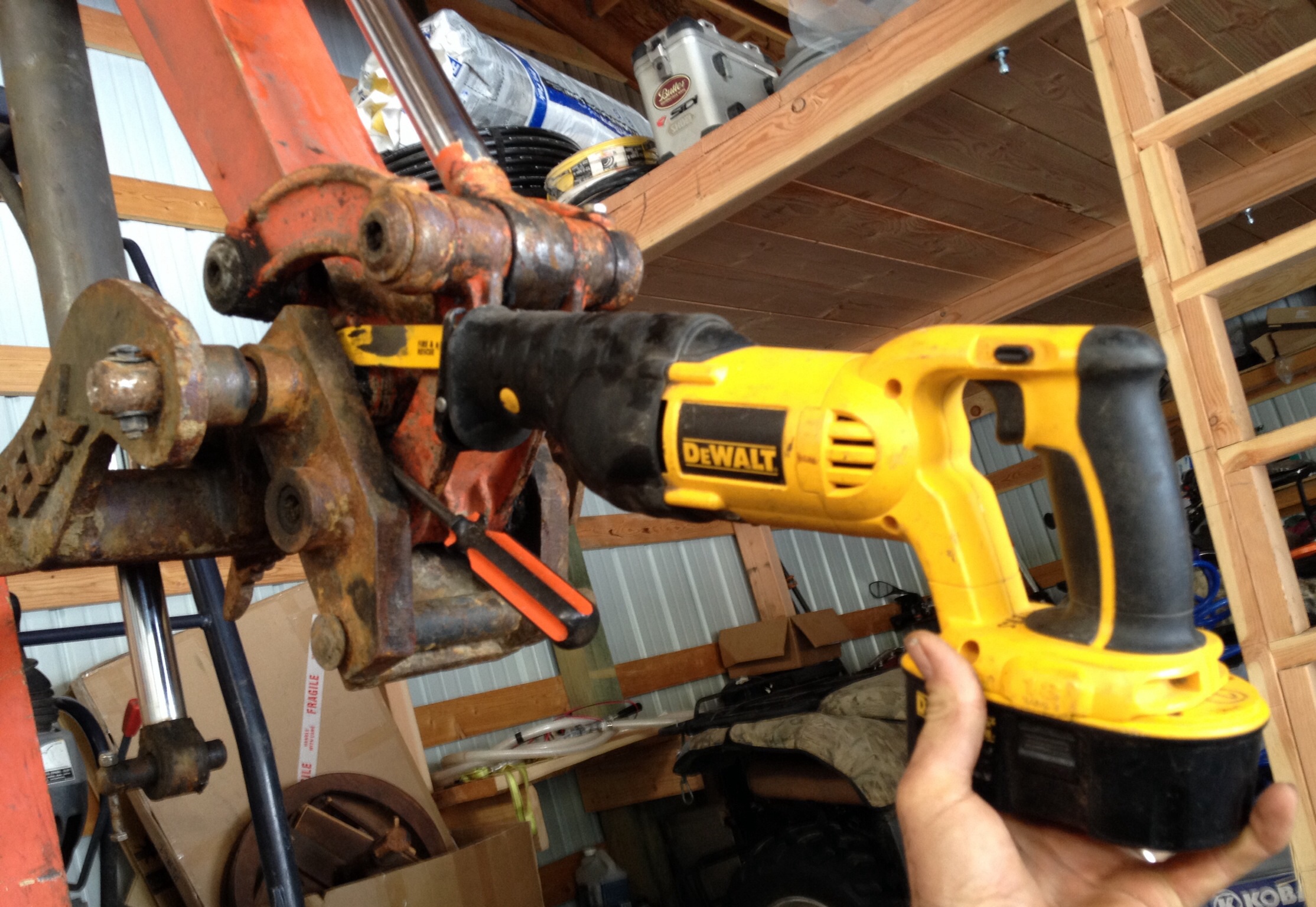

So I goofed around with the hydraulics for about 20 minutes then realized that since all the hydraulics available?.ALL pivot around this same pin there isn't much opportunity to put a force on the pin the way I need it to go. (Actually there IS a way, I figured out out what action bent the pin, so it seems I could rotate the pin 180deg then? dang thought of it about 18 hours too late!)
SawZall out and one 18v battery later, the pin was cut. It did NOT cut like hardened steel, the saw was pulling hard and sawdust was flyin'. I was all ready with 4 batteries, and it only took one battery. But it was so bent it still wouldn't come out so I had to cut it again. I changed batteries for the second cut and that one went even faster. Or maybe I have one wicked Sawzall?.or the pin was about as soft as steel gets. The 14" pin was bent about an inch high in the center at 7" (and a surprisingly sharp bend).

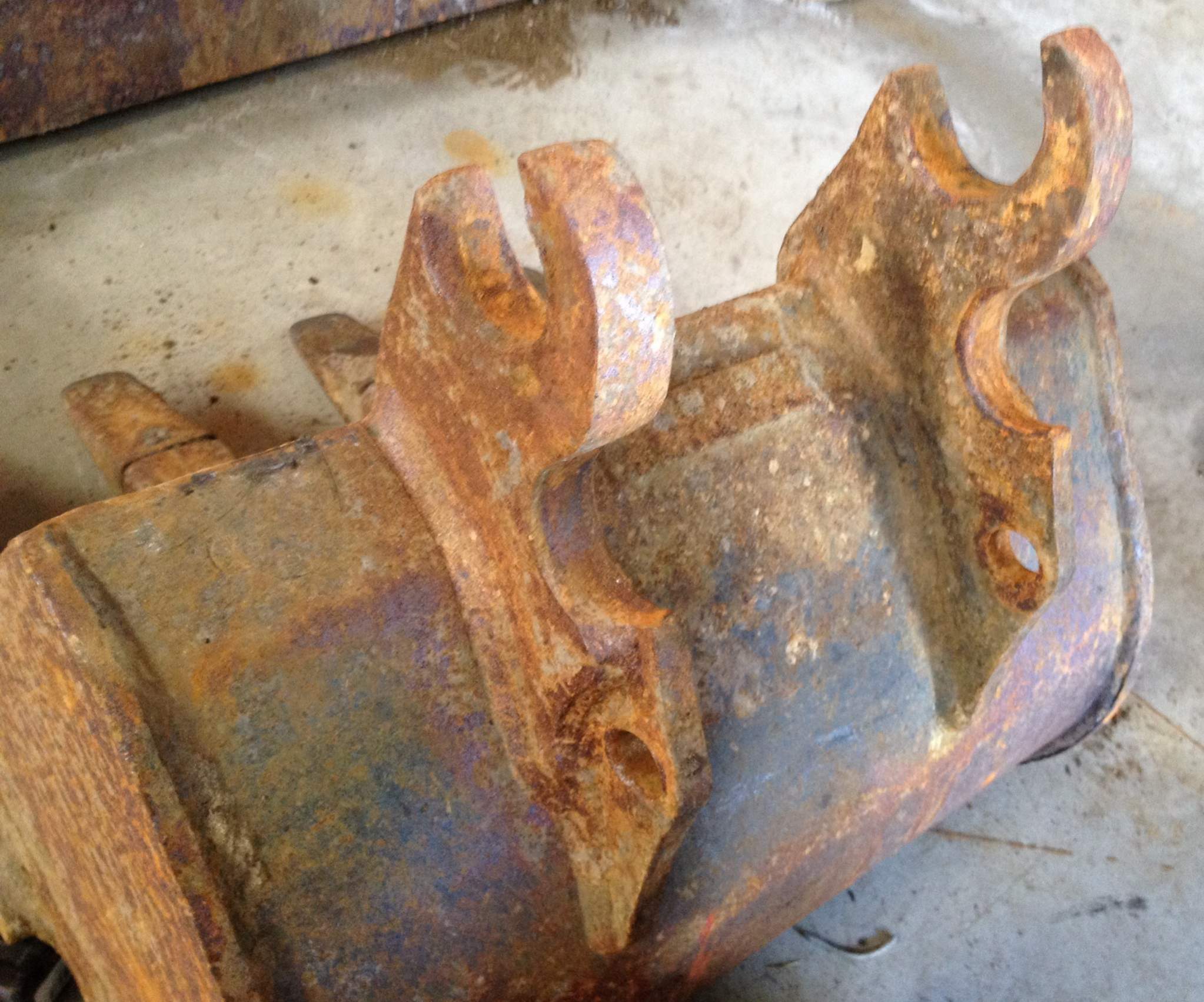

With the bucket off, I noticed the quick-release clevis (on the bucket) was spread out almost 1/2 inch! The problem was getting a little worse at this point so I called a buddy in town with a repair shop to ask if he had a hydr press. He said "maybe 40 ton, what do you need?" I explained it and he said bring it in so I loaded the bucket & thumb on the snowmobile (!) & headed to town. Well 50% D.I.Y. Is better than paying for the whole repair.
attachment.php
Pic of the quick-attach lugs on the bucket. The clevis plates are 1" thick steel and are spread 1/2" wider at the top than at the root. I'm quite happy that the whole bucket/thumb area is reasonably simple to tighten up.
That 1" plate was a bit more than I wanted to bend and you can see in my pic with 2 feet of snow theres no place to build a fire.
