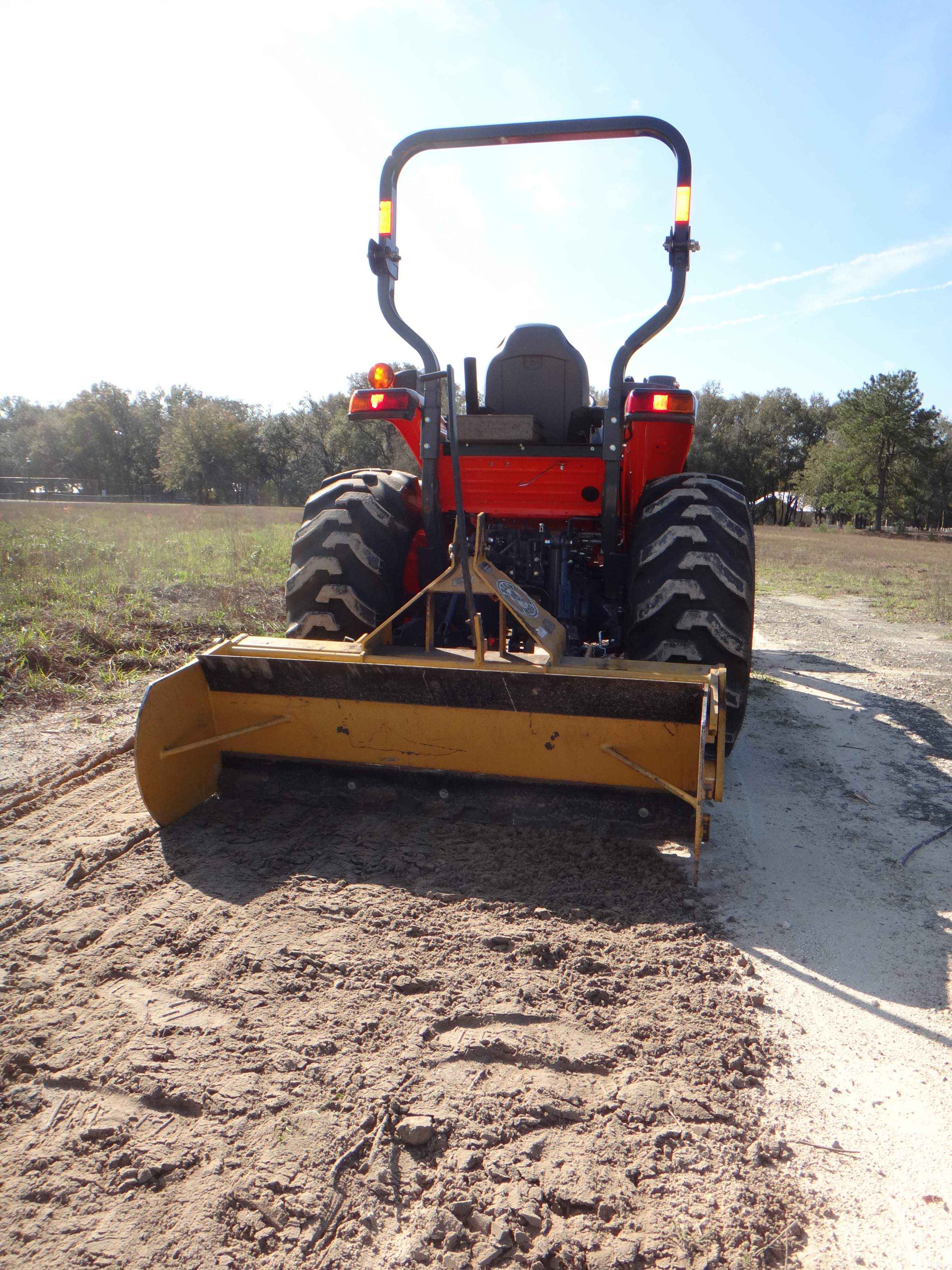

In this series you have HST, Category 1 Hitch, weight and small size plus all the bells and whistles piled on as standard. I paid $27,500 for my L3560 with a number of personalized options. As the years past the easy connection to implements provided by the telescoping Lower Links and pinned stabilizers will save your body and keep you on the tractor years longer.

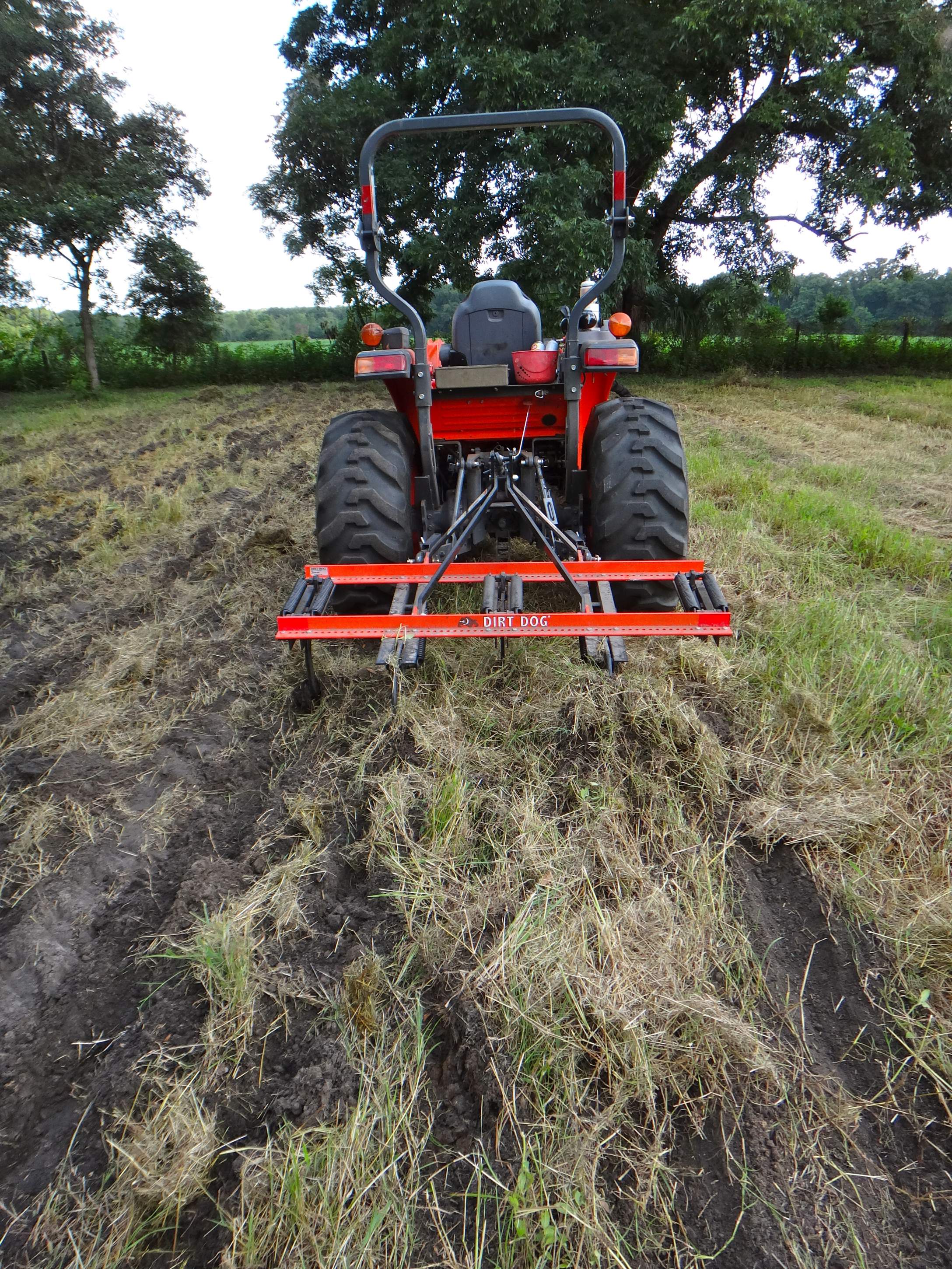

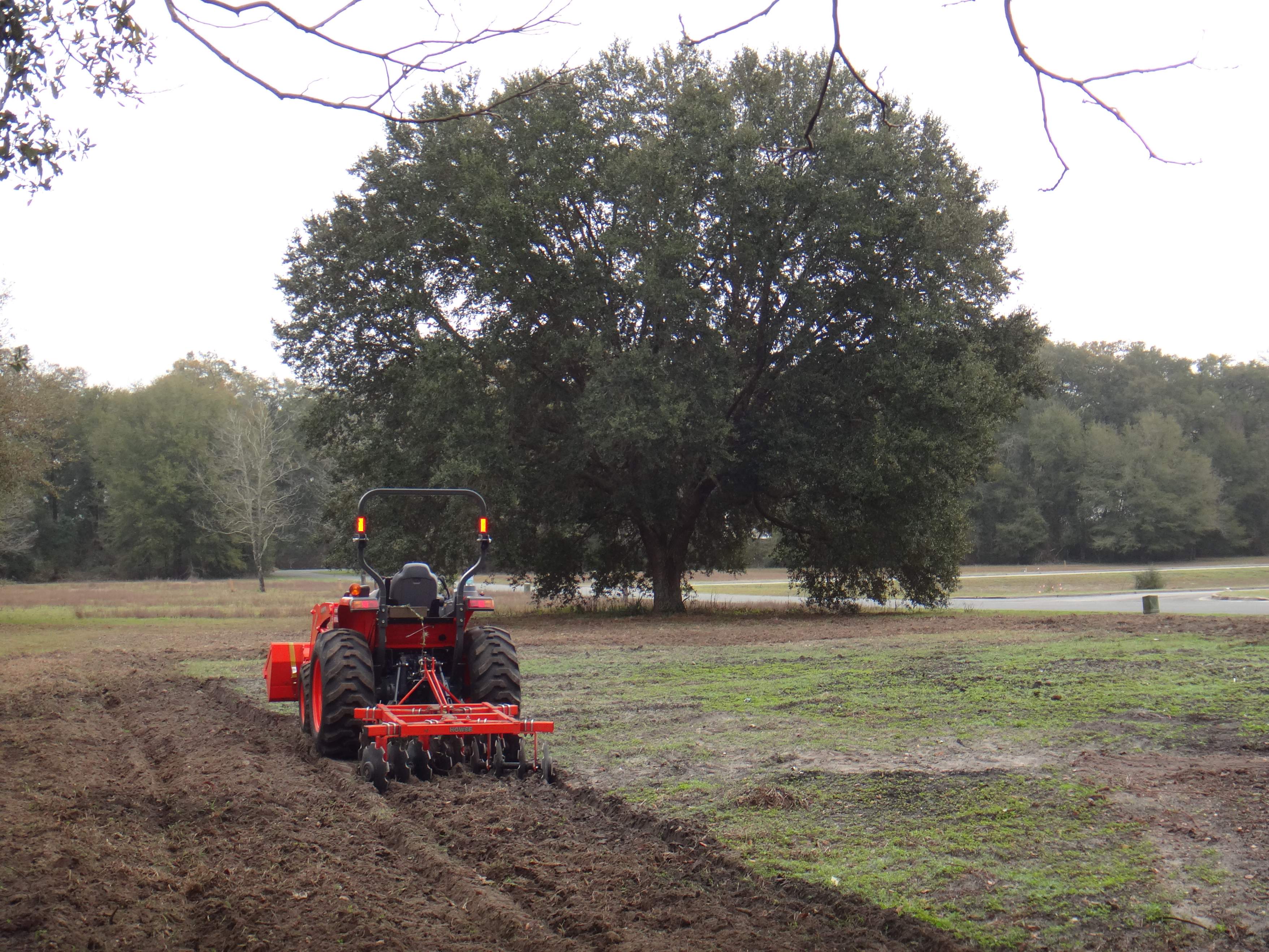

I work in woods two or three days per week with my Grand L, L3560 ~~my second new Kubota.
