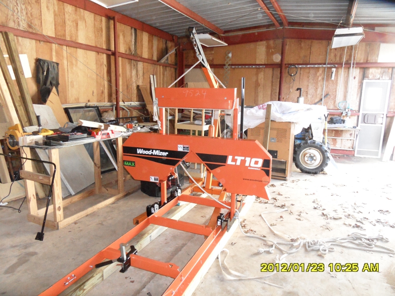

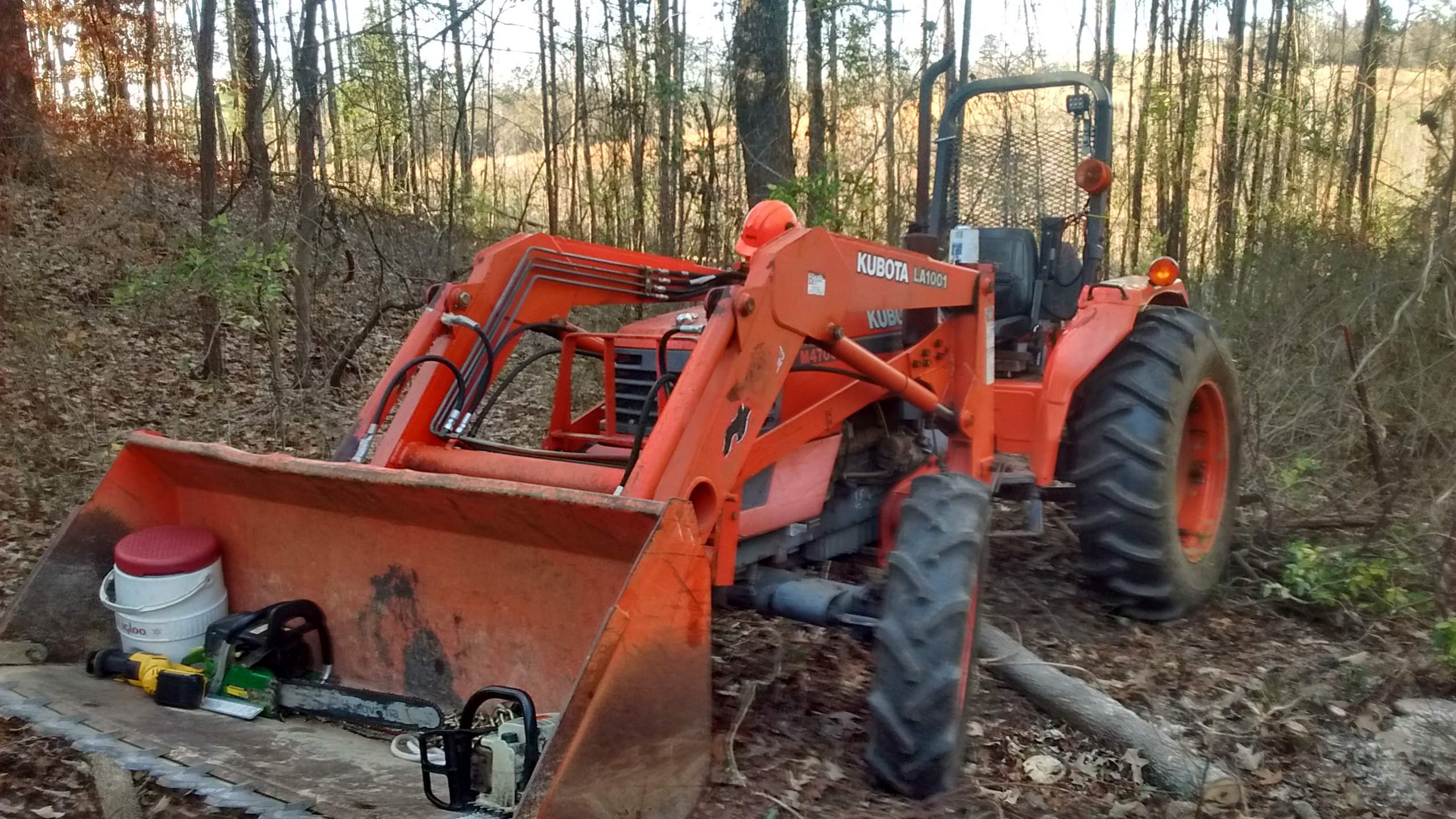

I've 2 tractors, a 2007 B7610 bought in '09 with 300 hours on it and a 1995 M4700 w/ < 1500 hours on it. I do my own fluids, filters, grease, hoses etc.
My B7610 went to the dealer once for rear remote and a backhoe. I had to rent a trailer ($65) for a day when I picked up my $12,000 M4700 because the wheels were set to wide for my trailer (later I narrowed the wheels).
You've picked about the right size tractor. My M4700 does great in the woods. For me much bigger would be a pain to maneuver with little gain.
attachment.php
I envy being able to spend that much on a new tractor, but my usage (< 500 hours a year) wouldn't justify it because I couldn't write it off on taxes. And I needed lot's of implements (chipper, tiller, plow, pallet forks, rotary cutter, etc.).

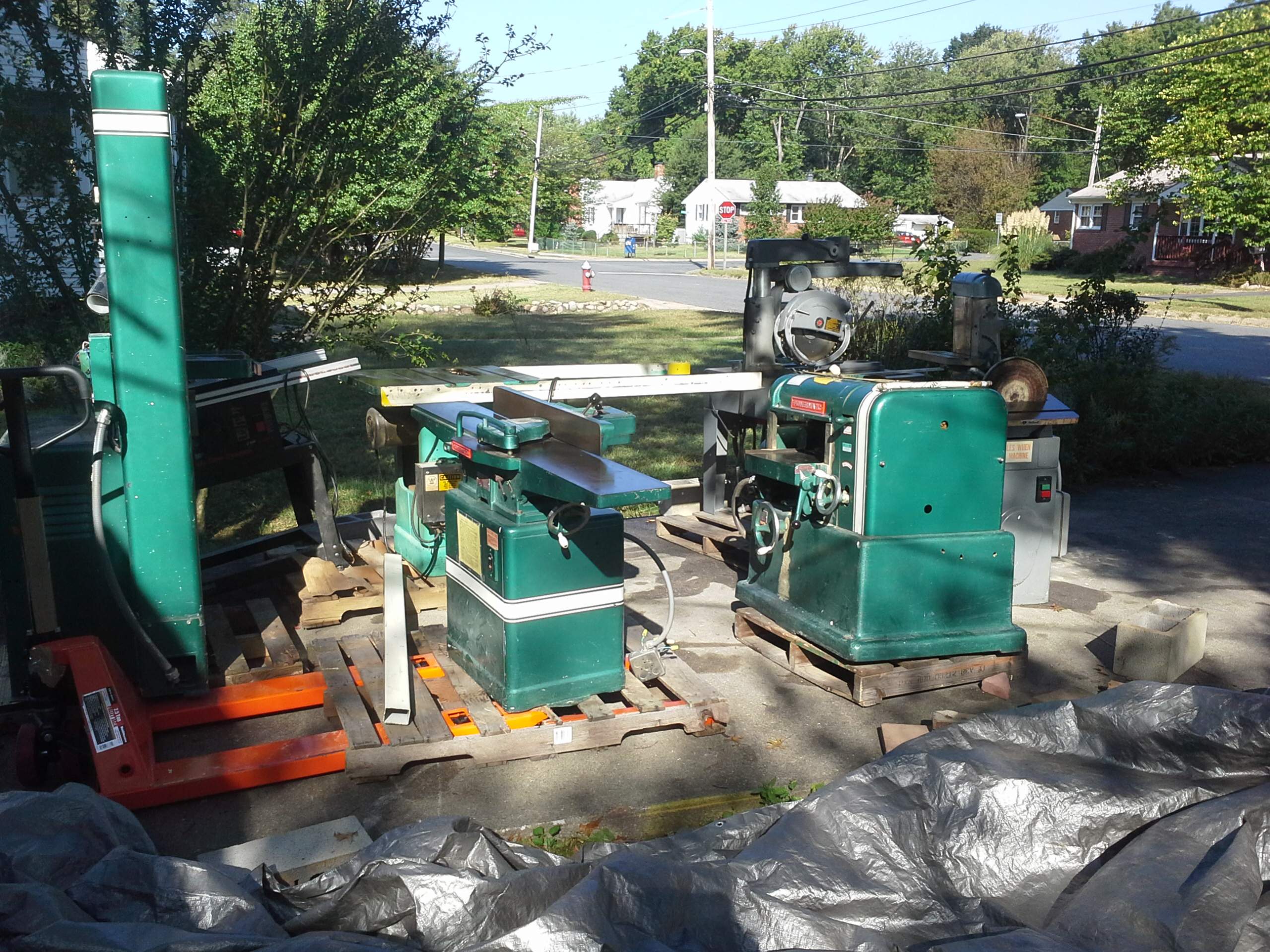

Plus several chainsaws, a sawmill
attachment.php
and a few woodworking tools.
attachment.php
After all, what's a tractor good for if you can't process what you bring home?
