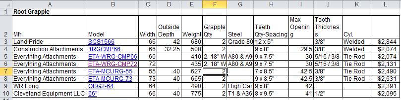

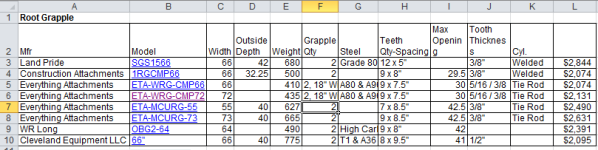

I also Have an EA Wicked and like the design, and the company. If I were ordering one right now I would go for the EA Utility Grapple for my tractor but it wasn't announced when I got mine.
Here is a spreadsheet I made up last year and I added the EA Utility models to the list.
What do you plan on doing with the grapple? I looked up the brand / model you mentioned. The design is very different from what I have. Probably good for picking up one log at a time and for tearing roots out. Probably looses a lot of brush carying capacity by having no bottom tines.
