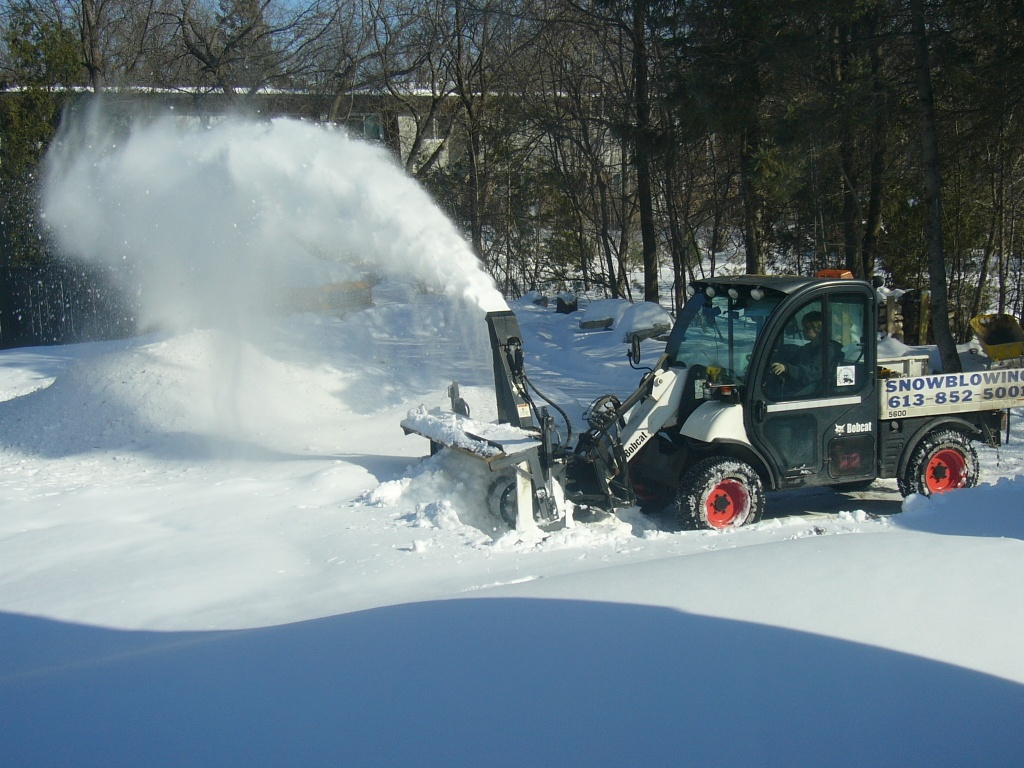

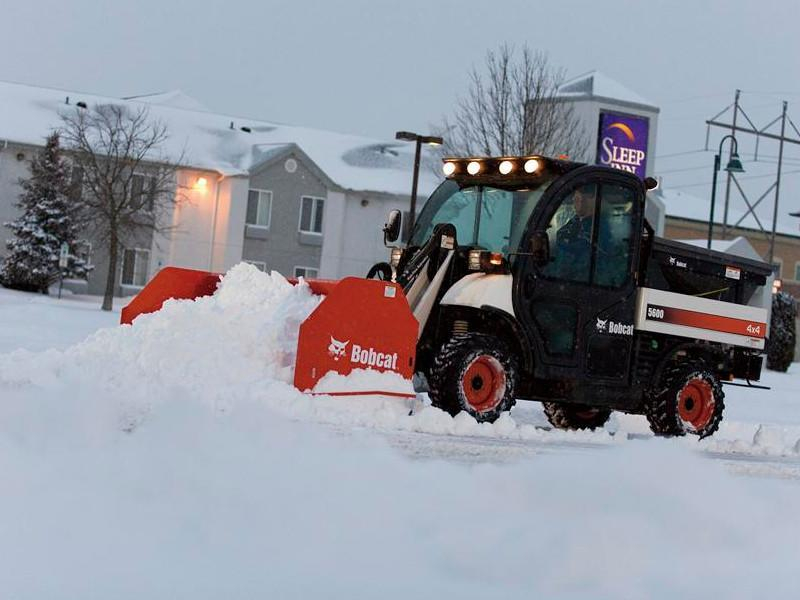

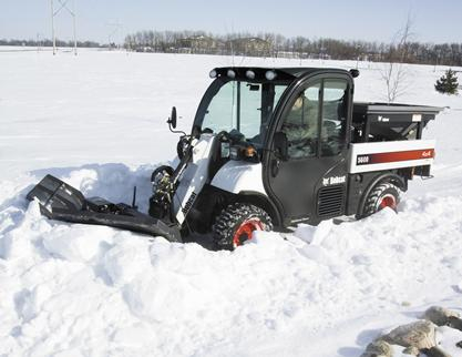

A machine that could handle both duties is the Toolcat from Bobcat. It is used by many commercial snow removal companies.

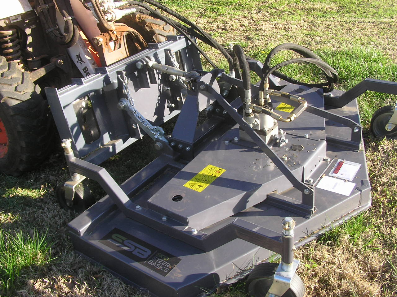

I don't need it for snow removal, but do use a 5610 for Mowing with a 6' finish mower:
Or the 7' brush hog:
See what else it can do here: Toolcat 5610 F and 5610 G Series Pictures
