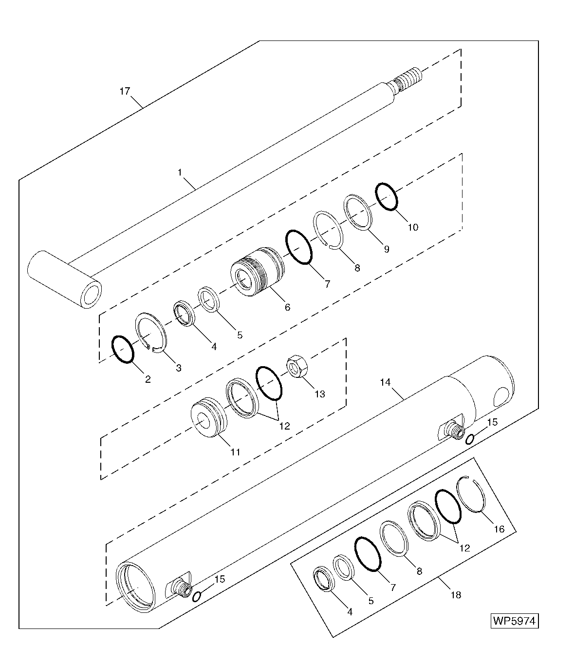

I am hoping it can be welded back on somehow so with that in mind I've removed the cylinder and the snap ring thinking that the piston rod should come out, but no luck. Dealer says a firm smacking pull should do the trick but I've done that with the other end secured firmly and nothing moves. In fact looking at the slot and the ring I'm puzzled as to how that ring retains anything.

IIRC, there's another ring holding your cylinder together.
I'll attach a drawing so you can see the parts I'm refering to.
I think you've already removed the outer ring, item #3.
Once you remove this ring you must push/gently drive the gland back into the cylinder barrell so that you can access the second ring, item #8.
After you remove the second ring, you should be able to pull the rod and gland out of the barrell.
Item #3 keeps the gland from going back into the barrell. Item #8 is what actually prevents the gland from coming out of the barrell.
Hope this helps.
Mark

Jack,
Looking at that diagram again, I may be wrong.
They show item #8 as a split ring in one place and as a solid ring that's part of the packing kit in another place.
Easy way to tell is ... if item #3 goes in a groove on the outside of the gland, you'll have to follow the procedure I described.
If item #3 fits in a groove on the inside of the barrell, you should be able to remove item #3 and then pull the rod and gland assy out.
Sorry for the confusion!
Mark

Thanks very much for the recent posts, guys. They are most helpful, especially relative to getting the cylinder apart. If I do just that, I may need a comment regarding the second snap ring and that "special tool or ring" that was mentioned in an old post.
For now I have a small bearing endcap that is close to the right bore that I will resize. That will mate with a square block of steel that's getting machined this morning that will form the other half of the circumferential collar that will have the nipple fitted to it. With the paint removed and a close tolerance fit I am confident that I can get a good seal over the hole where the nipple broke free. Because this break is so close to the end I'm hoping that there is no distortion.
