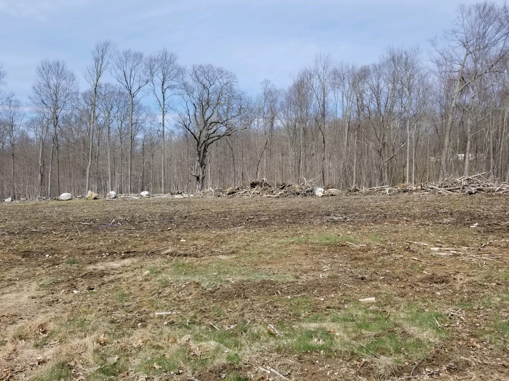

Started looking at tractors and realized I don't know where to begin.
I have about 5 acres that will need to be bush hogged, and piles of stumps/brush/trees/rocks to move. It was recently cleared and leveled with an excavator but not perfectly graded with a dozer to give you an idea. Eventually would like the 4 acres to be grass/hay field. It's pretty rough right now with old roots and rocks in places. Also the land is a 5 acre rectangle and drops about 60 feet in elevation over a 500 foot distance, 7 degrees? Some wet areas so I do want 4x4.
So how much tractor do I need? Would like a cab and I'm guessing 6 foot bush hog that would take a few hours to cut? I have a 1500 foot gravel driveway that will need repair. Will a tractor have the power and lifting capacity to drive into a log/tree pile like a skid steer with a grapple?
I'd buy any color but if kioti,massey,mahindra,ls,yanmar turns out to be a couple grand less than a kubota on say a 40k tractor I'd probably go kubota. If it was maybe 5k or more savings than maybe not. I have not got an idea on all the prices. Most of the websites it looks like you need to get a quote. Definitely not as easy as truck shopping.
I saw a 2013 7060 with around 700 hours for 38k I think on the kubota website tractor/loader is about 50k msrp. I'm guessing that will be enough tractor but would a 35hp 30 pto hp work too? I'd rather buy used but if I went new is there a kubota dealer where they give the most discount off MSRP? I think I heard barlow before. If buying new I'd drive a day away to get the best deal. Even knowing I may not get great warranty service from a local dealer.

A six foot Bush Hog cutting moderate length dry grass requires forty-five tractor horsepower.
A six foot Bush Hog cutting long grass or light-medium brush requires a fifty tractor horsepower.
As you have hills and desire a 800 pound cab, I recommend at least a fifty horsepower tractor.
A six foot Bush Hog cuts around 2-1/2 acres of grass per hour, mowing flat land, probably two acres of grass per hour with your hills.

Thanks, Only about 7 acres but almost 1 is the driveway area 50 ft by 1500. Looks like I got a lot research to do on weight of the different tractors. When looking for a mini excavator that's pretty much how I would start the process by weight.

I will simplify your research: 3,700 pounds or more, bare tractor weight.
VIDEO: *New* Kubota MX6 & MX54 Utility-Compact Tractor - YouTube
Few cab tractors will pass under an 84" garage door header.
