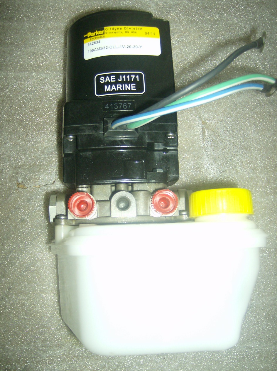

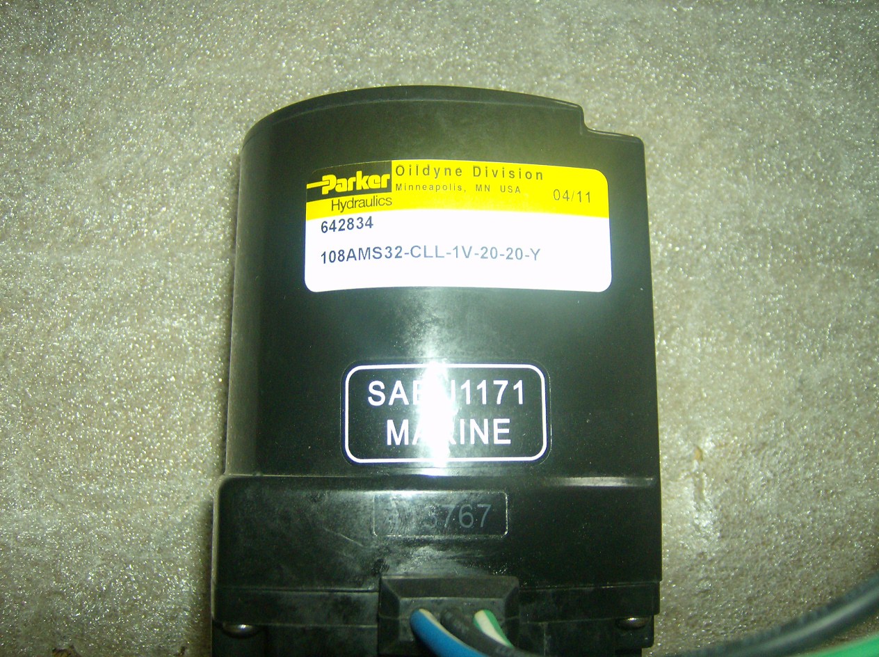

I got this pump from another guy. I'm thinking about using it on a trailer, but I'd like to know the pressure and flow specs on it to help plan the trailer. I tried to look it up, but only got one hit in German and one in Chinese.
I wondered if the specs are somehow decoded in the part number. I figured if anyone knew it would be someone in this forum.
The pump is a boat trim pump from Parker Hydraulics, Oildyne Division.
642834
108AMS32-CLL-1V-20-20-Y
Thanks in advance for any help.

Parker Hannifin eConfiguratorTM
Sun Jun 19 2011 18:24:25 GMT-0500 (CDT)
Model Code: 108AMS32-CLL-1V-20-20
eConfigured Product Summary
Series 108 Power Unit - includes relief valve(s)
Motor Selection AM = 12 vdc, Series Wound
Pump Type S (standard)
Pump Size 32 = .327 (.0321 cipr displacement)
Reservoir Size C = 46 cubic inch (26 cu. in. usable)
Circuit Type LL = Reversible Locking circuit (dual POCV)
Ports Size 1 = 7/16-20 (SAE-4 O-Ring)
Mounting Orientation V = Vertical mount (motor up, reservoir down)
Relief Valve Setting for LH (UP) port 20 = 2000 psi
Relief Valve Setting for RH (DN) port 20 = 2000 psi

God oldnslo I have worked with these pumps for years and never could find out all the spec on them. I have had many apart for repair.
Iplayfarmer; It well be way to slow for you. On the merc I.O,s the cyl is only 1" and it runs 2 of them and it is slow. I can tell you its a gear pump and the gears are about the size of a dime, maybe a hair thicker.
I'm planning on running 2 cylinders that are 1 inch. They have a 10" stroke. It's for a tilt trailer. I don't need a lot of force to tilt the deck. I need to go back through oldnslo's specs and see if I can calculate flow from any of those numbers. There's a cubic inch per displacement number in there, but I don't see a displacements per minute number.

For once I did a search and actually found what i was looking for on the 1st or 2nd attempt. I am going to try and attach a pdf document showing some of the info on these units. They have a limited duty cycle so try not to operate them for extended periods of time. I could not find any exact specs on what the duty cycle is though.

I took a look at that attachment, and on page 7 there are some charts with flow data. It looks like my pump with a .327 motor and 2,000 psi relief has a flow of about 100 cu in./minute. My two one inch rams with 10 inch stroke take almost 16 cu. in. That means it will take 0.16 minutes or about 10 seconds to tilt the deck.

1) are the cylinders on your tilt trailer going to be single or double acting? If single acting you will still have to run the pump to lower due to the dual Pilot operated checks. You may also have to install some form of flow/speed control on the lower to prevent the system from chattering. The chatter can be caused if the trailer free falls dowm mometarily. The check closes, pilot pressure builds, check opens, trailer free falls, check closes, etc.
2) Pump flow varies with system pressure. These are usually inexpensive motors where the RPM varies with load. In your case I would guess the time to tilt would probably less than 10 seconds under most conditions.

!st off your trailer is a lot bigger then I had in mind. Anyway the oildyne pump took a #2 stern drive up in 10sec. and down just alittle faster, but was real close to the 10sec.
That #2 drive cyl. are bigger on the out side from a #1 drive so would guess piston is no bigger then 1 1/2". Sten drive cyls. have a floating piston and a piston on the shaft and that one has check valves in it. The reason for that is when something is hit the check valves open, also the floating piston and other check valves let it return to where it was before it hit something.
I think you might find it well take a little longer with the 2" cyl. but does that really matter? I think the pump would work out for you. Oh by the way the strock is 10" just as yours are.

Never had one of these units apart so I don't know for sure. Only concern that I can think of thick fluid may not flow into the pump and cause it to cavitate. But this is a potential problem with any system. Isn't this just a big brother to the units used on snow blowers for chute control?
