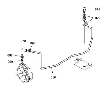

   / HELP! Did I do something really bad to my B7300? #35
Climber.
Just some extra info so you know why/what you did when trying to bleed your hydraulic systems. First is that your tractor hydraulics is powered by a pump that is driven by your engine(located at the front of the engine). This pump shares the same resivour that the HST unit uses. They tell you to disengage the clutch so you can bleed the tractor system pump first(this powers your 3-point, loader, steering). Then when you engage the clutch it then starts driving the pump on the HST which will then bleed by itself as well(along with cycling the pedal). By doing one first then the other it just helps eliminate problems with excessive air in the fluid. Just thought you'd be interested.
   / HELP! Did I do something really bad to my B7300? #36
a small amount (0.5 gpm) of fluid from the engine driven pump is fed at a constant rate to aid in charging the transmission pump. there is also a charge pump driven from the clutch, but they want all air out of the hydrostatic transmission before things start turning.
   / HELP! Did I do something really bad to my B7300? #37
<font color="blue"> a small amount (0.5 gpm) of fluid from the engine driven pump is fed at a constant rate to aid in charging the transmission pump.</font>
This is incorrect. The tractor hydraulics delivery circuit is completely separate from the HST unit but they do share the same resivour. The engine driven pump(tractor hydraulics) is directly connected to the priority/flow divider, the flow divider has one line that feeds the 3-point control. The suction line is connected to the transmission case. The HST unit does have a charge pump located at the front of the HST unit. It is driven by the HST input shaft which is connected to the driveshaft, this part is correct. The charge pump on the HST unit is what provides the necessary fluid for internal losses within the HST unit. The tractor hydraulics pump does not provide this functionality.
It should have been stated:
<font color="purple"> a small amount (0.5 gpm) of fluid from the HST charge pump is fed at a constant rate to the pump/motor circuit within the HST unit to compensate for internal circuit losses.
</font>
I hope this clears things up.
   / HELP! Did I do something really bad to my B7300? #38
I beg to differ - The B7300 IS different in the way they divert (flow priority valve) this flow. Do you have access to the hydraulic circuit of the B7300 hydro? I can e-mail you a jpg if you want.
   / HELP! Did I do something really bad to my B7300? #39
Yes is I do have the diagrams. The first one shows the separate tractor hydraulics, the next one shows the return to tank lines.
   / HELP! Did I do something really bad to my B7300? #40
2nd
