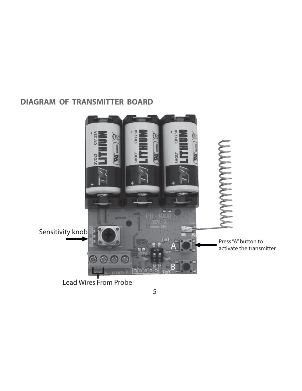

I just recently installed the Dakota Alert DCPA 4K that uses the buried vehicle probe. The transmitter and receiver are located about 1/2 mile away however the transmitter is at the bottom of a hill and my alerts are spotty. Maybe 50/50 success rate at best. I know I can move it closer to the house however this is the preferred location due to being in a place in the drive that cars cannot go around it and also allows more time to alert us to incoming vehicles. In talking to Dakota support they cannot make recommendations due to FCC limitations. I know about zero as far as radio.

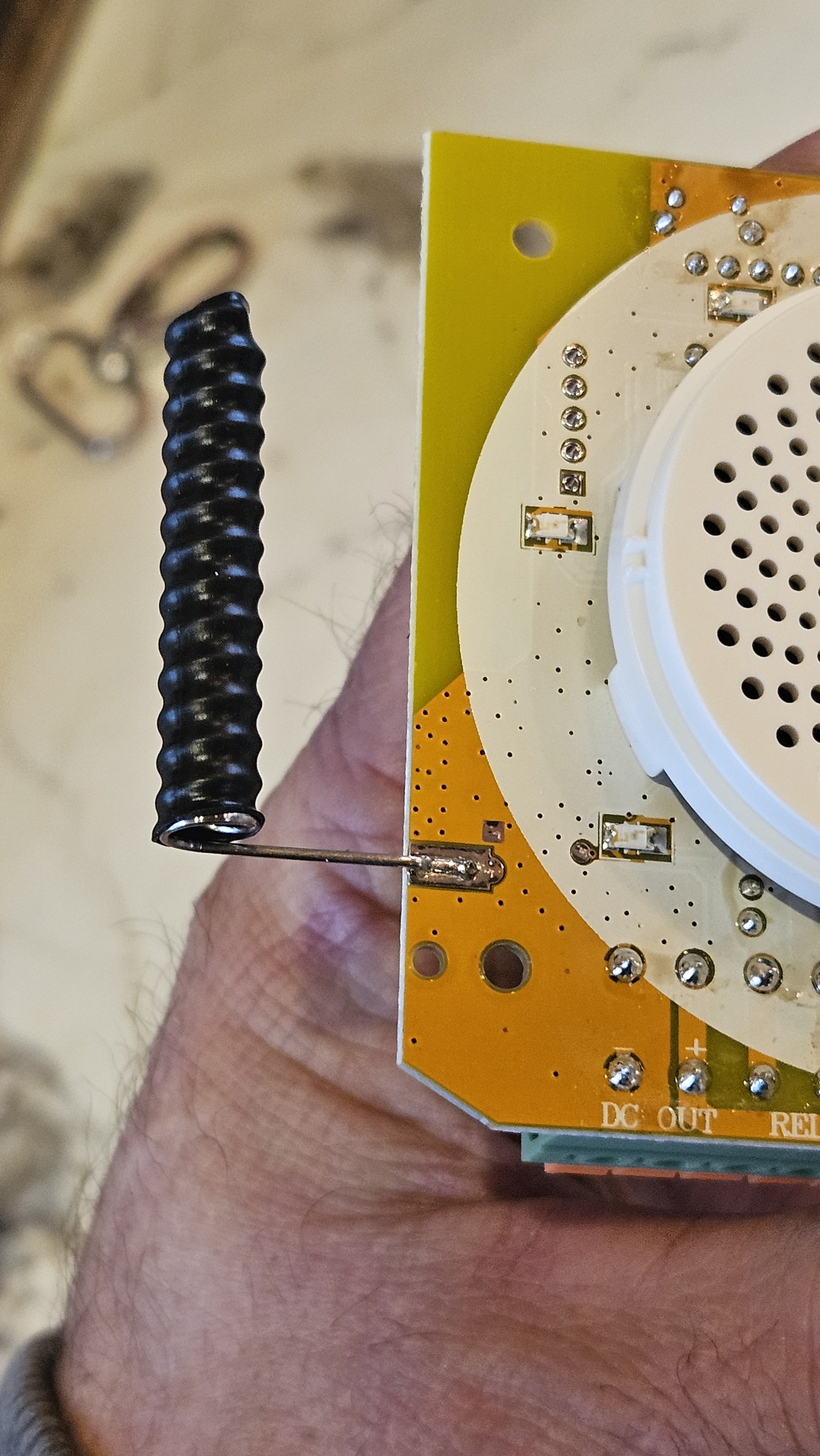

It looks like both the transmitter and receiver uses a helical internal 433 MHz antenna. The receiver antenna is about half the size of the transmitter antenna. Each antenna is soldered to the board and would be fairly easy to solder in a different antenna. Pics of each attached. Although both antennas are internal it would be easy to modify the housings if needed for an external antenna. So...............
What recommendations can you give me? Add a better external antenna to the receiver, transmitter, or both? And what antenna would you recommend? Because I am getting some alerts I don't think I need a huge bump in signal. Appreciate any help.

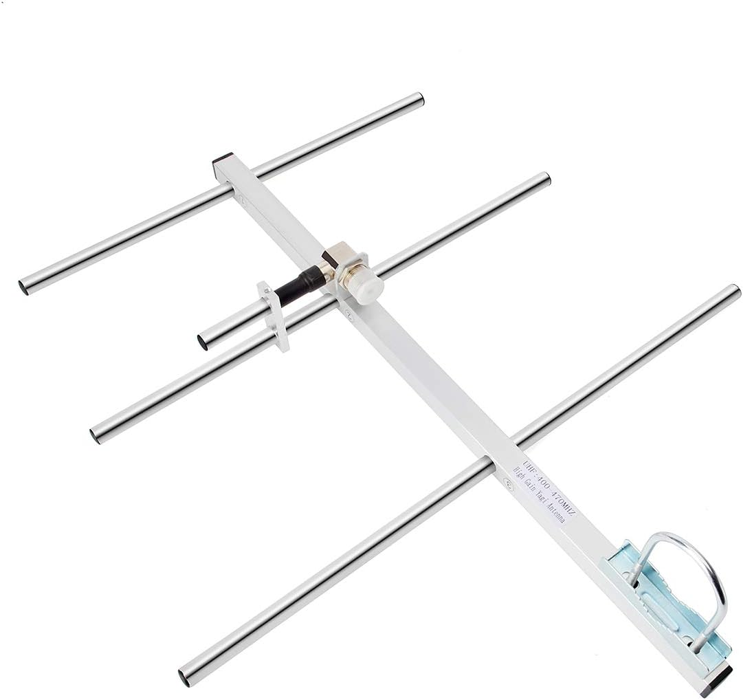

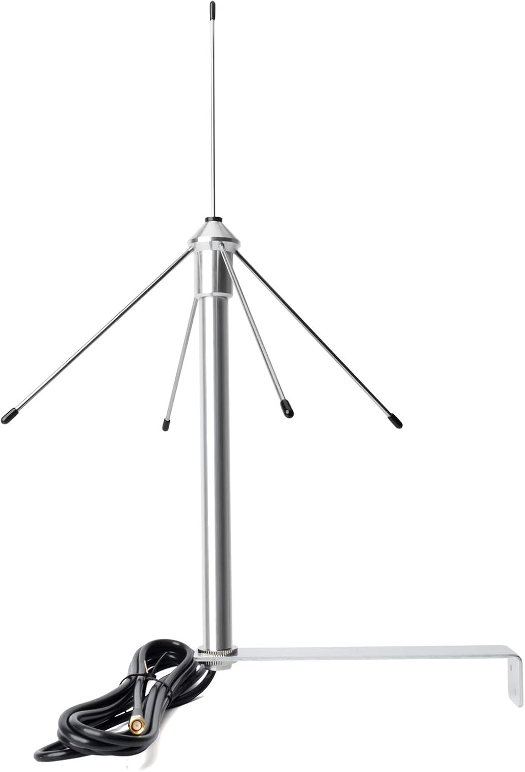

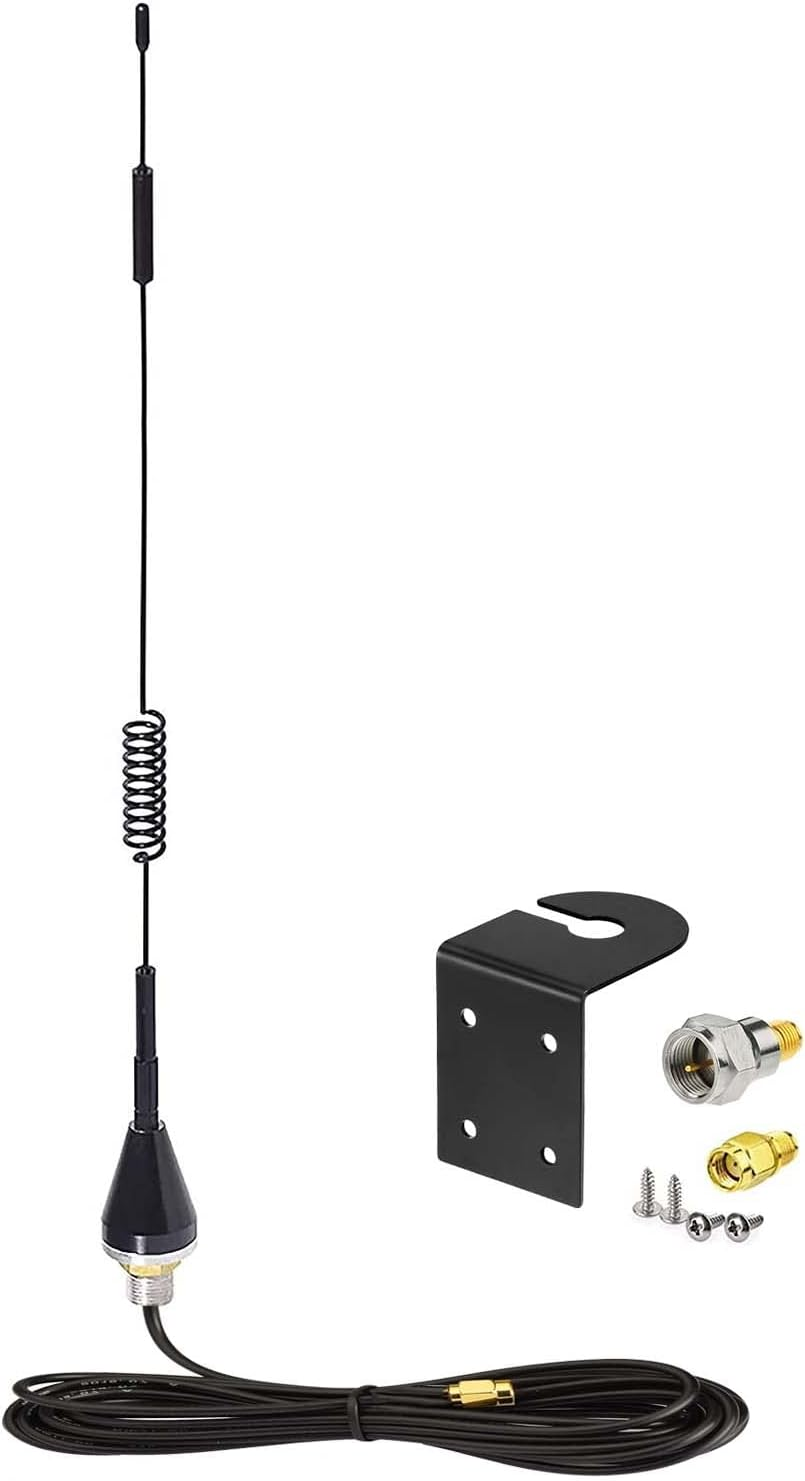

You can try this cheap range extender antenna for garage door openers:
It will give you some gain. If it isn't enough, you may have to go for a more expensive model like this one:
In both cases, you'll have to cut the cable and solder the center connector to the transmitter circuit board.
If these don't do it, you may have to put this one on the receiver:
Good Luck!

I have the same system, no issues. But if I were you, I'd probably try replacing the antenna on the receiver. Because you say you are getting alerts, the signal does make it, just not consistent. But that's just thinking out loud...
   / Help extending the range of my Dakota Alert System #10
Would you recommend trying on the receiver first since it seems to have the smaller antenna of the two?
Yes, if it's easier and you don't mind spending a few extra $$.
That antenna is a Yagi design and is highly directional. It may take some time to get it aimed correctly.
