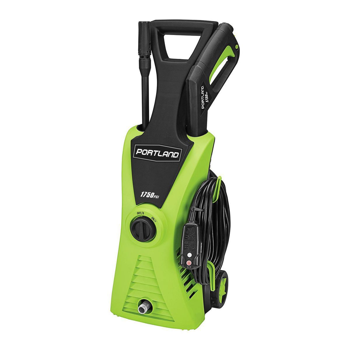

The issue is, a one horse electric motor won't give you much in the way of pressure or water flow. In my opinion, you need at least 5 horsepower minimum to do any real cleaning of anything and flow rate is important too. Why I won't buy a 110 volt washer like was pictured in a previous post. They might make the pressure but the flow is minimal and you need both pressure (at least 1200-1500 psi at the nozzle plus adequate flow which 'washes' the crud off efficiently. The 110 volt washers are not really capable of doing real work like cleaning farm equipment or blasting off concrete crud or cleaning decks. They will work but slowly.

There is nothing wrong with using an electric motor. The high pressure pump is what costs the most money. Pay attention to volume (flow rate), operating pressure AND duty cycle. The better the numbers the more you have to pay. Don't ignore the flow rate.
Single phase 120VAC will be less efficient I'd go 240VAC minimum on single phase.
