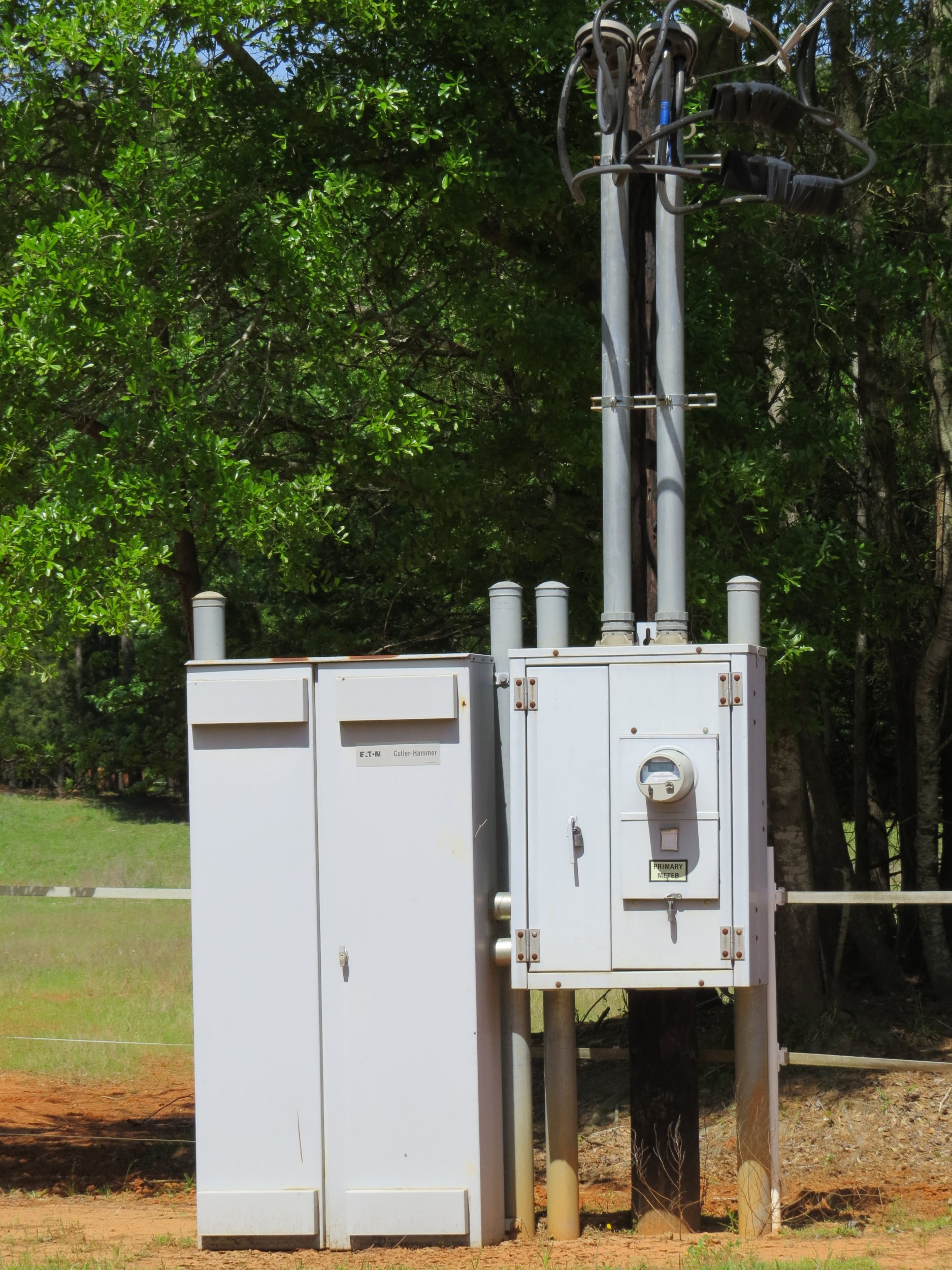

When I brought power into my land, I wanted enough power for two houses and a big workshop. The guy I spoke to from the power company told me that the cost was the same for 600 amps, up to 1,200 amps. In my mind, I figured it was a no brainer to have as much power available as possible. There are six 200 amp breakers inside the box. I'm using three of them so far. I have three that are empty. My current plan/thinking is to use one for my pump and gazebo. One for my barn that is currently powered from my house, but I'll disconnect that when I add on to my barn and have it's own breaker. And then another will be for my workshop, that may or may not happen.

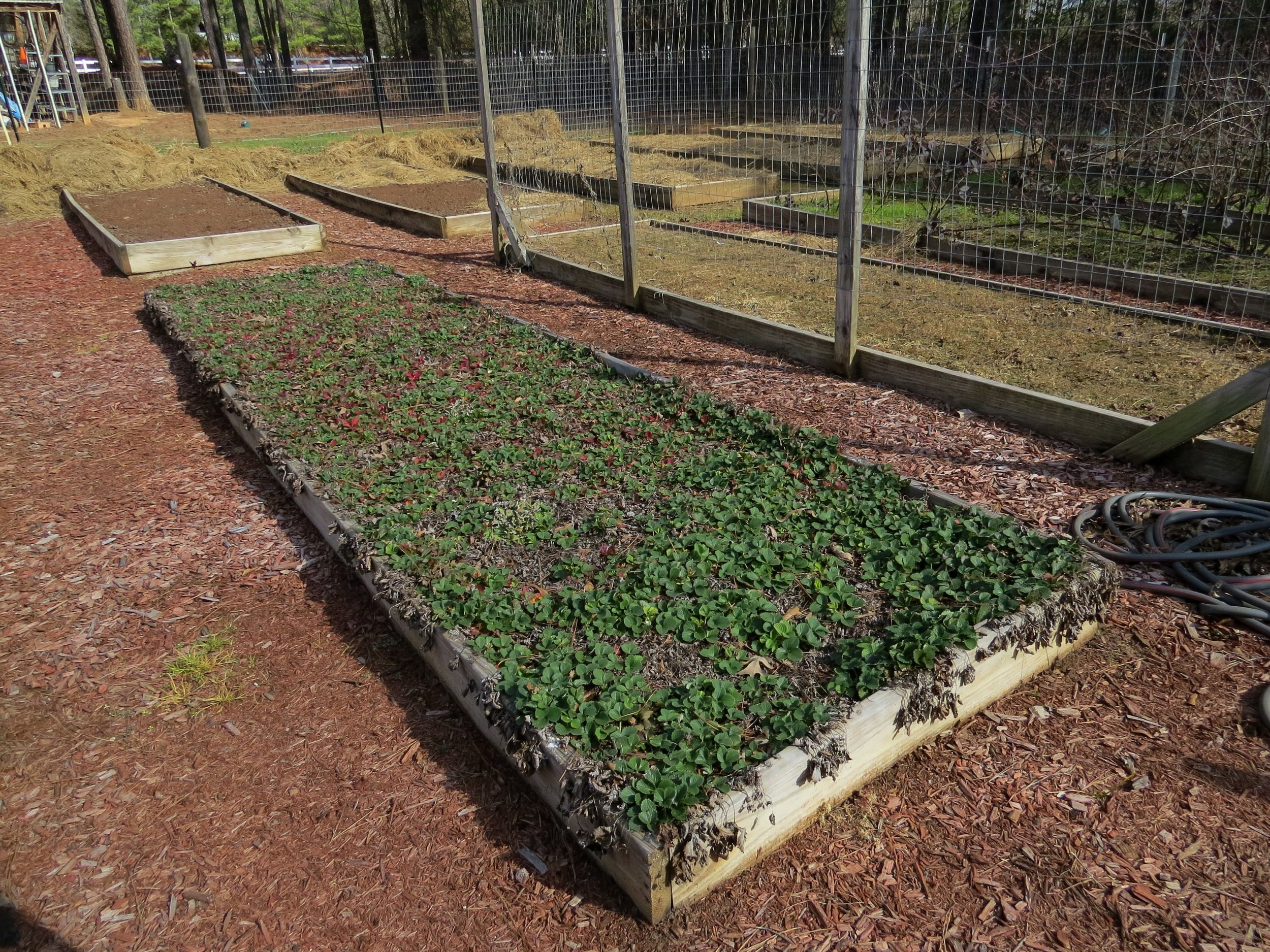

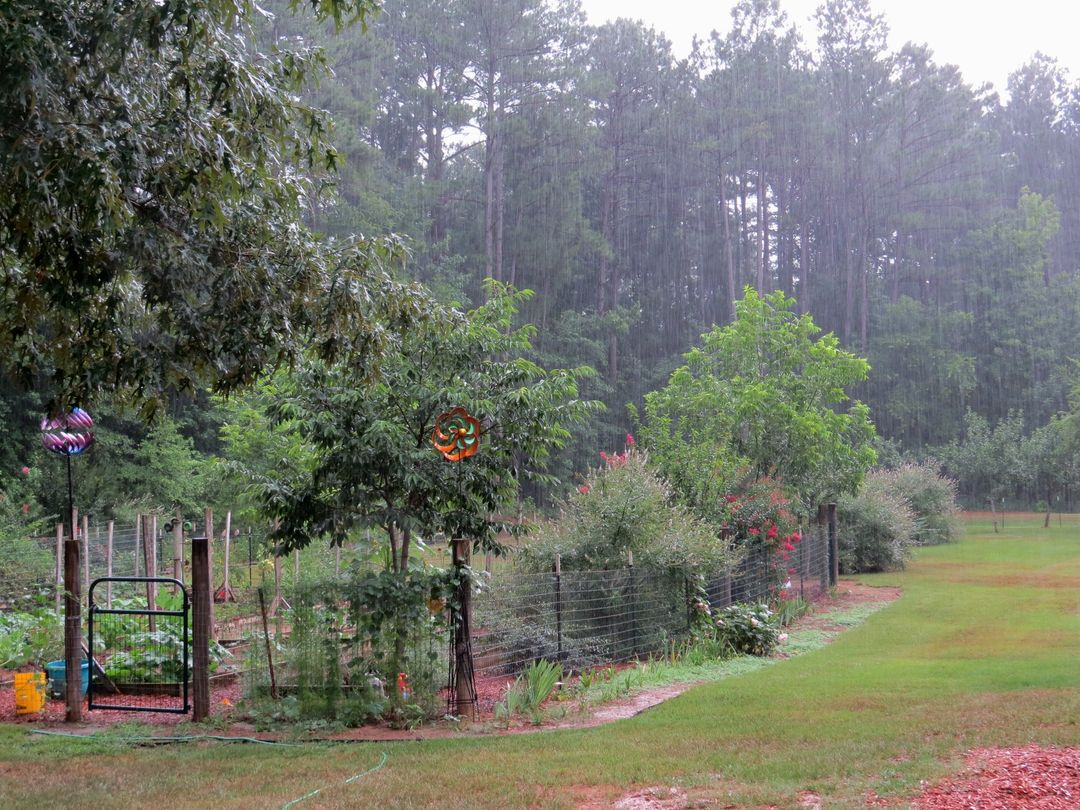

The gardens are always growing. My wife is crazy about her plants!!! Here are a few pictures of what I'm dealing with. Seems that I only take pictures when it's raining!!!
For the last couple of weeks, my wife has been rescuing hundreds of potted plants from a nursery that has decided that they cannot take care of them anymore. Hundreds of the plants have already died from lack of water, but she's managed to fill up her mini van five times with layers of potted plants that she thinks she can save. There are hundreds more that she is trying to get, but they are over an hour away and the summer heat/humidity has limited what she can get done.
