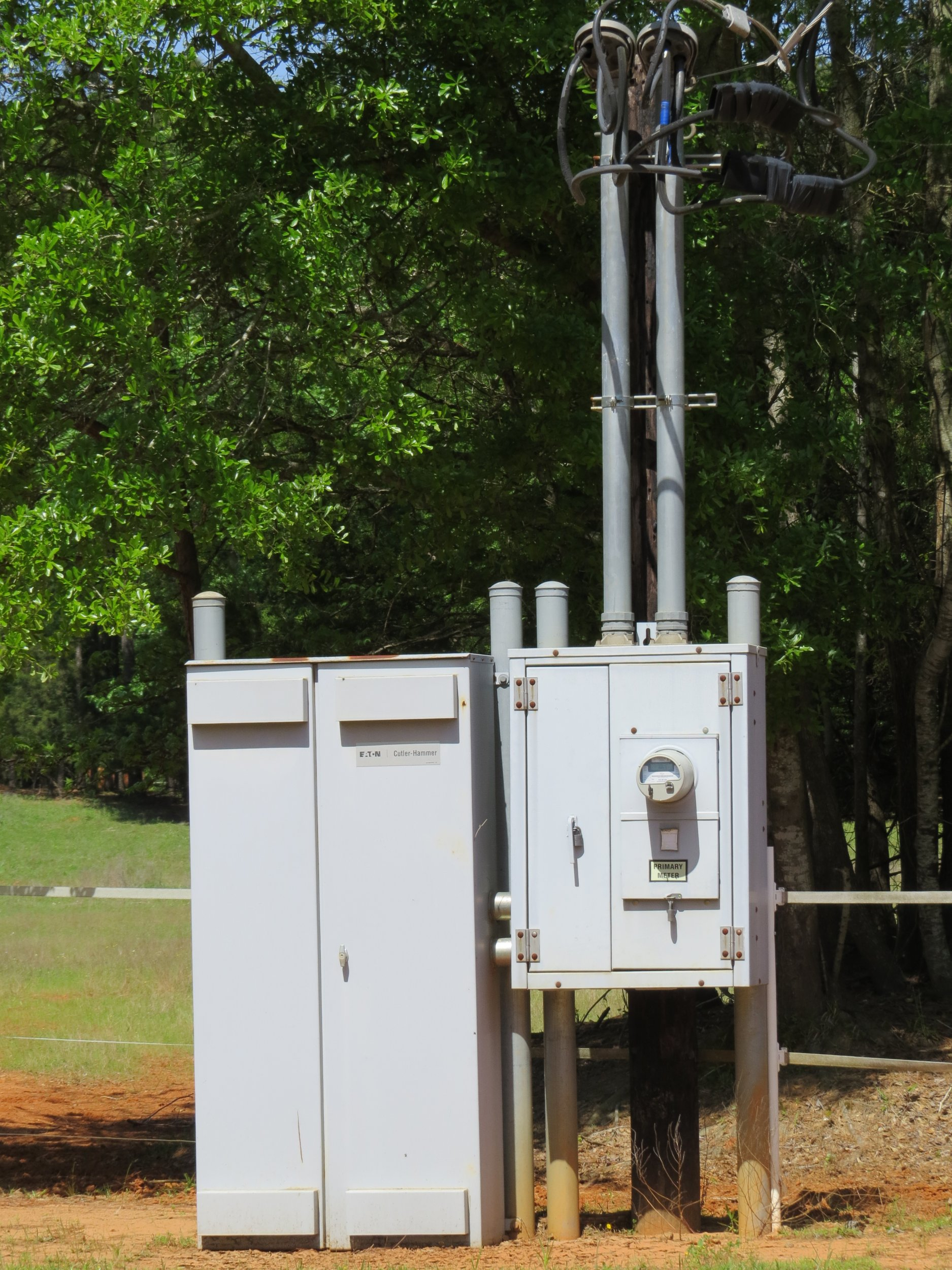

Thank you for the link. If I understand it correctly, I have 200 amps and 240 volts at the breaker at my meter. If I use 2AWG Aluminum for 1,000 feet, I'll have 75 amps at the end of the run and a 14.7% voltage drop, or about 36 volts. That leaves me with 204 volts, which isn't enough.

The voltage drop for #2 aluminum wire at 900' and 12 amps is 17.3 volts which is 2.9% loss. This is considered acceptable because it is less than 3%, but is very close to your limit. If you get a pump that draws 30 amps you'll be way over what is considered acceptable voltage drop. I realize that conduit is expensive, but I recommend that you use it and put underground cable inside it (not above ground cable). (The conduit will collect water!). And it should be 2' down.
Instead of buying from Lowe's you may have to go to the electrical wholesalers that the electricians use. They are more expensive, but will have larger wire.
If you use aluminum wire, the terminals it is connected to have to be rated for aluminum wire and an anti-oxidation paste needs to be used. The problem with aluminum wire is that it expands and contracts more than copper when it is heated which causes the connection to loosen which causes more heating, thus the reason to be sure the terminals are rated for aluminum.
Thank you. This is something that needs to work for decades, so I'm willing to spend what it takes to do it right. The aluminum was my starting point in figuring this out. If you needed 220 volts and 30 amps 100 feet away, what would you use?
I own a trencher and a backhoe, so putting the wire in the ground isn't a problem. I'm unsure what the advantage is to using conduit? My soil is hard packed red clay. There are no gophers or moles here.
