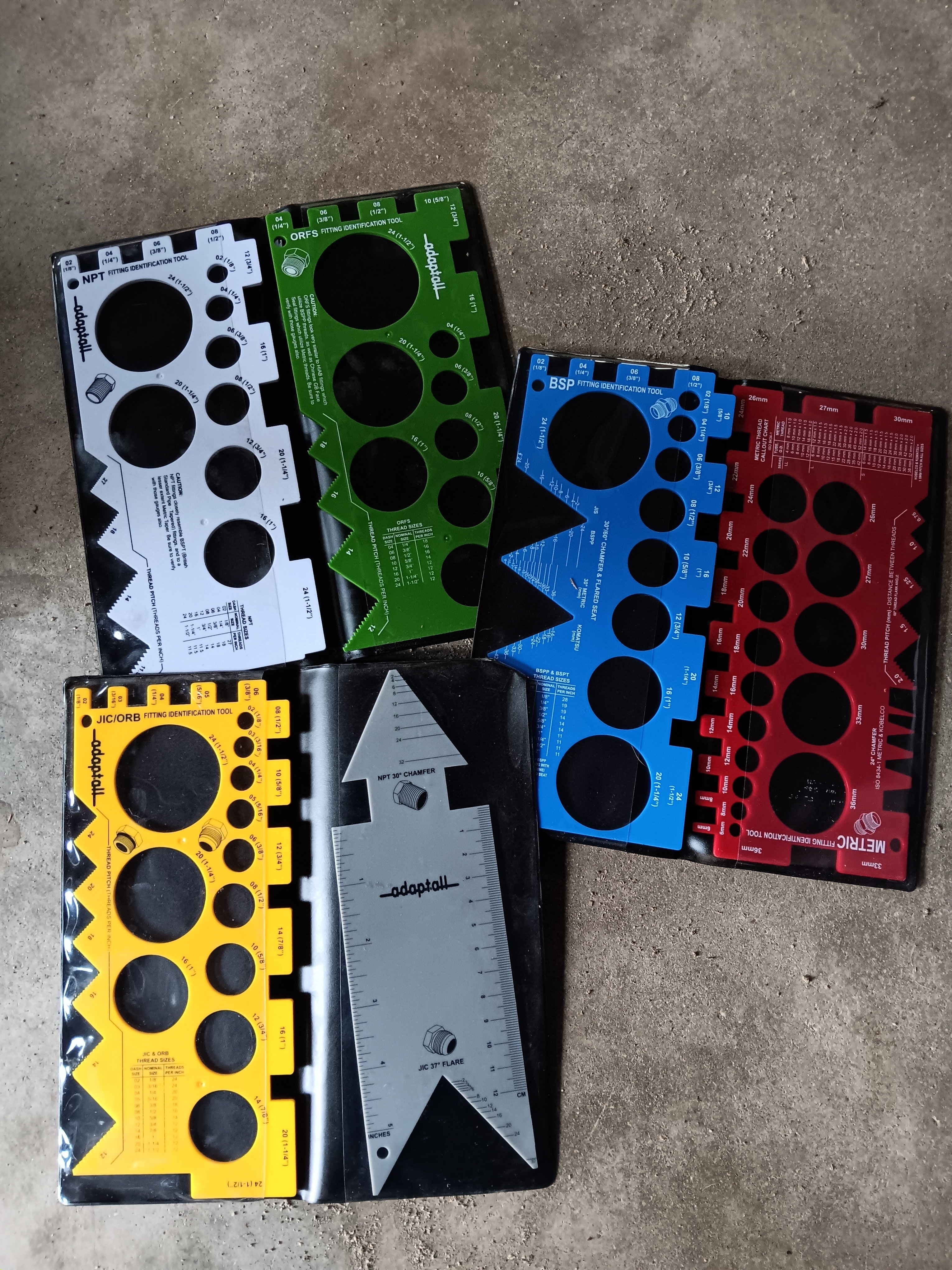

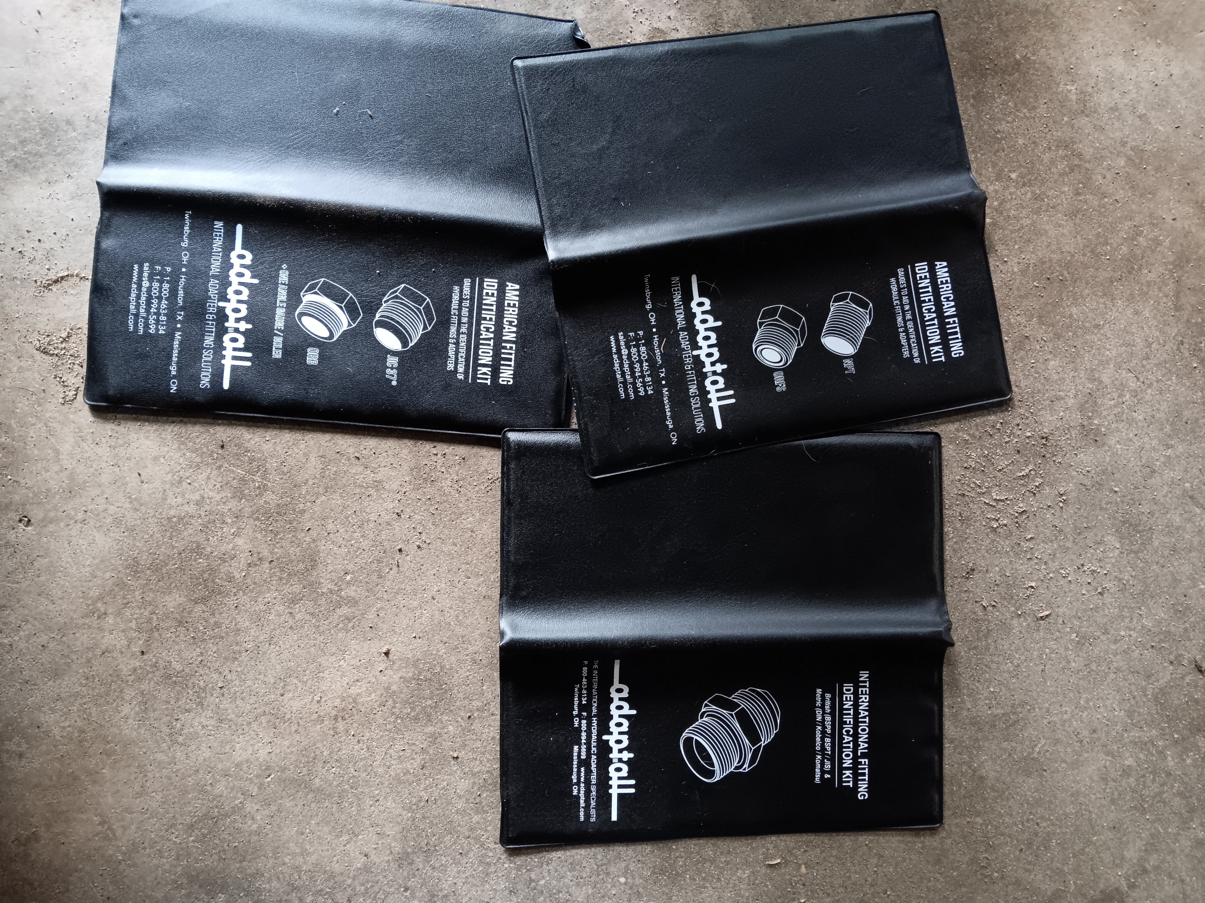

   / Help finding front axel steering hoses #4
Expensive, but seek out a "Parker store" I seriously doubt that Kioti manufacturers an exclusive to them fitting end.
For that matter, take it back to you hose guy and ask him to identify it. That's 3/4 of the battle, you can proceed from there on the phone.👍
Those 3 little vinyl cases cost me close to $100 iirc but once having them... priceless!
