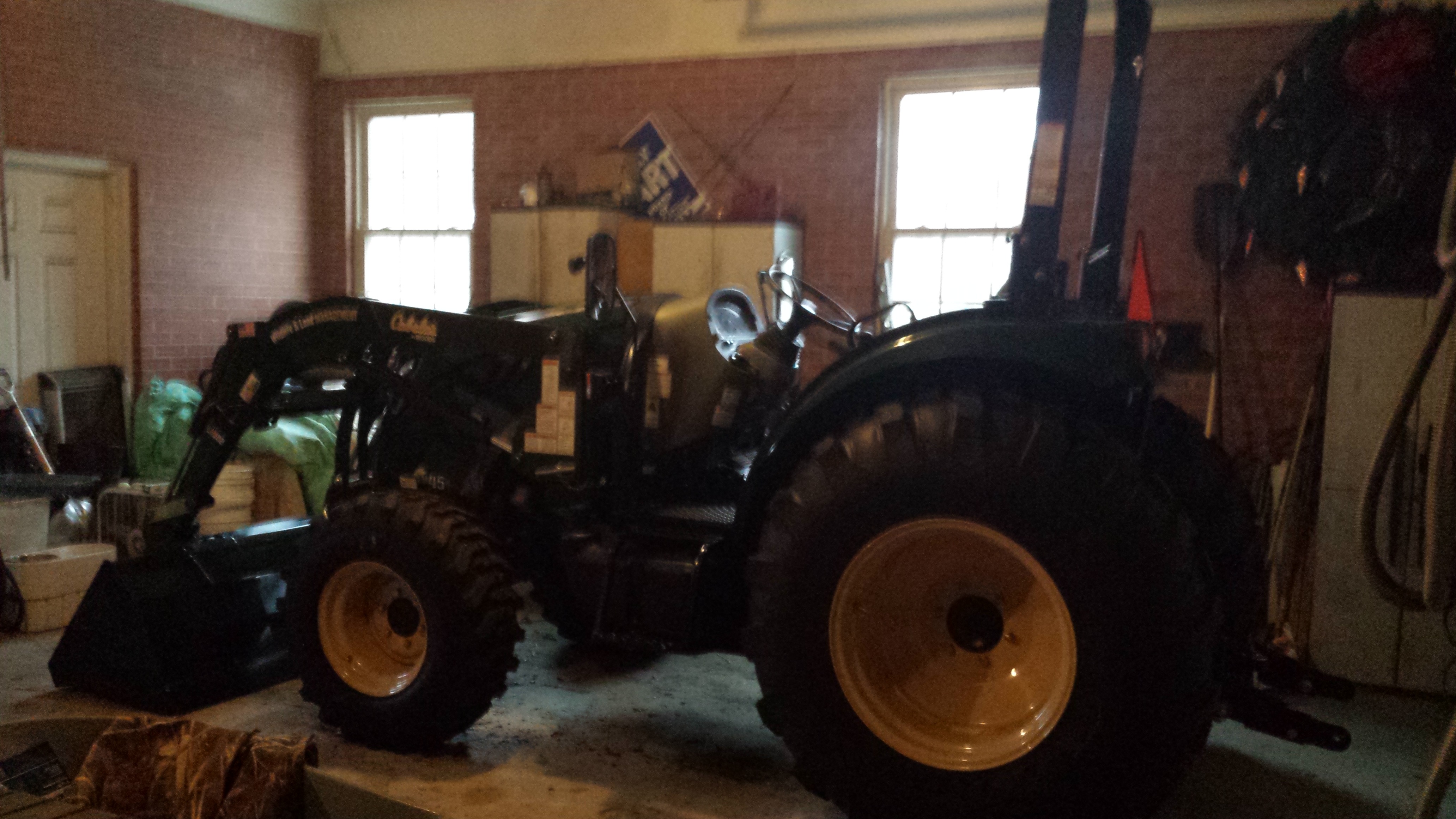

Tractor.jpgTalked to the mechanic when I picked up the tractor. He's old school like me. "Turn up the pump and roll coal". :) He said it would not trough any codes if I took the filter out of the DPF canister. He also has the scan tool and can reset the computer at any time. Nice guy, I hope he works for Cabela's for a long time.
   / Help fllocating brand new Cabela's tractors still in stock. #39
View attachment 494161Talked to the mechanic when I picked up the tractor. He's old school like me. "Turn up the pump and roll coal". :) He said it would not trough any codes if I took the filter out of the DPF canister. He also has the scan tool and can reset the computer at any time. Nice guy, I hope he works for Cabela's for a long time.
Does it have an oxygen sensor downstream of the DPF?
If it does it will probably throw a code.
   / Help fllocating brand new Cabela's tractors still in stock. #40
Has two sensors. I think they monitor flow. Was told I could deny request to run regen cycle as many times as I like, but the end result is that the DPF would stop up at some point. How many hours I don't know. I use a tractor a lot in the winter running a 3 point log splitter pto pump at around 1k rpm. Tractor won't like that. The benefits of removing the filter outway any problems it may cause. If I have too I will just buy a scan tool for it down the road.
