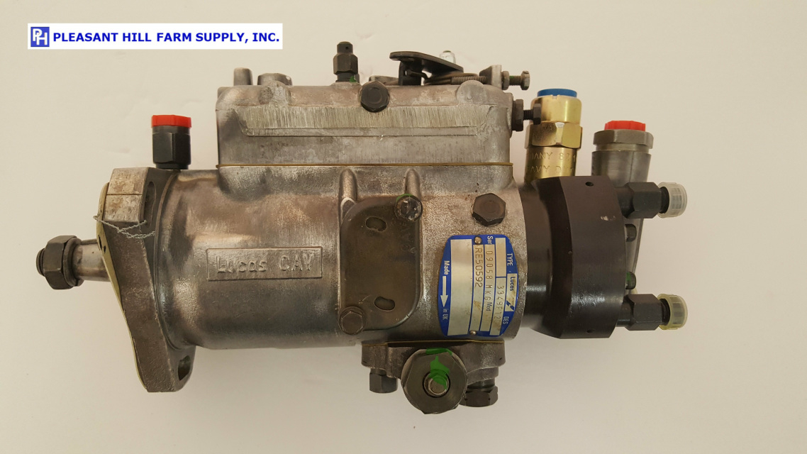

This is the list of fuel system correction I've done so far:
1. Drained old diesel fuel from tank and replaced with fresh fuel.
2. Replaced Fuel Filter, fuel supply line, and fuel return lines.
3. Replaced in-tank fuel transfer pump/sending unit.
Here's where I'm at in bleeding fuel system"
1. Opened bleed screw at filter, turned on ignition, and waited till fuel exited bleed screw. Tightened screw.
2. Opened Fuel Supply Line at injection pump and turned on ignition and let fuel bleed from supply line at injection pump.
3. I verified I have 12V at the Fuel Shutoff Solenoid on the Fuel Injection Pump. I put a magnetic compass next to fuel Shutoff Solenoid and observed compass needle move after turning on ignition. I was going to take off Fuel Shutoff Solenoid to clean and verify operation, but getting if off the injection pump would be very difficult without taking off the fuel Supply line.
Anyway, I opened the line at the first injector and cranked the engine several times. Each time I looked at the line and did not see any fuel coming out of by the injector. How many times should I do this? I suspect that my fuel pump is gummed up.
Here's a picture what my Fuel Injector Pump looks like. It's a Lucas and I believe I have a mechanical Fuel Injector pump system. I took pics of the injector pump but they didn't turn out. I grabbed this pic from the Internet that resembles my pump.
Looking for recommendations, opinions on what my next steps should be. Thanks for the help!

I loosened all the injectors. Set the throttle to full and cranked it 5 times for about 20 seconds each time. No fuel at injector.
Removed fuel shutoff solenoid. Cleaned it, and verified it works correctly by jumping it to solenoid hot wire.
Any ideas? I'll research to see if this injection pump has a bleeder valve. I'll try that next if it does.

If your not getting fuel out by now.. STOP..
U can lift the top cover and try to free the metering valve.. if THATS free..the pumping plungers are stuck & they’re deep in the pump..
   / Help Getting JD 6400 Started In Cold Weather After Sitting for 5 years #27
If it sat for 5 years, I think ur pizzin in the wind..
I don’t mind helping, if u don’t mind put’n in the time.
Just do a Google search for CAV DPA.. there should be a few videos of top cover removal..
U really don’t have to take it off.. just familiarize yourself w the mv..

Reading the pump tag, it says model 25045DMG.

That # is the pump serial number..
The pump # will be something like: 3242F150
