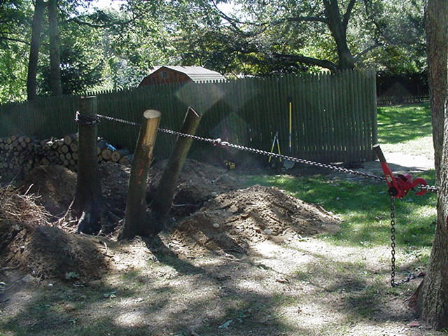

Hello Jim,
I removed a few stumps on Long Island I used a 3 ton lever chain fall.What I did was to dig around the stump with the BX22 backhoe then put the chain fall on them. once they're loose I roll them out of the hole with the hoe.The trick is to leave about six feet of trunk so you have leverage. Once you have them out of the hole cut the trunks off and roll them with the bucket loader

I had thought about a come along with mine, but I like the chain hoist alot more. I started looking around for chain hoists, and it seems like I can get a five ton hoist and about 100 ft of grade 43 chain for around $450. I got an estimate today to have two trees removed and seven stumps ground for $750. It's probably a decent price, but I think I'm going to go with buying a couple large chain hoists and some chain, and pull the trees over myself. How much did the three ton chain hoist strain to pull the stump over?
   / Help -Has anyone just burned tree stumps - BX23 #18
Let me say this,Its not easy the 3 ton chain fall will pull them but it takes time .
I try to hook up in one direction and put a good strain on them.When it starts to roll over I change directions and pull from the opposite side eventually they get loose and fall over.
You need lots of patience.Large stumps are not easy to remove. I think Junkman has the right idea ,cut them low and let them rot.
