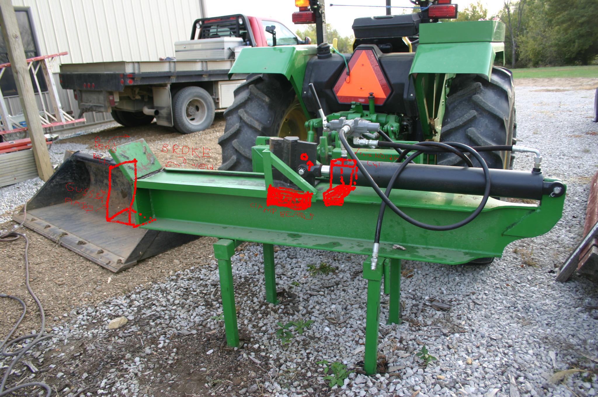

A friend & I enbarked on making out own log splitter, that hooks to my John Deere 5103 tractor. First afternoon of splitting logs shows up somethings wrong in our design. it peeled back the push against plate (1" plate steel) and cupped up the knife blade plate. see attatched pic. I was trying to split some smaller hedge (12" diam?) and frozen oak with it. I am exploring with SpeeCo on the valve if there is a adjustment to turn down its power a bit. All the 30ton log splitters we saw at stores had less bottom plate sizes.
Can someone provide thier expertise on what i need to do when rewelding and redesigning? The wood wanted to push up at the first and got worse of course as things got bent more. Whats the optimum hieght of the pin hole on the knife blade slide? So the cylinder pushes a little below horizontal into ibeam? a little above? or perfectly parrallel?
Please respond with advise :confused:

!st I got to say it's sure is a nice looking splitter. I would pull the end plate back and leaning a little fwd. Then look at your trucks pocket stack brackets. Plus one in middle, that should fix that.
The other end I would make it so the wedge is more in front of the bottom plate and sharp. The bottom plate would be thicker and more on the back side so it has a bigger shoe when you pull back. Your angle iron might have to be thicker also. You might want to change that to arms holding under the I beam and forget the angle iron, they look like all kinds of stuff is going to get in them. If you do use the arms under the I beam, make sure you use bolt to hold them on. Welding alone well not hold

That looks like a 1" plate at the back, made from two pieces, cracked on the weld.
I'd say notch it to get a full penetrating weld, turn the splitter after each bead so you only weld under hand, and turn the amps of the welder high up, especially with the first 3 beads. When its totally hot, you can lower the amps on the welder (or feed more wire) to get an equally melt.
Then a 3" plate perpendicular on the back of this plate, with good sized welds, to support it at the back. That should do the job.

The base plate on the wedge bending up is caused by not having the rod of the hydraulic cylinder in the middle. If it isn't in the middle the base plate has to be much stouter.
I have a splitter that I made a new taller splitter wedge for...had the same problem with the base plate bending.
The original 8" high wedge never bent the base plate, the 12" I made with the pushpoint at the same height, bent the same size base plate as the original. Lesson learned.

I've bent a few my self and learned along the way...What I'd do is bend the 1" base plate back ( using the splitter to pull it ). If it does'nt sit right cut it off prep it and re -weld it ( it looks like it folded at the weld ?) then put 2-3 gusset vertical plates 3/8" or larger welded to the 1" plate and then cap it with another plate to the 1" plate
Then at the cylinder about where the rod comes out of the bore I'd build a strap/clamp frame to keep the cylinder from bowing under stress.I'd also raise both pin locations if posible but definatly keep the cylinder parallel with the beam.
I agree with the other posters ...the angle along the beam will hold debris and will be a PITA. I'd make the wedge carrige clamp around the beam out of at least 1/2" plate.
babzog as the right Idea with the pivot deal ..if your keeping the wedge/baseplate where they are, now would be the time to put the pivot in ..saves alot in labor/back pain

Hey everyone, thanks for all the great input.
First of all... it does pivot up. If you look closely you'll see the release pin on the right side of the stand
There is a frame made for the cat 3 quick hitch and it pivots on it... just back up, hook up, pick up and go
the responses gives me these areas i will redo:
A - prefabricate the wedge with a I beam wedge carriage plate to clamp around Ibeam & remove angle iron slides
B - use 1/2" plate steel on wedge carriage plate
C - make the wedge stick out in front of wedge carriage plate 1/2"
D - relocate wedge push point pin hole for ram to be the center of total height of wedge (right now its about 1/3 up from carriage plate)
E - after bending 1" base plate back into place & reweld, add three rows of 3"x3/4" gussets to bottom of base plate
F - Have SpeeCo help me adjust the valves preset psi relief down abit
Question: using the ibeam clamp around type of wedge carriage plate, how can i incorporate the log stop for pulling the wedge back out of the log?

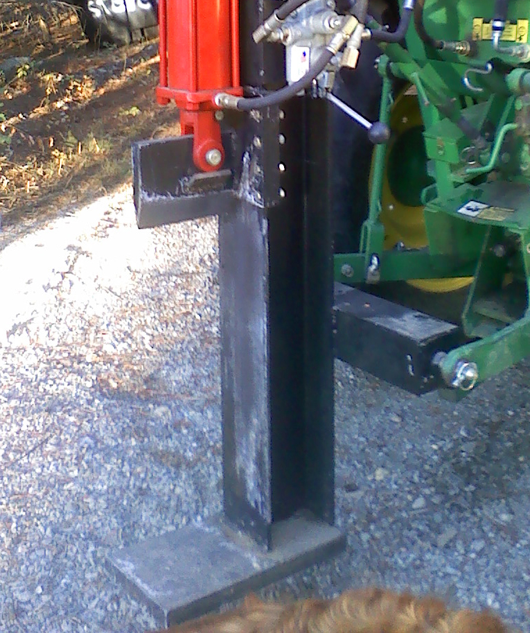

I cant tell by the pictures whether or not your base plate is welded at the brake joint or runs as a complete piece. You need a full length push plate . Mine is 1-1/2" solid plate steel. Been used for 5-6 years no issues. If your was a complete 1 piece plate,then i guess youll just have to beef it up.

The base plate was solid 1" plate steel in one 10" x 18" piece butt welded to the end of the 10x10 ibeam. Then a 1/2" plate was welded on top of the exposed base that had the ridging for holding a log into place. It was simply bent back, breaking the part of the weld at the point of bend
The ram is a 30ton ram, the valve has a 3400 psi blowoff. SpeeCo said most of their log splitters have the 2400 psi blowoff valve, only their very largest have the 3400 psi blowoff.
so they showed me how i could reduce that by a bit with adjustment on the side.
Im wondering what size everyone else is having success with on thier valve controls?
