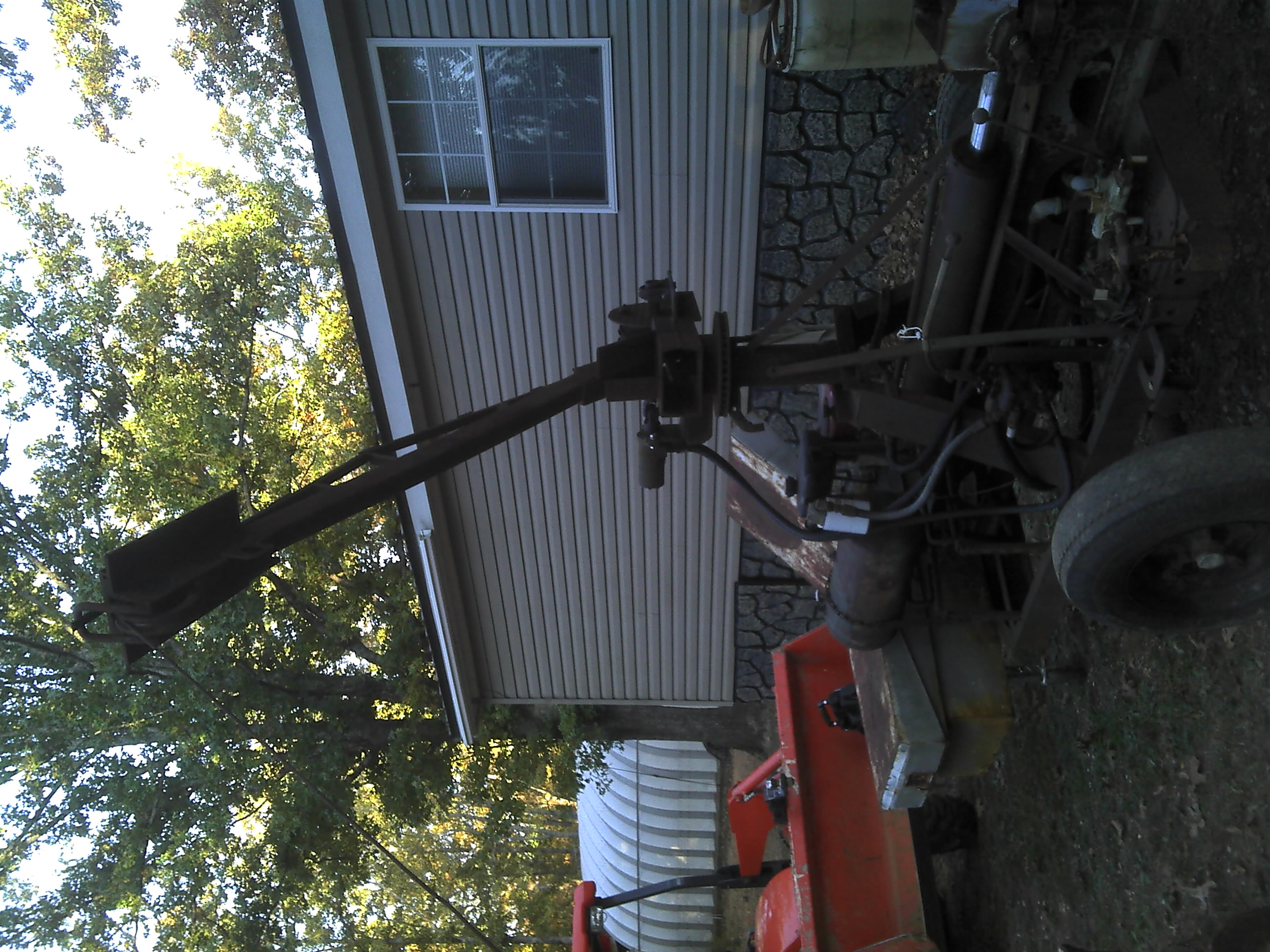

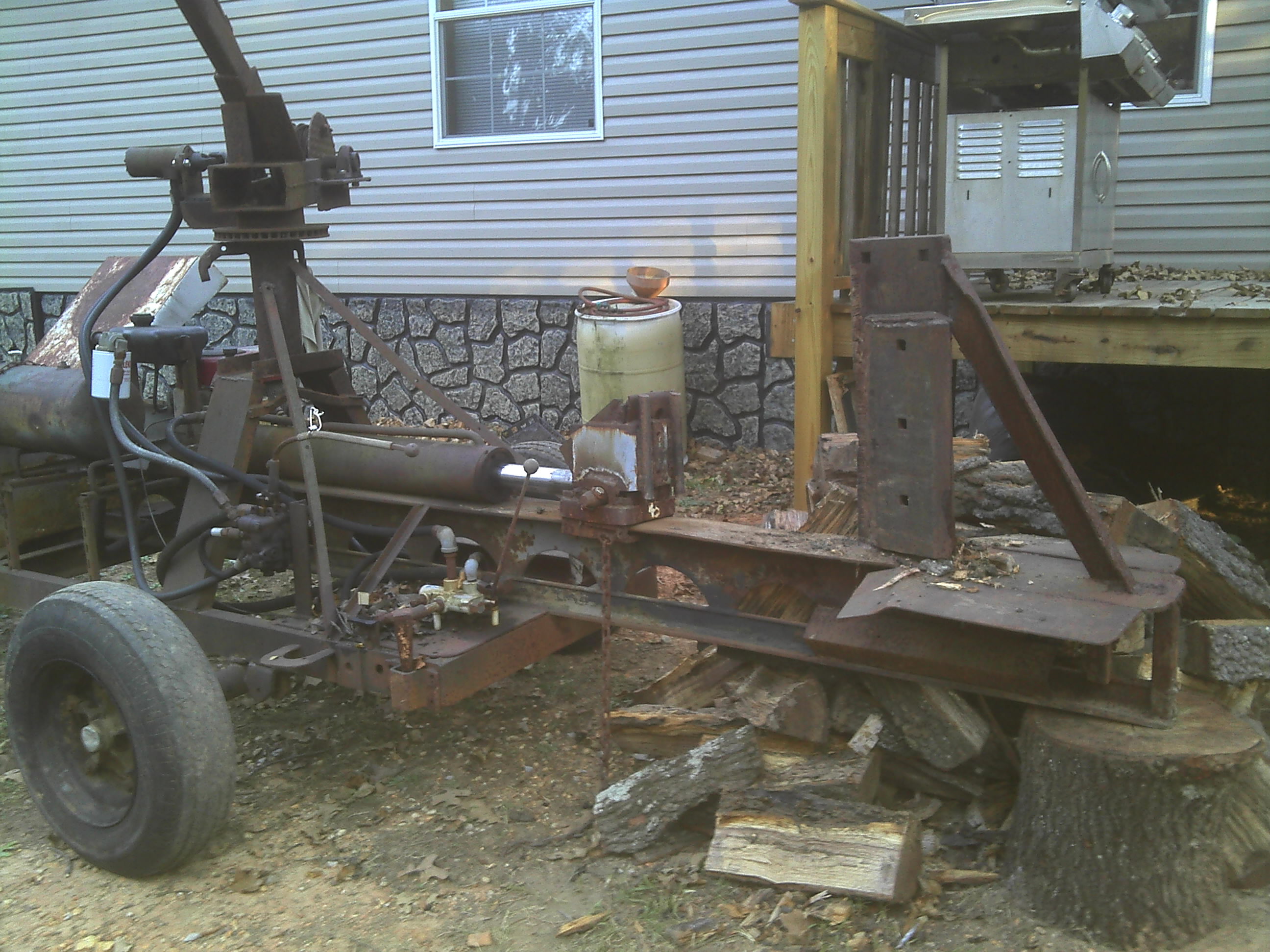

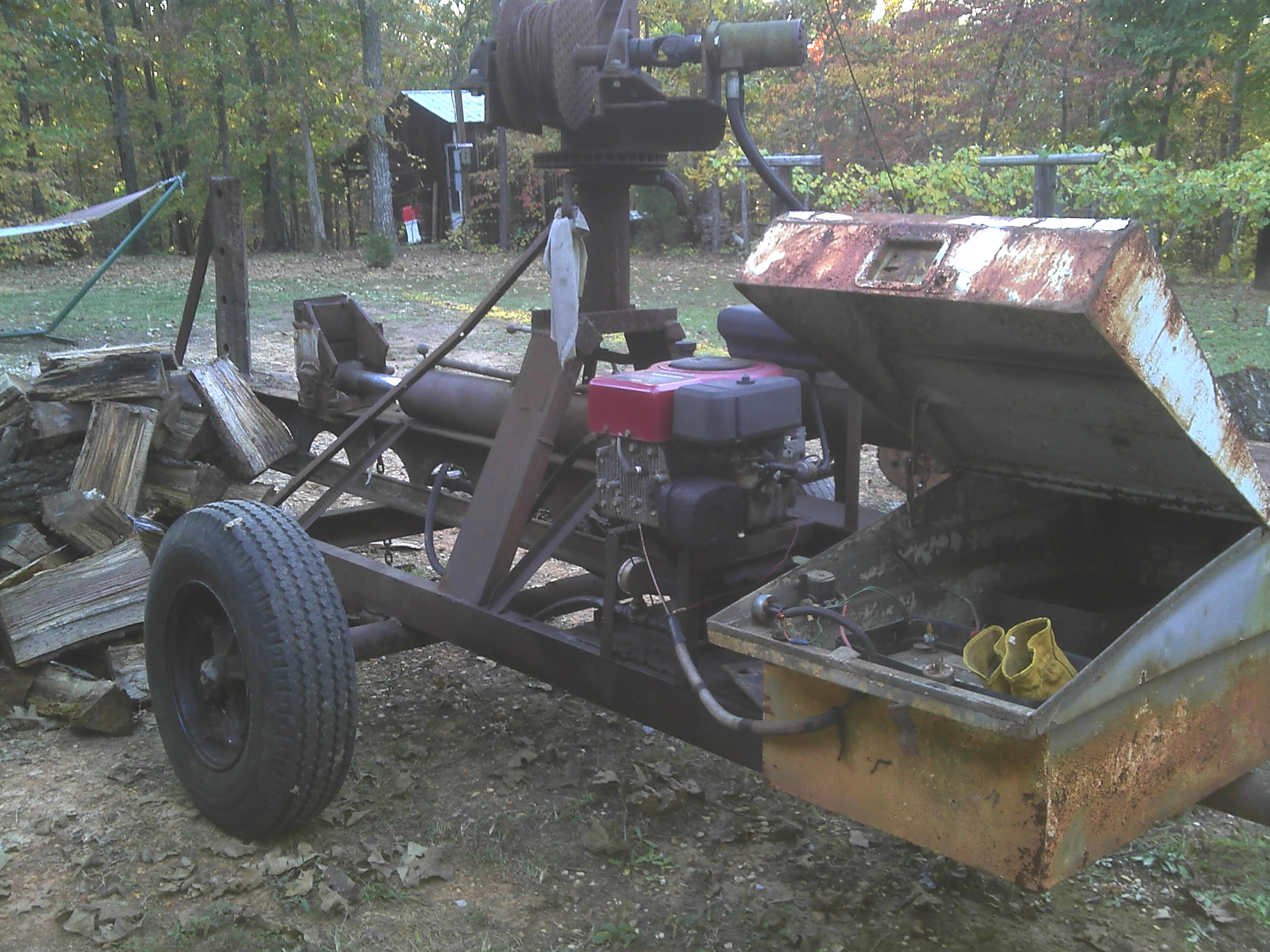

After seeing all these fine looking machines I probably should not show mine it is about 25 years old and been through alot. oh well here it is any way.
Looks like a great splitter to me!!!! Best part is the hammock is nearby for a much needed break!!!! :thumbsup:
   / Help! homebuilt log splitter #25
I will add this, your wedge needs to have a MUCH sharper angle on the cutting edge.
